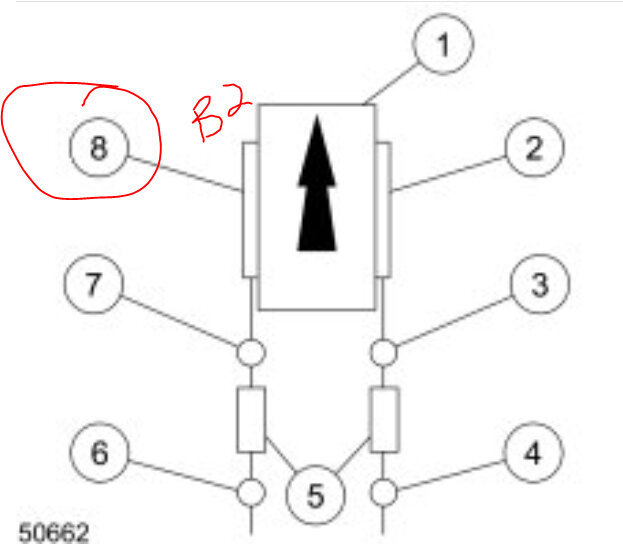

As far as replacing it again, I would do some checking first. First, make sure you have the correct side for bank 2. See pic 1 below.

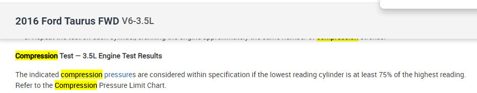

  • 110,248 POSTS
There doesn't need to be a large leak. Usually, if there is 25% or more difference between the highest and lowest cylinders, you will at least feel a rough idle. Usually, if it exceeds that, you will get a misfire.
