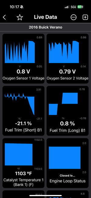

I'm finding myself in a pickle and would appreciate advice. I drive the vehicle listed above with less than 100,000 miles. And recently I got the dreaded p0420 code. Granted this isn't the first time. The first time was appx 2 years ago, with 20kish less miles.
Spark plugs were shot, replaced them, threw in some cataclean, and used a bottle of CRC GDI Intake Cleaner, and we were good. Light went off for two years. I've changed spark plugs one more time since then, especially because I put flex fuel into her a few times thinking she was a flex fuel vehicle (oops)
But it's been years since that has happened.
Anyhow, this time around I've tried everything. New air filter, crc, cataclean x2, flooring it, long highway drives, premium fuel, everything short of replacing actual parts. The spark plugs are fine, but they are far more black than they should be with how old they are. Any suggestions? I'll leave a photo of some live feed data. Please tell me it's not the cat (I live in California and there are no approved aftermarkets I can find, aka need a $3000 cat). Please help.

Here is one pic of live feed data, idk why it didn't attach earlier!

Also forgot to mention my car is originally CARB compliant so if it is the cat, I would need to replace through Buick and dear god I might as well buy a new car? And also, the fixd data for the sensors is 1/2 being upstream/downstream. Idk why they did it like that.

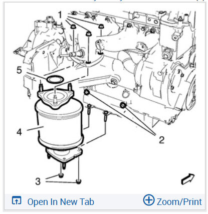

The car seems like it is running rich, this is why the Short trim is -21 which means the cat can be broken down inside and lowering the engine vacuum, I would remove the cat for inspection and if it has fallen apart inside there is no fixing it. Here is a guide that goes over a rich fuel condition as well to help understand what's going on:

Can I confirm the engine is running okay? Check out the images (below). Please let us know what happens.

Here are the companies that make cheaper cats for it:
Brands: Walker, Eastern Catalytic, MagnaFlow and Bosal.
Here is one for $126.00 from Amazon:
https://amzn.to/4j0kvsN
Please upload pictures or videos in your response of any problems.
