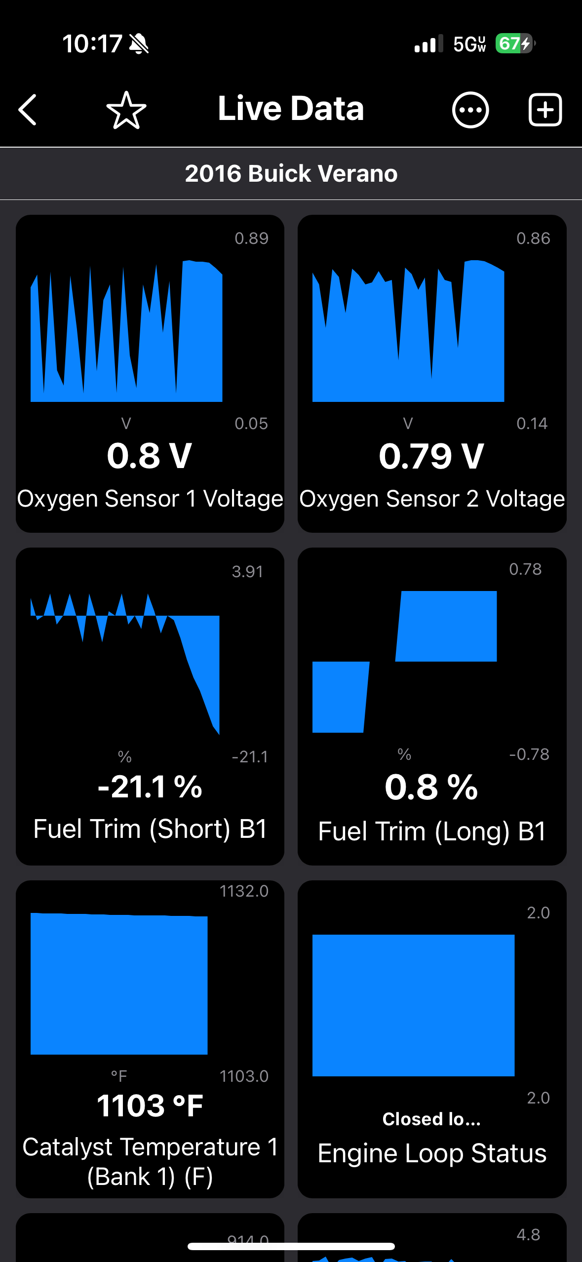

Anyhow, this time around I've tried everything. New air filter, crc, cataclean x2, flooring it, long highway drives, premium fuel, everything short of replacing actual parts. The spark plugs are fine, but they are far more black than they should be with how old they are. Any suggestions? I'll leave a photo of some live feed data. Please tell me it's not the cat (I live in California and there are no approved aftermarkets I can find, aka need a $3000 cat). Please help.

Here is one pic of live feed data, idk why it didn't attach earlier!

Also forgot to mention my car is originally CARB compliant so if it is the cat, I would need to replace through Buick and dear god I might as well buy a new car? And also, the fixd data for the sensors is 1/2 being upstream/downstream. Idk why they did it like that.

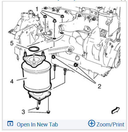

The car seems like it is running rich, this is why the Short trim is -21 which means the cat can be broken down inside and lowering the engine vacuum, I would remove the cat for inspection and if it has fallen apart inside there is no fixing it. Here is a guide that goes over a rich fuel condition as well to help understand what's going on:

Here are the companies that make cheaper cats for it:
Brands: Walker, Eastern Catalytic, MagnaFlow and Bosal.

Hi! So, the car actually runs a little rough. Always has. It gets better when I change the spark plugs, which is WAY too often for iridium (just learned that today), that pic in the first link with the black spark plugs is what they look like after 20-40K miles.... I wonder, could a bad PCV valve cause an engine to run rich? These vehicles are notorious for those going bad. And now I also have either leaking or burning oil, burning by the smell of it. So many issues I'm finding that all seemed to be caused by one thing

That looks like the crankcase ventilation system might not be working from what I could see. Thanks for the video. It seems like the catalytic converter needs to be checked, if it is partially clogged it will make the engine run rich.
