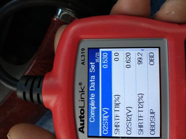

My car has been running well no hesitation or anything but recently the check engine light came on and showed p0420 Catalyst System Efficiency Below Threshold bank 2. I checked live data while idle. the bank 1 o2 sensor fluctuates between .1 and .7 and bank 2 fluctuates between .08 to .720 even tho it stays towards the higher end.

The converter is the likely cause. The sensor could have an issue, but I suspect it's acting that way because of the converter. If the sensor was an issue, I feel you would have gotten a different code.
I have to be honest, anytime I've seen a P0420, it was the converter. I can't guarantee it, but that is what I'm thinking.

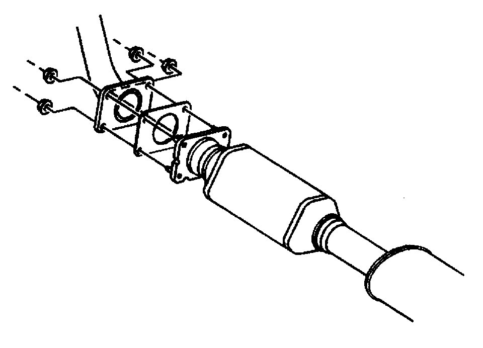

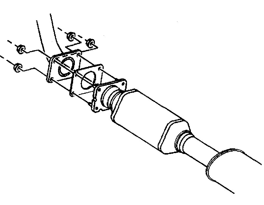

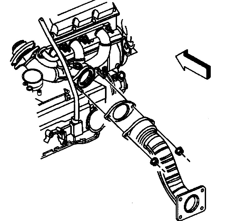

Here are directions for the replacement specific to your vehicle. The pics below correlate with the directions.
______________________________________________
2002 Buick Park Avenue V6-3.8L VIN K
Exhaust Manifold Pipe Replacement
Vehicle Engine, Cooling and Exhaust Exhaust System Exhaust Pipe Service and Repair Removal and Replacement Exhaust Manifold Pipe Replacement
EXHAUST MANIFOLD PIPE REPLACEMENT
Removal Procedure
Caution: Refer to Exhaust Service Caution in Service Precautions.
Caution: Refer to Protective Goggles and Gloves Caution in Service Precautions.
pic 1
1. Raise and support the vehicle.
2. Remove the four nuts securing the catalytic converter to the exhaust manifold pipe.
Notice: Refer to Flex Decoupler Notice in Service Precautions.
3. Position the exhaust system rearward, enough to allow the studs located in the front of the catalytic converter to clear the exhaust manifold pipe.
4. Remove the catalytic converter gasket. Do not reuse the gasket.
pic 2
5. Remove the two nuts attaching the exhaust manifold pipe to the right exhaust manifold.
6. Remove the exhaust manifold pipe and the gasket. Do not reuse the gasket.

pic 3
1. Place a NEW exhaust manifold pipe gasket over the right exhaust manifold studs.
2. Position the exhaust manifold pipe to the right exhaust manifold.
Notice: Refer to Fastener Notice in Service Precautions.
3. Install the two nuts attaching the exhaust manifold pipe to the right exhaust manifold.
^ Tighten the exhaust manifold pipe nuts to 40 Nm (30 ft. lbs.).

I just replaced the catalytic converter not to long ago. Maybe a year ago.
Mar 1, 2021 at 5:26 PM
  • 110,190 POSTS
Is that the only code present?
Mar 1, 2021 at 8:31 PM
MGSIL
  • 20 POSTS
Yes, before this one popped up there was a different code that popped up a couple of times p0171 but not anymore.
Mar 2, 2021 at 10:50 AM
  • 110,190 POSTS
The 171 sets when the PCM identifies the vehicle is running lean. The PCM then compensates by adding fuel to the air/fuel mixture. If that happened for an extended time due to a faulty injector or O2 sensor, it could have caused a converter issue. Was anything done to repair that issue?
