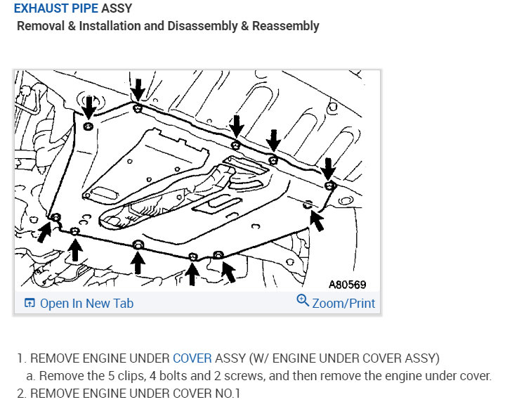

I have the check engine, VSC, and Trac Off lights on my instrument panel. When I have had it checked, I was told it was reading P0420 - catalytic converter issue.
I cannot afford to have it fixed yet and I have only been driving it around town. Is it safe to keep driving it around town? Could I drive it further? I just do not want to make it worse until I can have it fixed.
Thanks
Nov 28, 2018 at 10:07 AM
DANNY L
  • 5,648 POSTS
Hello, I am Danny,
I would not say it would do any damage however, you will notice possibly lack of performance and poor gas mileage. Get it fixed as soon as possible though. I have attached a tutorial for you to view. Hope this helps and thanks for using 2Carpros.
Danny-
Nov 28, 2018 at 10:44 AM
  • 55,399 POSTS

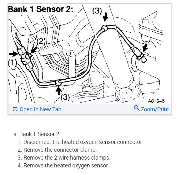

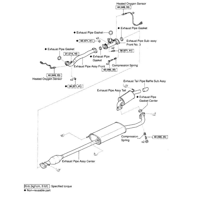

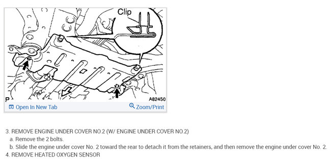

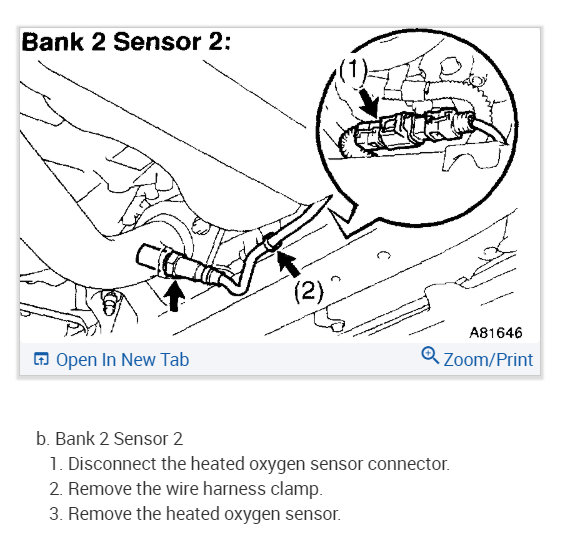

I agree with Danny it will not hurt the car. Here is a step by step guide on how to replace it with diagrams below to show you how on your car:
https://www.2carpros.com/articles/catalytic-converter-replacement
Check out the diagrams (below). Please let us know if you need anything else to get the problem fixed. Clear the codes once you are done.
