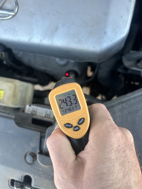

The check engine light came on in the VSC light started blinking. My scanner showed P0420 code relating to the catalytic converter. After doing a little research, I saw that it could be multiple different reasons, and may not actually be the catalytic converter failing. This is where I defer to your amazing mechanic expertise! How would you go about diagnosing the issue?

In most cases, a P0420 does indicate the converter is operating below threshold and needs to be replaced. There are different products that are available that are designed to clean and regenerate them, but they don't always work. From experience, Lucas has come out with a new product, and I have seen the best luck with it, but the directions need to be followed exactly.
As far as what you are dealing with, there are ways to determine if the converter is actually at fault. By using an infrared thermometer, you can check converter temps to determine if it is working. The temp should be hotter at the outlet.
Here is a link that explains how to check it. Take a look at this link and try it. If you have questions, please let us know.

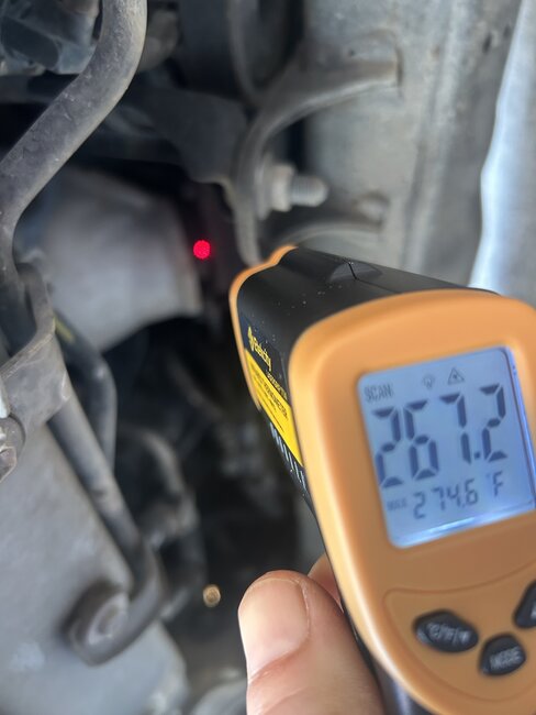

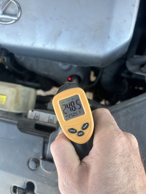

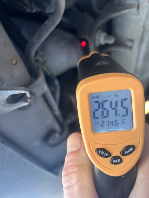

Hey Joe, here are my results. The temp would fluctuate at the inlet and outlet of the cat, both higher and lower than the temps i was able to capture. What do you think? Is it shot? Or do you think it’s still good? Thank you!
Jan 12, 2026 at 10:30 PM
  • 55,423 POSTS

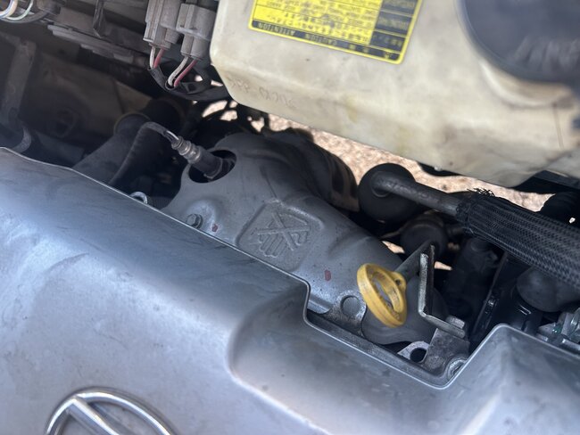

Yep, thanks for the images, that catalytic converter seems no good, I would remove the exhaust manifold and inspect the honey come inside. It is probably melted inside. Let us know, Ken

Hello, when I first made this post, I had cleared the code so that the check engine light isn’t on. It came on again yesterday and so I went to go clear it, and when I pulled up the code, it was P0420 of course but what I didn’t realize the first time is that it said bank one. The code said something like catalyst efficiency on Bank one below threshold. So I am writing to you guys to confirm that the rear side of the engine (2009 lexus rx350 v6) closest to the firewall is bank one, correct?
And if you scroll up in my previous messages, you’ll see that when I did the test on the catalytic converter at the front of the engine, that was bank two, correct?
Do you see where im getting at?
Jan 16, 2026 at 10:40 PM
  • 55,423 POSTS
Yep, I would check them both, but start with bank one which is near the fire wall.
