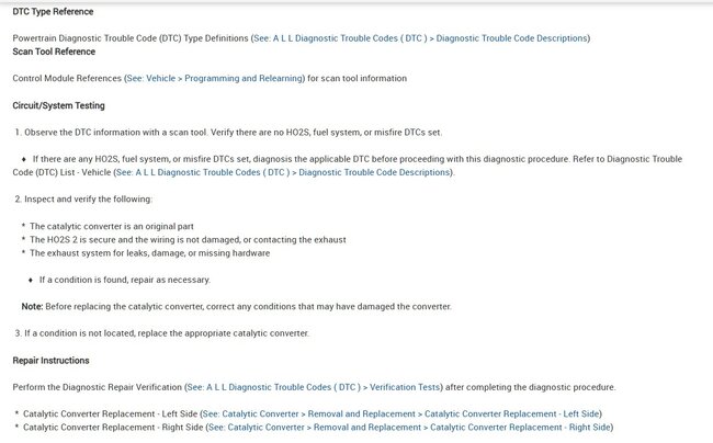

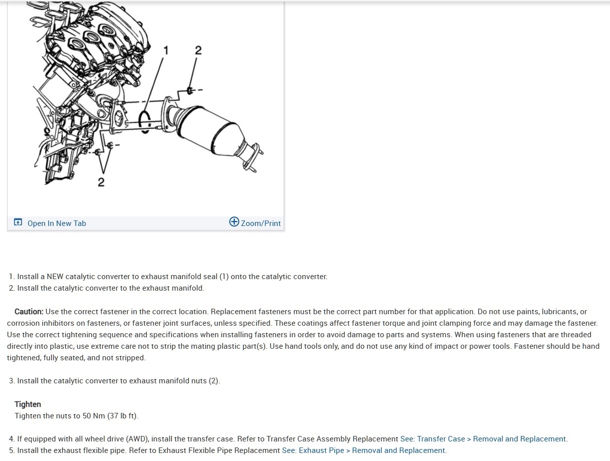

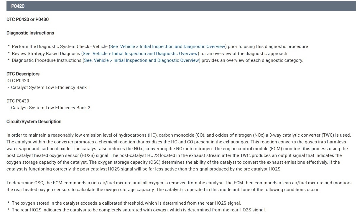

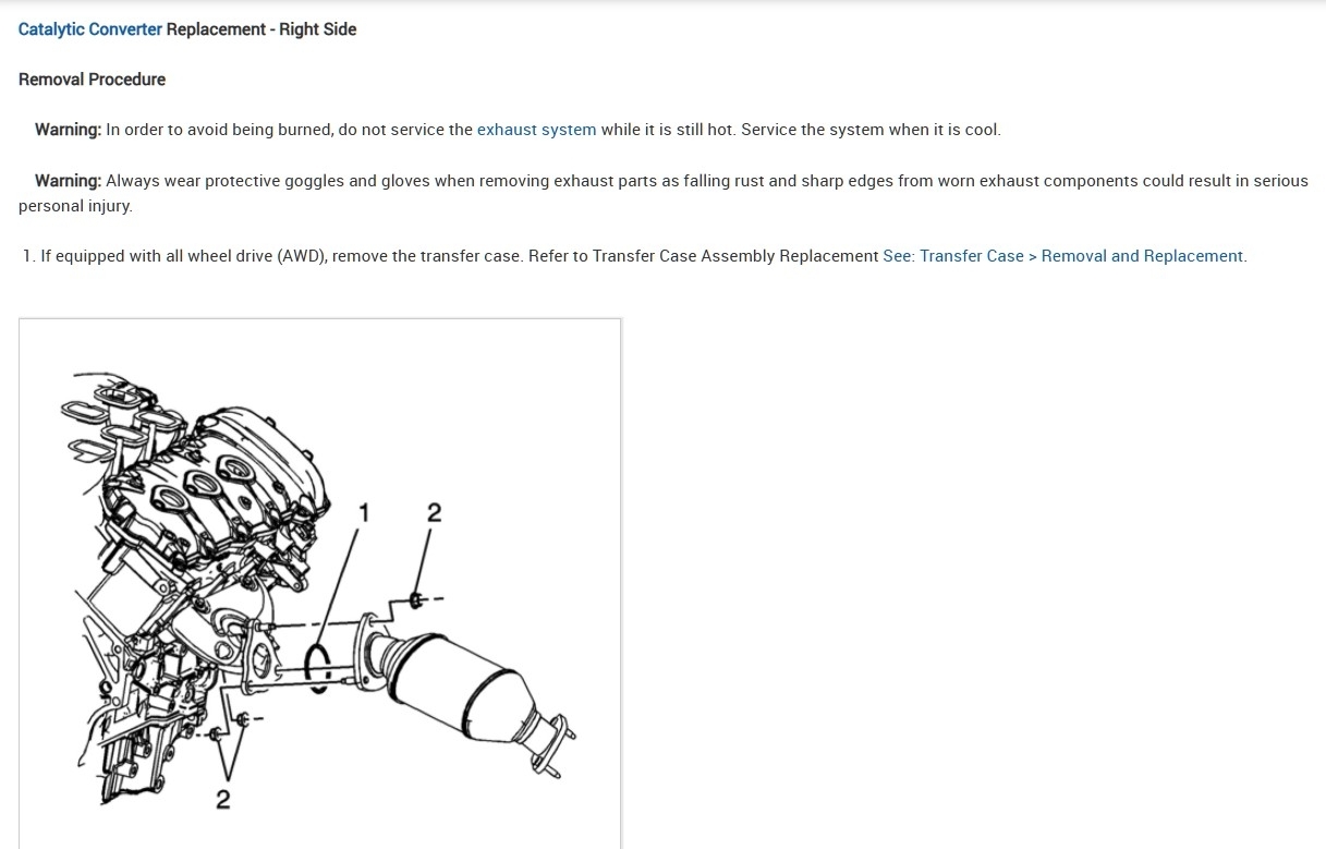

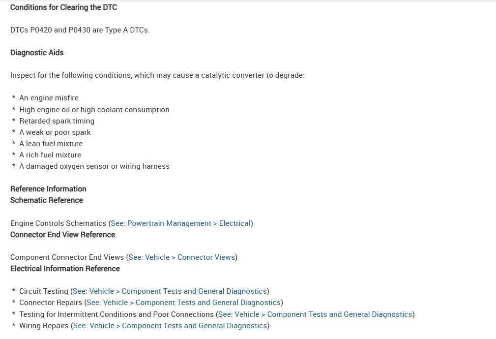

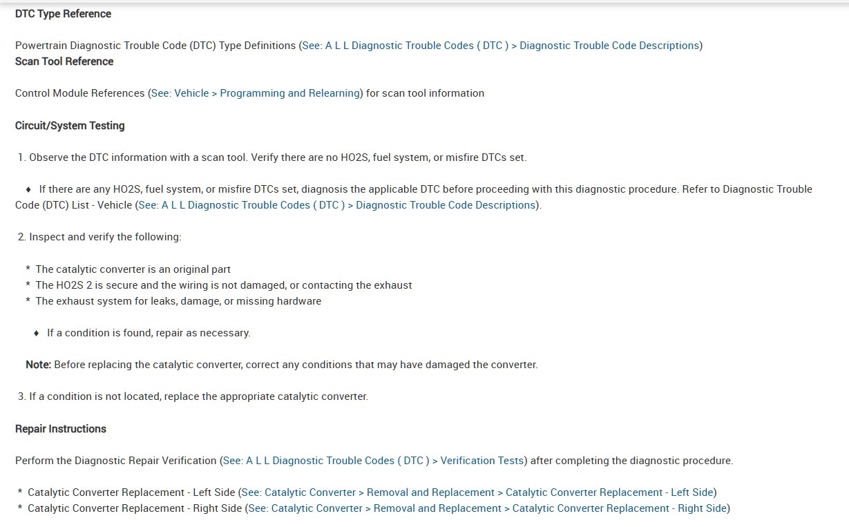

I will post some further service information on those two codes, but we will see how rich the engine is running first and if you notice any other data PIDs that look out of place.

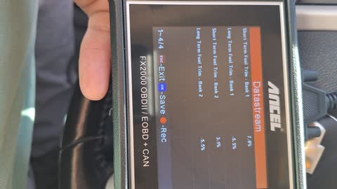

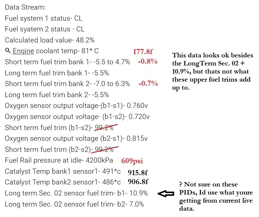

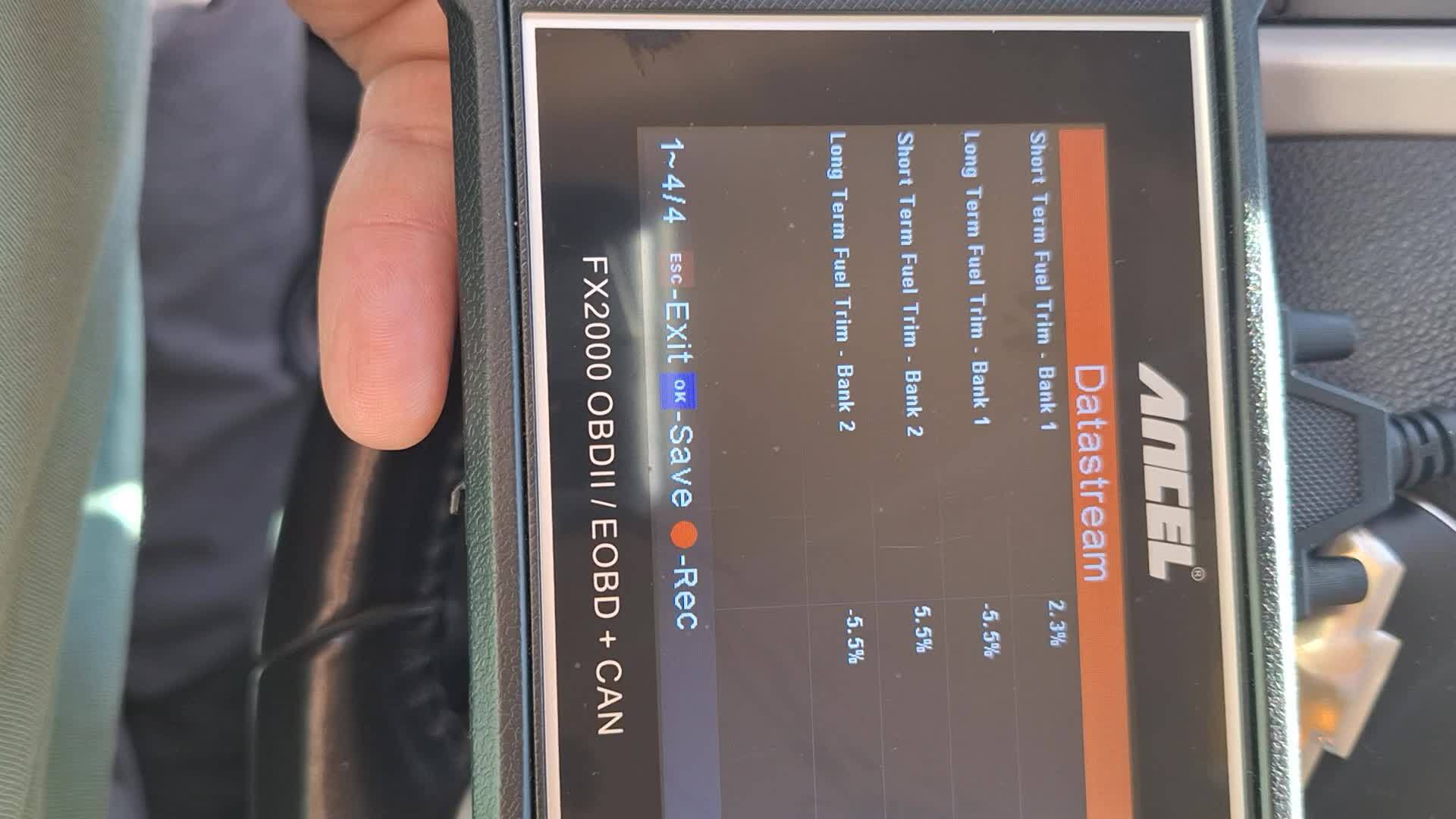

Hello, I have written down some things that I thought may be of help on this issue. Hope its something that you can use. When I hooked my scan tool up to the vehicle and it started up the first thing I noticed was the J1850 VPW and the J1850 PWM both failed. Next, I went into the IM readiness screen and thought these may be of some help. Catalyst monitor- ok, heated catalyst monitor- n/a, oxygen sensor monitor- ok, and oxygen sensor heater monitor-ok.
I then went into the freeze frame data and made notes of the following items:
short term fuel trim bank 1- 0.8%
long term fuel trim bank 1- went as low as -5.5%
short term fuel trim bank 2- 0.8%
long term fuel trim bank 2- 4.7%
fuel rail pressure at idle- 11890 kPa
fuel/air commanded equivalence ratio- 1.047
long term sec. 02 sensor fuel trim- b1- 10.9%
long term sec. 202 sensor fuel rim- b2 - 7.8%
02 sensor test- all passed
Next I checked some of the on board monitoring :
limit type- min&max
Component ID- $04
Catalyst monitor B1 test value- 0.133
min limit- 0.187
max limit- 1.999
Status- Fail
Catalyst monitor B2
Component ID- $04
Test Value- 0.141
min limit- 0.187
max limit- 1.999
Status- Fail
All 6 cylinders misfires passed
Data Stream:
Fuel system 1 status- CL
Fuel syatem 2 status - CL
Calculated load value- 48.2%
Engine coolant temp- 81* C
Short term fuel trim bank 1- -5.5 to 4.7%
Long term fuel trim bank 1- -5.5%
Short term fuel trim bank 2- -7.0 to 6.3%
Long term fuel trim bank 2- -5.5%

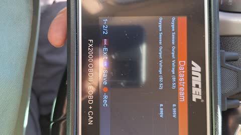

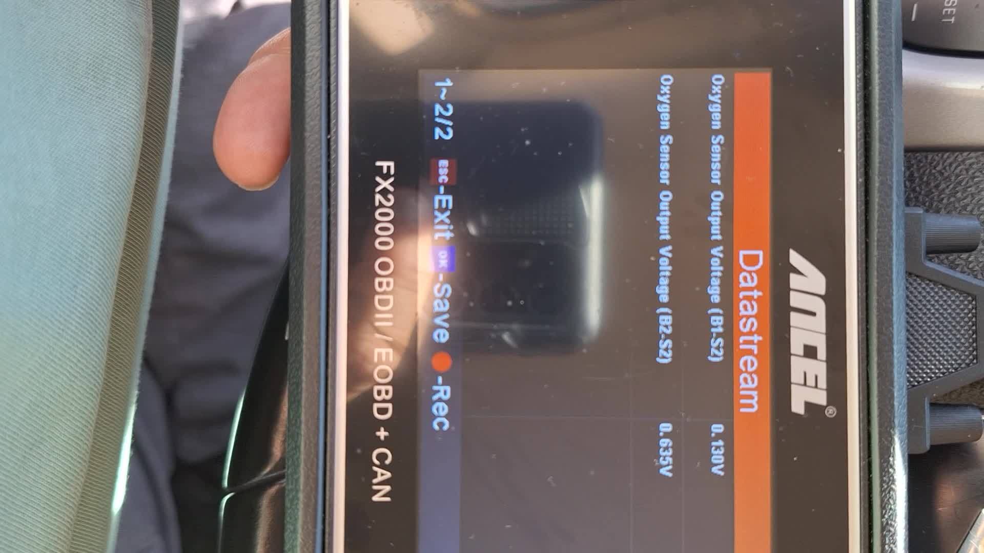

Oxygen sensor output voltage-(b1-s1)- 0.760v
Oxygen sensor output voltage- (b1-s2)- 0.720v
Short term fuel trim (b1-s2)- 99.2%
Oxygen sensor output voltage (b2-s1)- 0.815v
Short term fuel trim (b2-s2)- 99.2%
Fuel Rail pressure at idle- 4200kPa
Catalyst Temp bank1 sensor1- 491*c
Catalyst Temp bank2 sensor1- 486*c
Long term Sec. 02 sensor fuel trim- b1- 10.9%
Long term Sec. 02 sensor fuel trim- b2- 7.0%

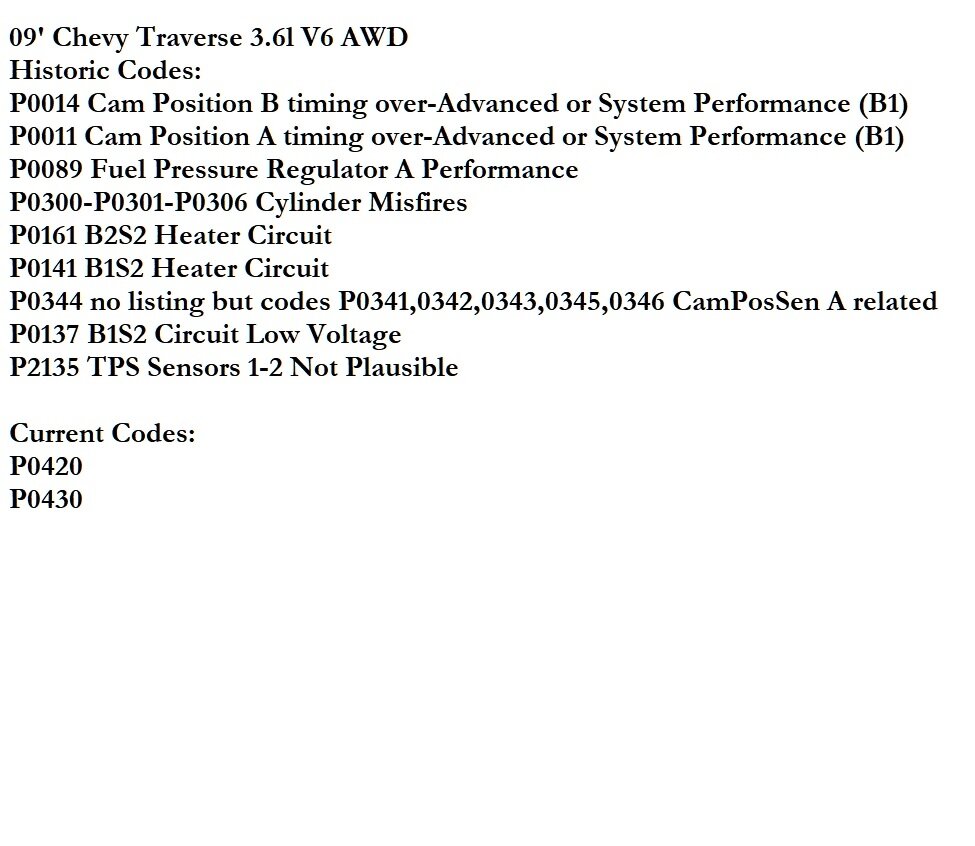

46 Times P codes have been set. Although some of them I went into showed to have no codes present. Here is the list of P codes I wrote down:
0014
0011

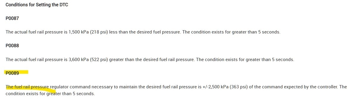

0089- fuel pressure regulator 1 performance
0300,01,02,03,04,05,06
0161
0141
0344
0137
2135
All of these codes were stored in the history. Only codes present were the 2 cat codes mentioned above in my first post.

I am also attaching a couple short videos i took of some of the data. Hope they can be of some use as well. Thanks again.

Okay, I'm copying all this data, as for the scan tool protocol type, I wouldn't worry about that too much, you were able to get onto the vehicles network and retrieve data, it looks like that's just the global OBD2 protocols and the scan tool searching for the correct one to communicate on. You could try updating the scan tool. There are constant updates for them. For the fuel trims, just pay attention to the data PIDs with Short Term/Long Term Fuel Trims, having the trims pulled up for each 02 sensor will just slow your scan tool down because its having to read more data, The less data PIDs you have up the faster the scan tool will refresh the live data.
When looking at fuel trims, just add the bank 1 LT and STerm together to get the total fuel trim for each bank, so looking at a frame of the trims you posted, Bank 1 +8.6(short term) and -5.5(long term) equals out to +3.1 total trim. Which is not bad, interesting both banks are stuck at -5.5 LT.

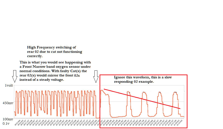

But if you were to graph that 02 data from the rear sensors you would see them fluctuating at a frequency that is too high for rear 02 sensors, that shows the cats are not storing oxygen which they need to be able to for burning off and converting the left over combustion gases.
What's the deal with all these codes? I know you said they were historic, but were they set prior to some repairs? Because that's a lot of concerning codes, misfire codes on every cylinder is not a good sign, I'm going to go through and look them up just to have a list. Along with the Cat temperatures in Fahrenheit (915f & 906f). If that data is correct, which I think those are estimated values, the reason why the Cat Eff codes are setting is because of the rear 02 voltage fluctuations. The voltage reading should be a much steadier, 600-700mv range or so, just not the high frequency you're seeing such as in the example waveform below.
If there were repairs done, and the cylinder misfires were taken care of, plus all the other code issues, this might be the aftermath and result of those previous cylinder misfires and possibly and over-fueling problem. I have heard of some people attempting to clean cats out or certain treatments, although I've never tried any, so I can't recommend something I haven't seen work myself.

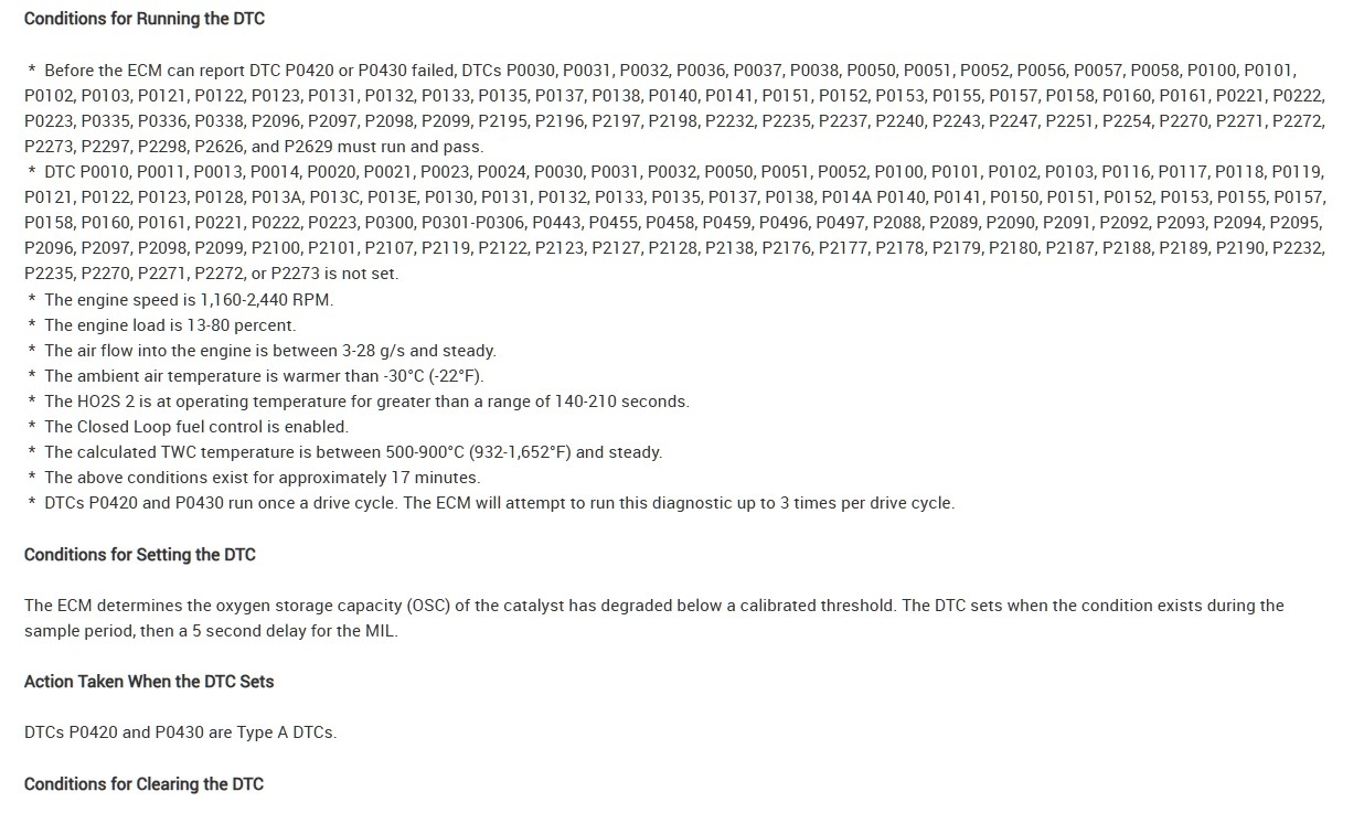

The freezeframe data is from saved data from when specific codes set, so you would have to identify what code that data went with, one thing I see that's not good is the "fuel rail pressure at idle- 11890 kPa" - Thats 1724.49 psi at idle, I dent think that's within spec, and that is probably what set the fuel rail pressure sensor code.

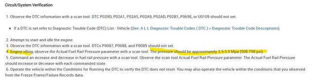

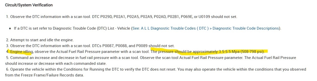

I also see a P0137 B1S2 low voltage, more concerning is this 508-798psi @ idle for rail pressure, 1724.49psi would set a code.
The calculated cat temperatures look high to me as well, Id check them with a laser temperature indicator to see if they are actually that high, check the front and rear of each cat. Hopefully they are not already starting to melt down.

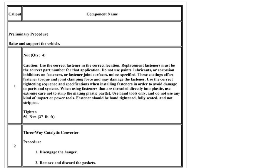

To check if they have started to melt, you can do a back pressure test at either front oxygen sensor location, pull the sensor out and I use an adapter from an old 02 sensor hollowed out that has a hose on it, which I then hook my vacuum gauge too, the cheap kind that also go up to 10psi positive pressure. Hook it up and start the engine, you only need a quick reading at idle, then have someone rev it up once or twice while monitoring the gauge, if it goes over 1.5-2psi max, the cats are starting to melt down and restrict the exhaust. If they are reading 2psi at idle, it will jump up much higher with a quick rev, then you know the cats are done unfortunately. But that's the way to determine if they are beyond recovering. Don't leave the pressure gauge on the exhaust long, just a few seconds to get some readings.

I'm going to look up these other codes.

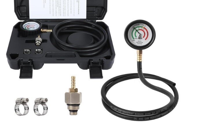

Could you possibly show me your test sensor and vacuum gauge you are using to check the back pressure? I'm not fully understanding the hollowed-out part and the hose attached to it. I cleared the codes yesterday morning before I drove to work and usually when I start the car to drive home from work the check engine light has been coming back on, however when I drove home yesterday the light never reappeared. One thing I did forget to mention earlier is after washing the vehicle earlier last week and driving on Saturday I did notice on the rear liftgate what appeared to be some black soot that was kind of wet feeling and would just wipe off with my finger. Almost like it was something from the exhaust blowing up on the gate. Also, the exhaust tips are caked with black soot looking stuff. If I am reading your last reply correct it seems to me that the cats may be on their way out or are almost gone at this point.

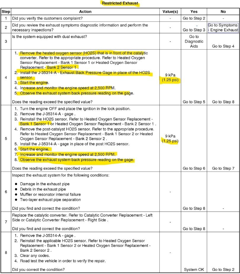

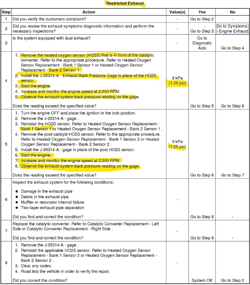

As for the back pressure testing, you can get a back pressure testing kit which includes the fittings for screwing in a adapter into the front 02 sensor location. Here is a link to a back pressure testing kit, (2nd pic) is basically what I made myself, I took an old 02 sensor, broke off the sensor section and drilled out the threaded section, then attached a hose adapted so my vacuum gauge could attach to the hose. I just didn't buy the kit because I had every already. Due to the rubber hose though, you don't want to leave the gauge on there for long, I have seen someone melt the adapter and caused the melted tube section to actually fall into the exhaust through the 02-sensor hole, it was a really dumb thing for them to do. Anyway, besides that awful story, when you have the gauge hooked up, have someone sit in the vehicle so you can monitor the gauge, get a reading at idle, and then have them give it a couple little revs.

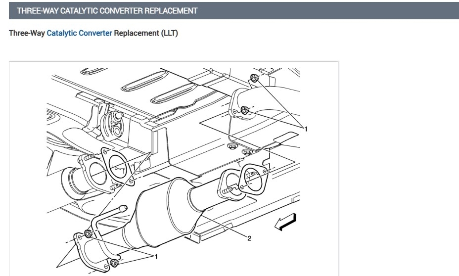

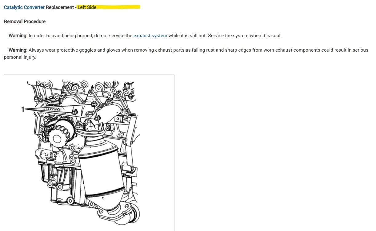

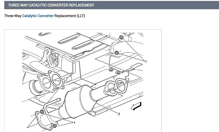

Surprisingly service info has back pressure testing instructions, first time I've seen that, but they want you to test both front Cats, one at a time. Now on some vehicles I have seen a 3rd cat, with no 02 sensor behind the 3rd cat, diagram 7,8 show the Three-way converter, so if both banks fail your front back pressure tests, if it happens that the rear (Post Catalyst) 02 sensor is after the front cats but before the 3rd cat, test at the rear 02 location and see if it fails the back pressure test at that location. For whatever reason some manufacturers don't always have an 02 sensor behind this 3rd cat, my vehicle actually has this setup.
If you fail your back pressure test at the rear 02 location, I would drop the front of the 3rd cat, and retest at the front 02 location again to see if the restricted exhaust is only effected by the 3rd cat, if it still fails at the front 02 with the 3rd cat front unbolted, then you know the issues are with the front cats. This will also give you a chance to visually inspect the 3rd cat's substrate from the front.

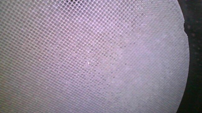

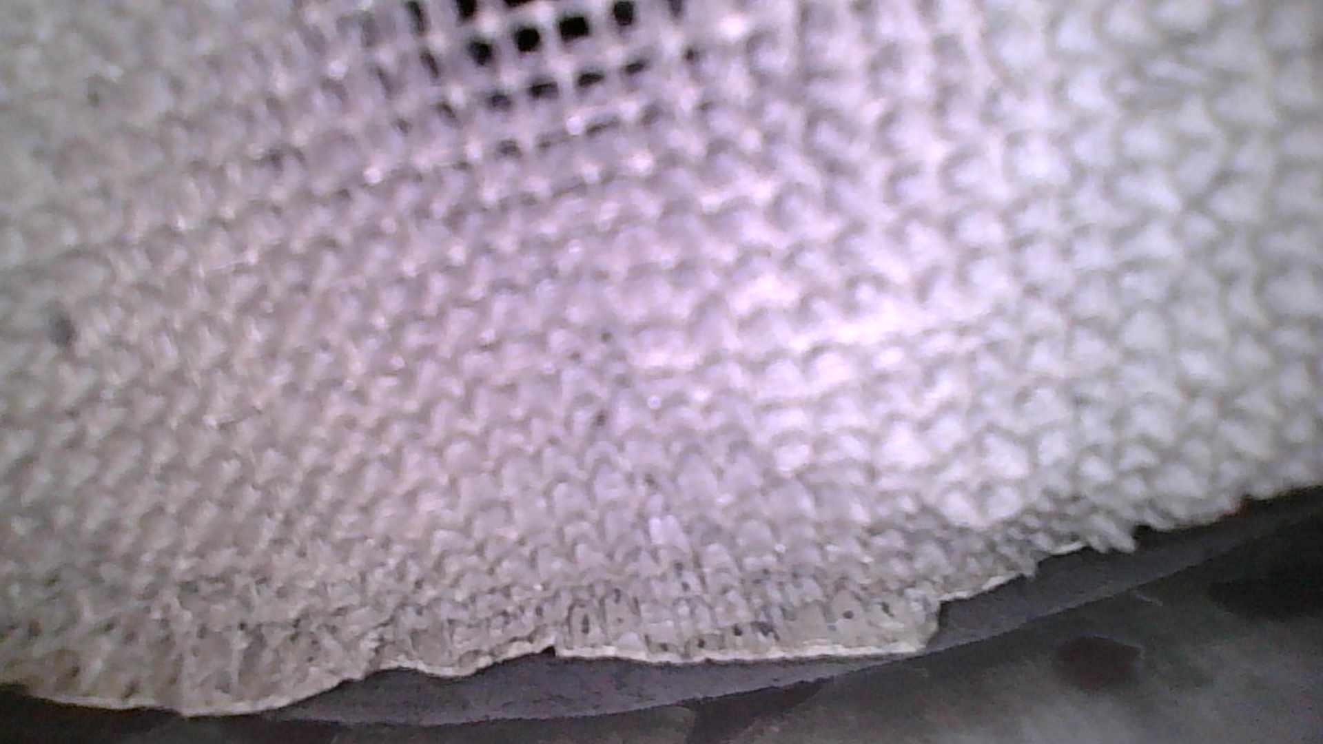

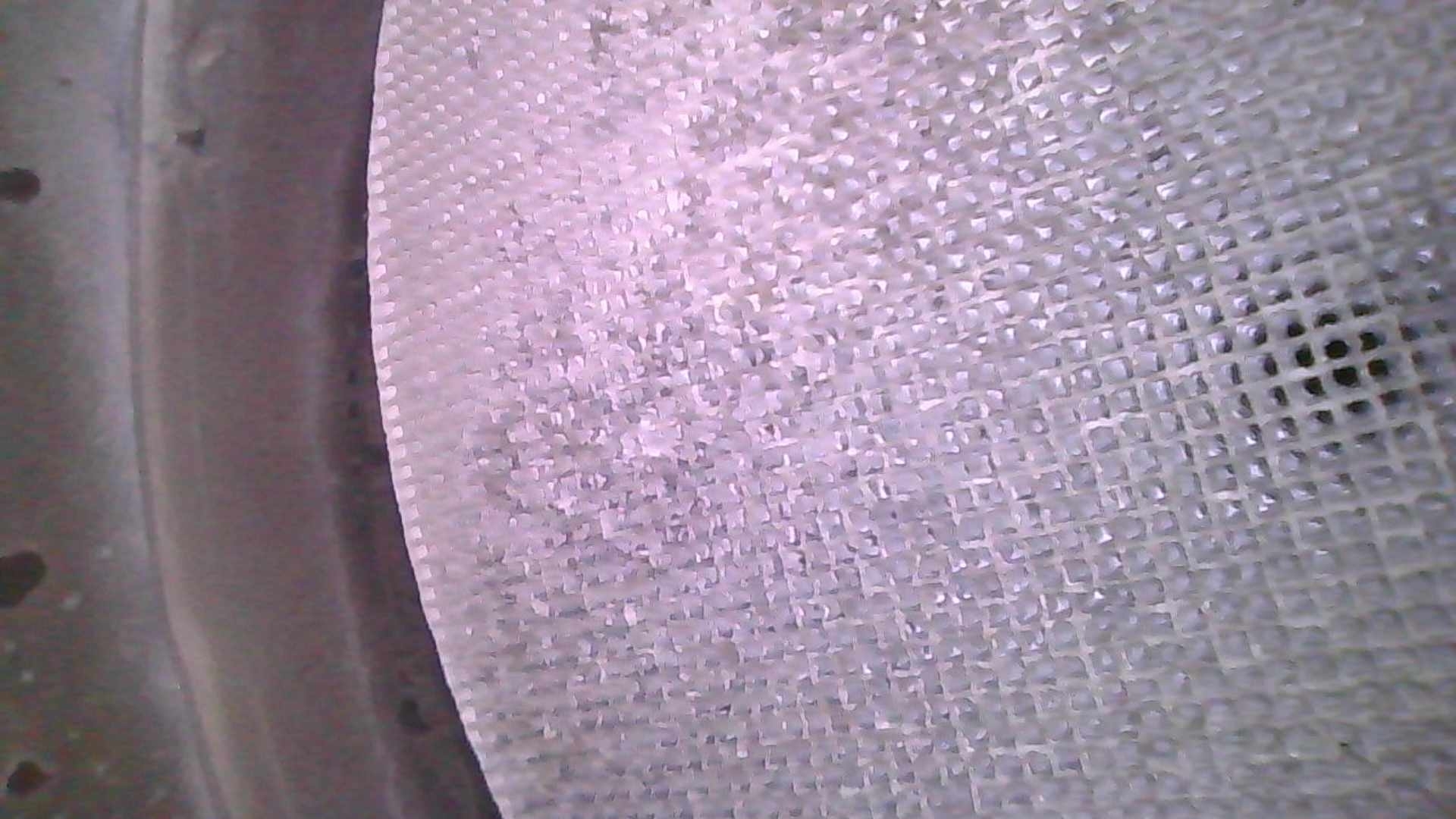

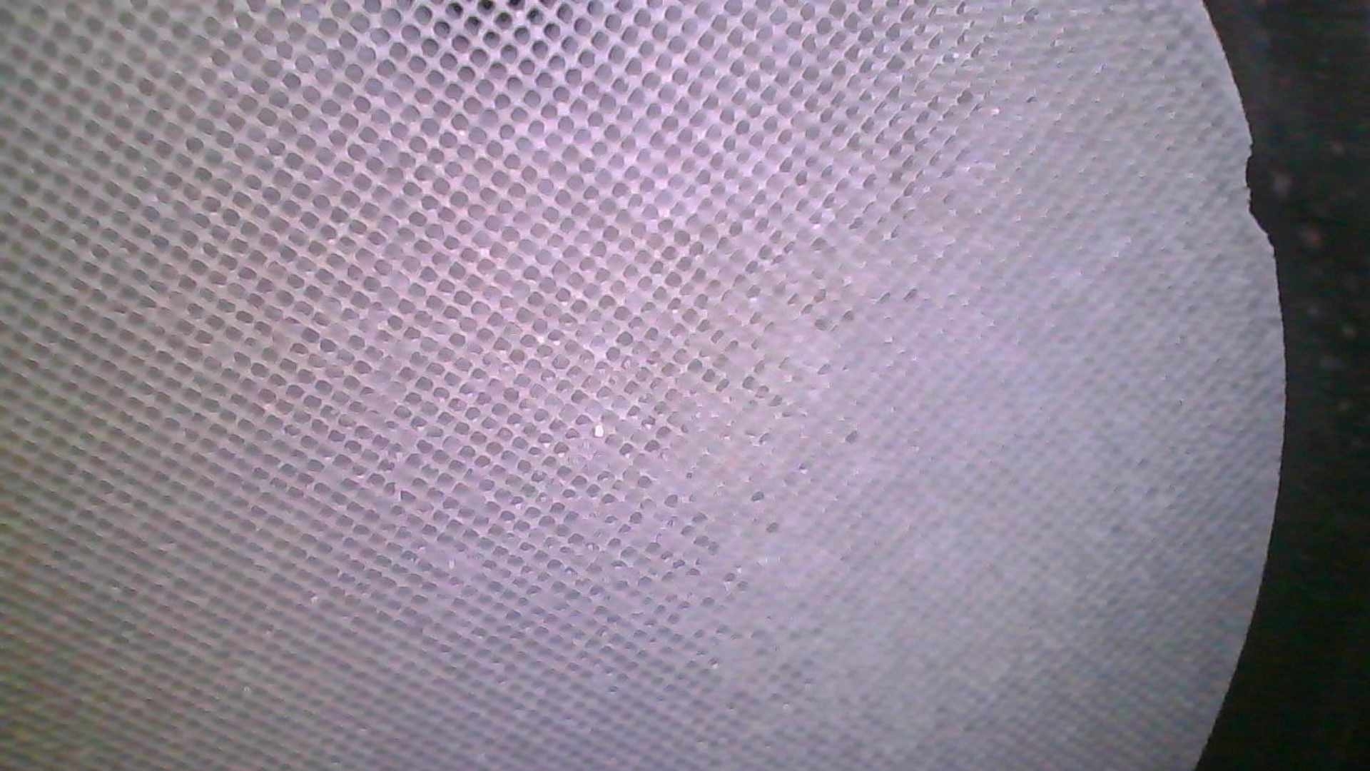

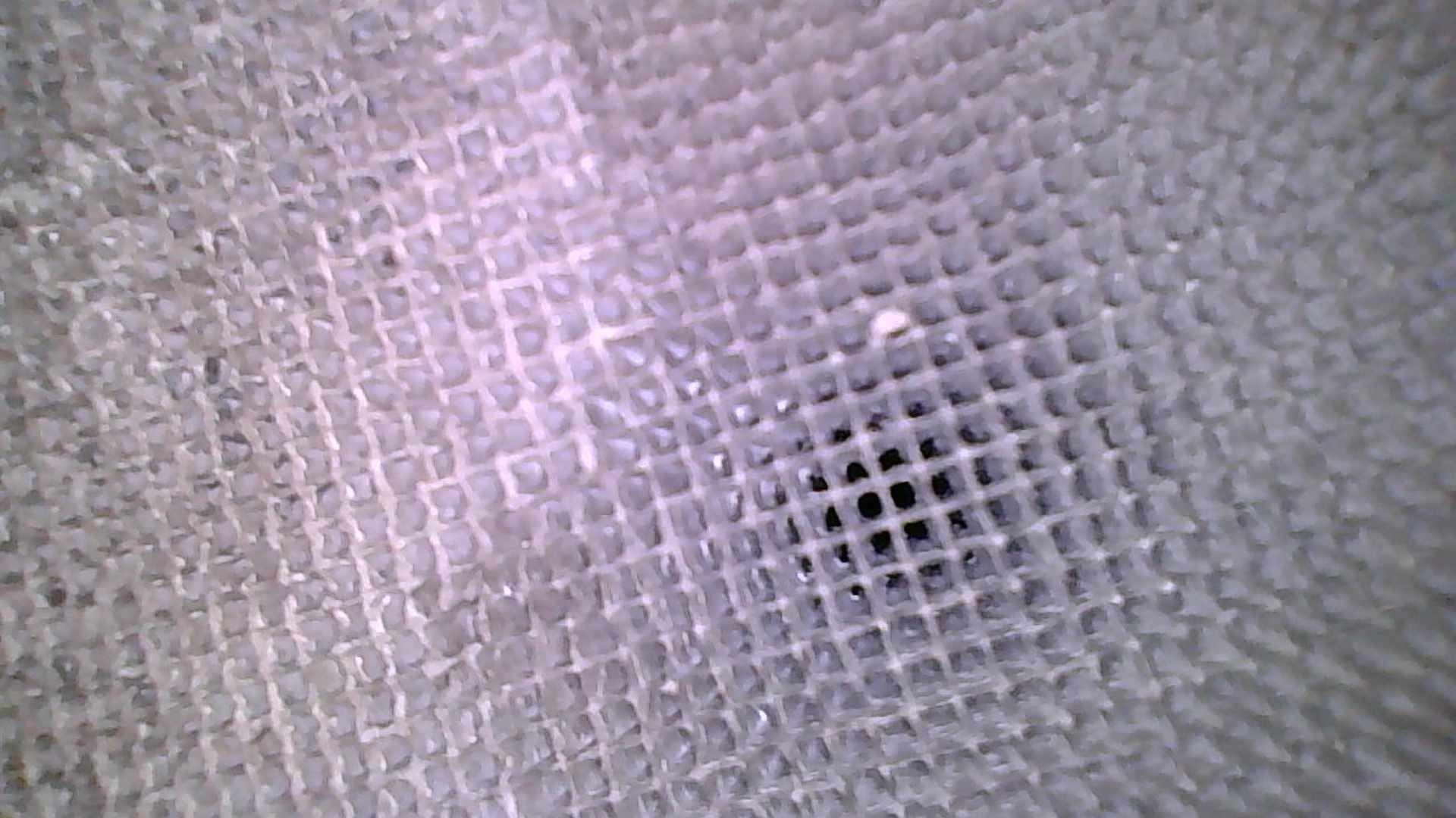

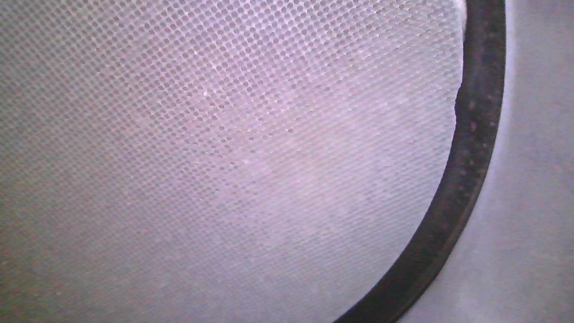

One thing I do before even going into all this type of testing is I remove the front 02s and take a look with my Bore Scope down the 02-sensor hole and see if the substrate looks like it's starting the melt down.
I've added a couple pictures 9,10,11 I took of a failing catalytic converter from a 4-cylinder Corolla. You can see around the edges where it had started to come apart, this was due to a failed Air/Fuel sensor heater circuit.
Pictures 12,13 are from a 07 Pathfinder that also had a failed cat, you can see the sections of the substrate that started showing signs of melting together. This was also from a failed A/F sensor as well; it was setting a code for the sensor, but it was already too late for the bank this cat was on. Sorry for the delay in posting, but I wanted to show these pictures as an example. With a very rich mixture the cat will start to overheat so much that it melts down into a ball of metal, blocking off the exhaust, and they can even break up into pieces and migrate down the exhaust into other sections, even getting into other cats or the muffler. You may or may not see this from the front view, but usually that's where the failure shows itself.
But in the testing method you can see that anything over 1.25 PSI is considered a failed back pressure test, most techs go with 1.5-2 PSI as a failed test. It would be nice if it's only the 3rd cat causing the issues, if it has one. Keep us updated and if you have any other questions.
https://www.amazon.com/Exhaust-Back-Pressure-Tester-Kit/dp/B0DHNF8MWW/ref=asc_df_B0DHNF8MWW?mcid=e7aef76852db3d34a3a6d90201733bf5&tag=hyprod-20&linkCode=df0&hvadid=712448966566&hvpos=&hvnetw=g&hvrand=2592928959495115489&hvpone=&hvptwo=&hvqmt=&hvdev=c&hvdvcmdl=&hvlocint=&hvlocphy=9009976&hvtargid=pla-2395504449241&psc=1
