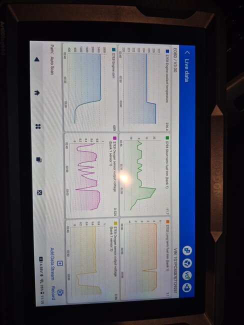

I have replaced the intake manifold.The turbocharger's been replaced turbo lines oil cooler, both 02 sensors, both catalytic converter still get p0420
Aug 9, 2026 at 1:50 PM
FOREMANT1
  • 7 POSTS
oh ya. lights flicker from time to time. Did a couple of charging test and first on said no load @ 15.29v load V @15.18v charging ripple @ 80.0mV
sec test was no load 14.75v load V 14.75v charging ripple @28.0 mV could this tell the ECM to not pass the cat sys?

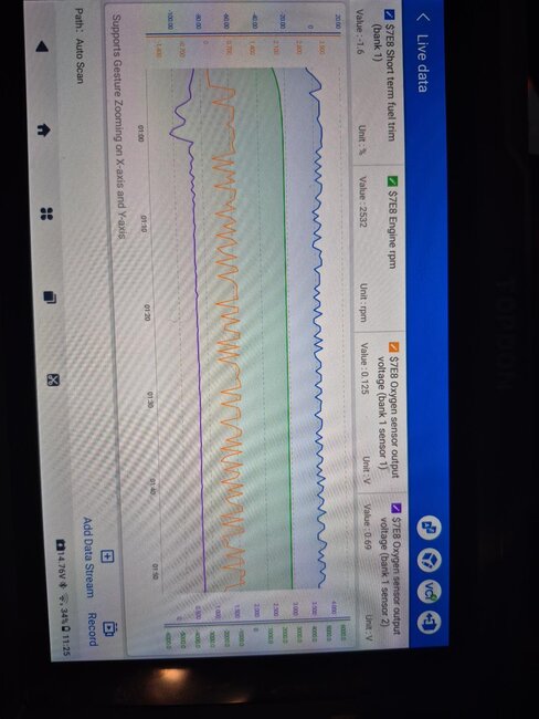

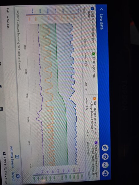

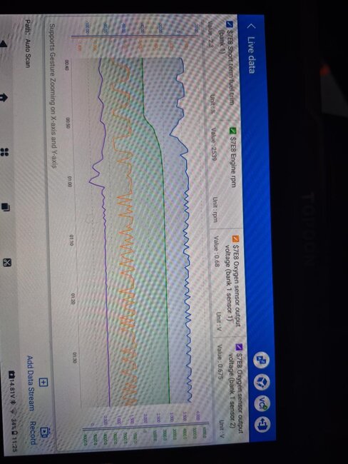

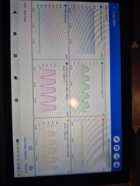

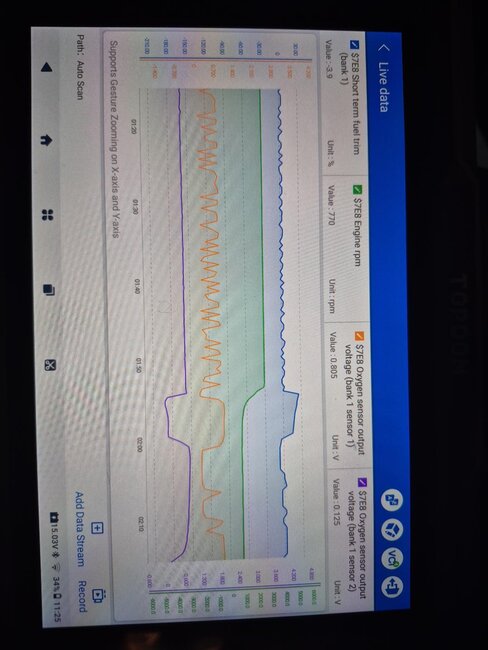

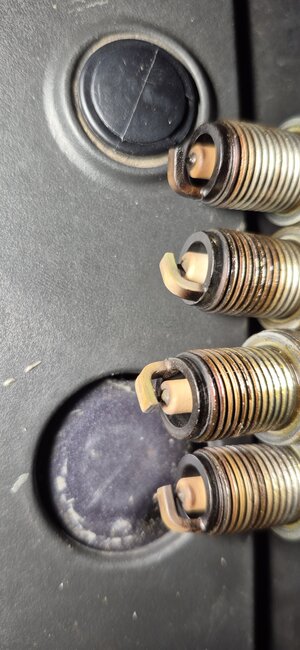

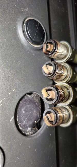

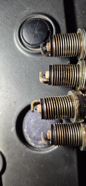

I have done a smoke test found no leaks. Sparkplug in order left to right. Put them back the way they came out.the catalytic is a aftermarket davico 19518. Don't have the funds for a real catalytic. Which is close to 2k.but hopefully can get this fix for my son.
Aug 12, 2026 at 7:59 PM
  • 55,381 POSTS
Good find on the spark plugs, The one looks dark, I would check the compression of that cylinder and if it is okay replace the fuel injector. Here is a video to help.
https://www.youtube.com/watch?v=KOxIm1F8AW0
Please let me know what you find, also the after market cat might be the issue too but lets do the test first.

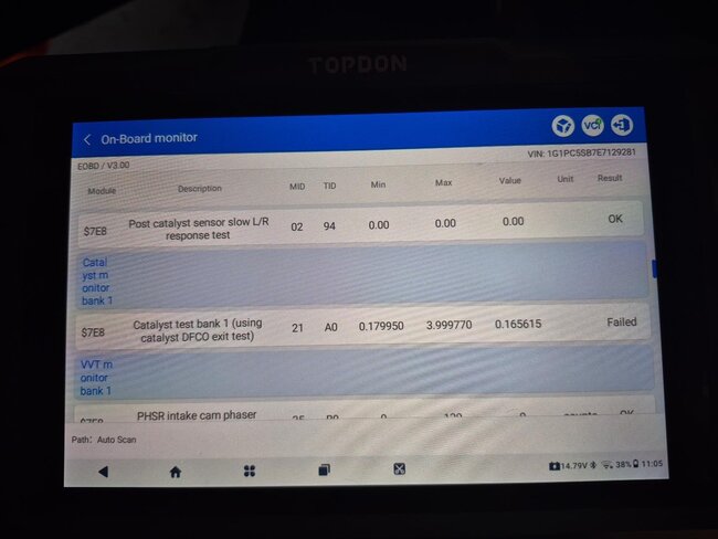

Drove about 25 miles and p0420 came back on. Probably is the aftermarket catalytic. I did ended up changing the plugs and replaced the one injector.

Yep, the compression is good. Does the engine have an exhaust leak? If not I would go with the aftermarket cat causing the issue. It is rare but I have seen the PCM go bad and cause this issue as well. Also, the engine seems to run okay, no power issues?

Okay, if you have no exhaust leak I would say it is the aftermarket cat. Lets try that first.
