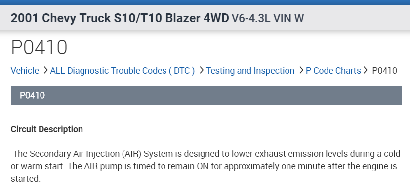

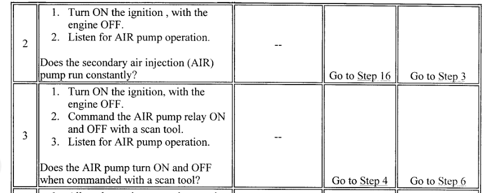

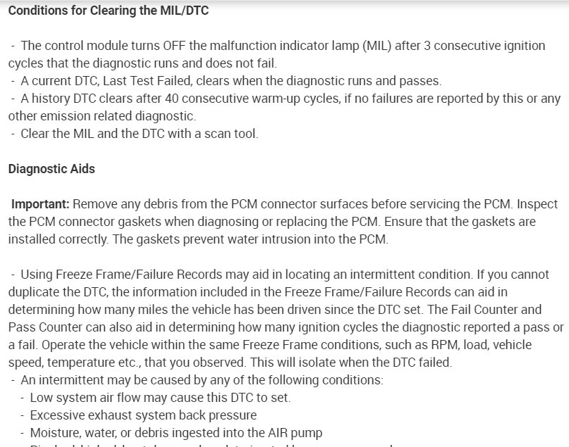

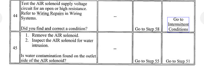

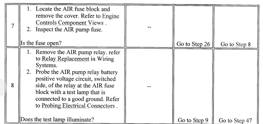

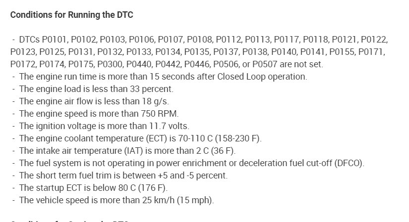

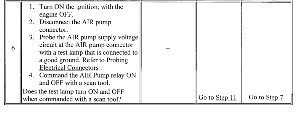

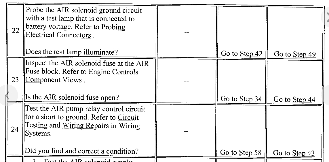

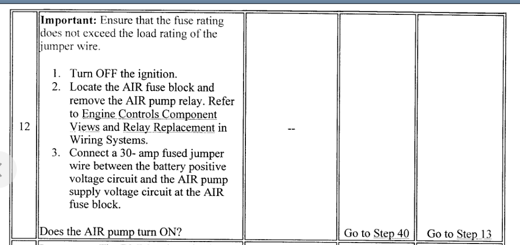

Code P0410
2001 CHEVROLET TRAILBLAZER
200,000 MILES • 4.5L • V6 • 4WD • AUTOMATIC
LONNYOWSLEY

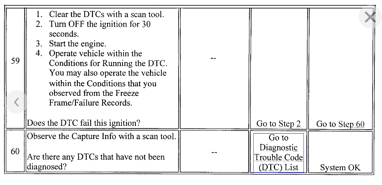

Won't pass smog and check engine light won't go off.
Apr 27, 2019 at 1:58 PM
SCGRANTURISMO
  • 4,897 POSTS

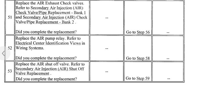

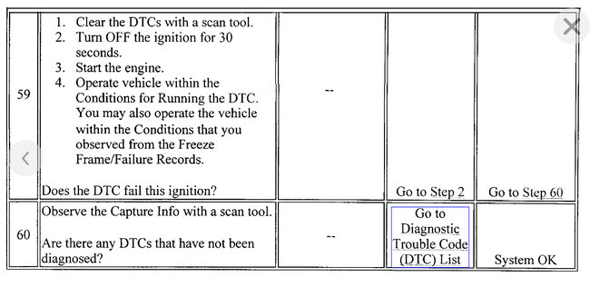

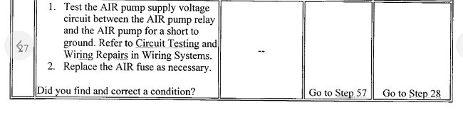

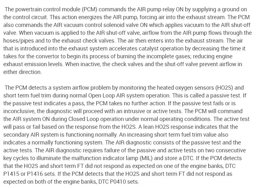

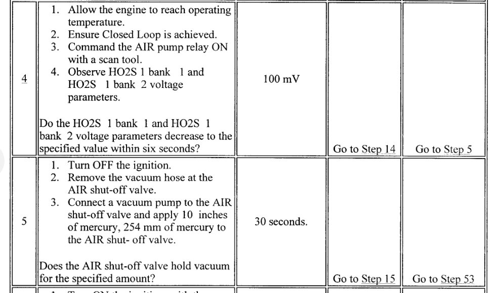

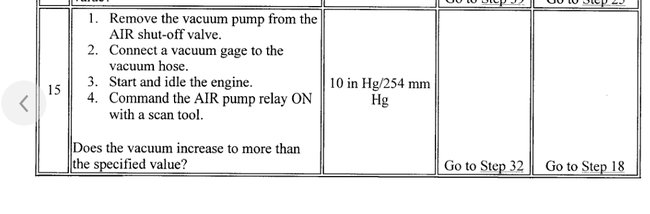

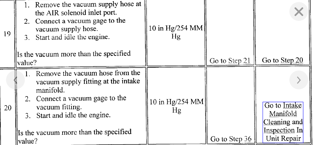

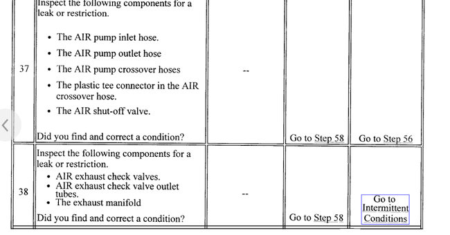

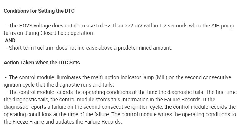

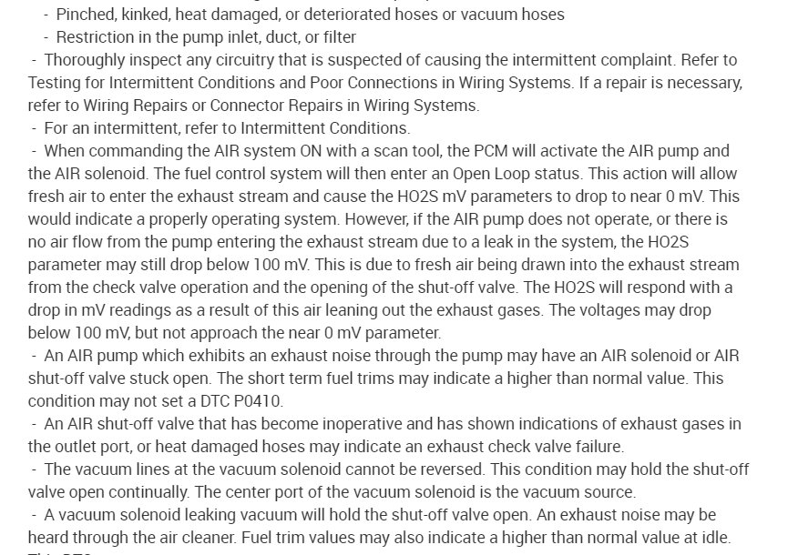

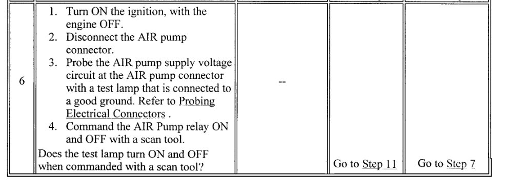

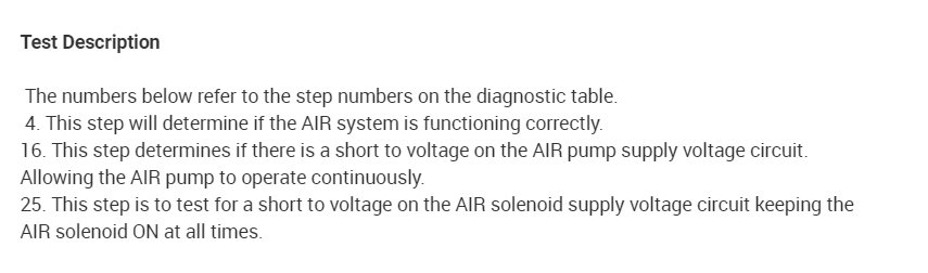

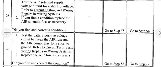

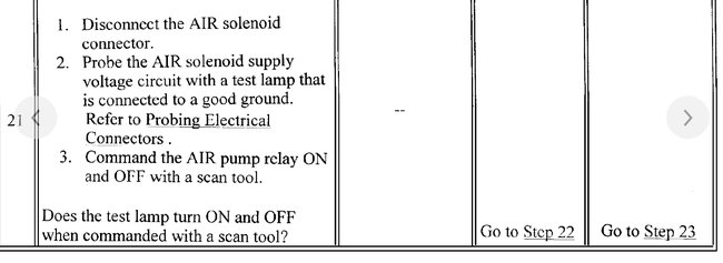

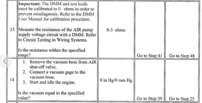

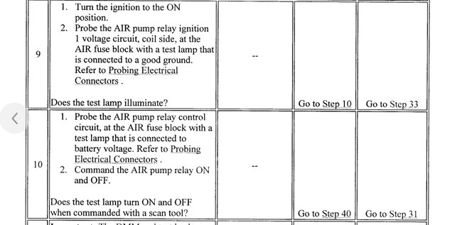

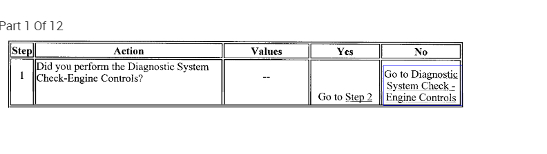

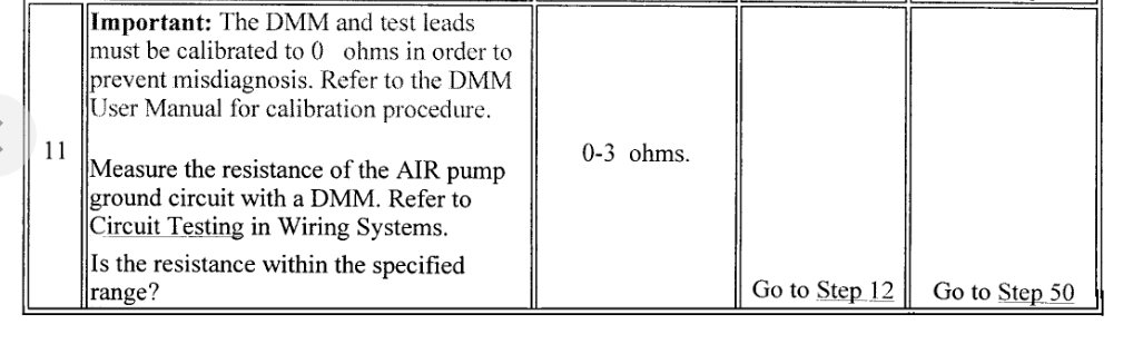

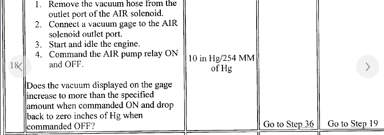

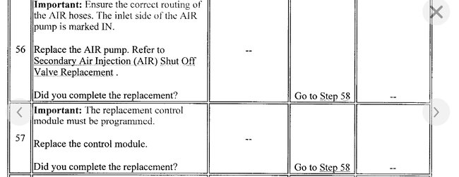

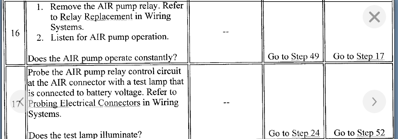

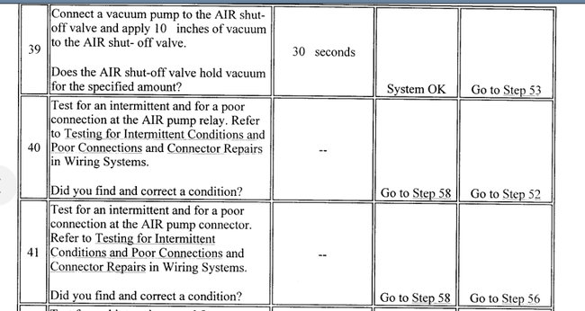

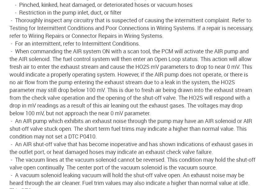

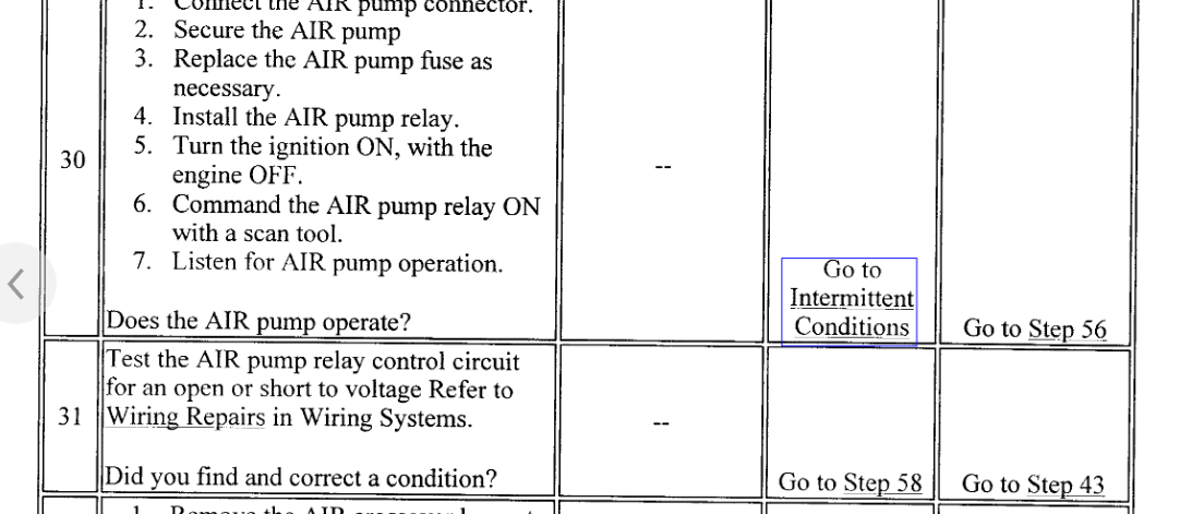

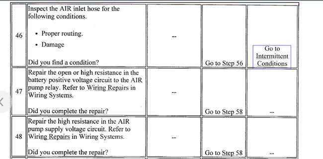

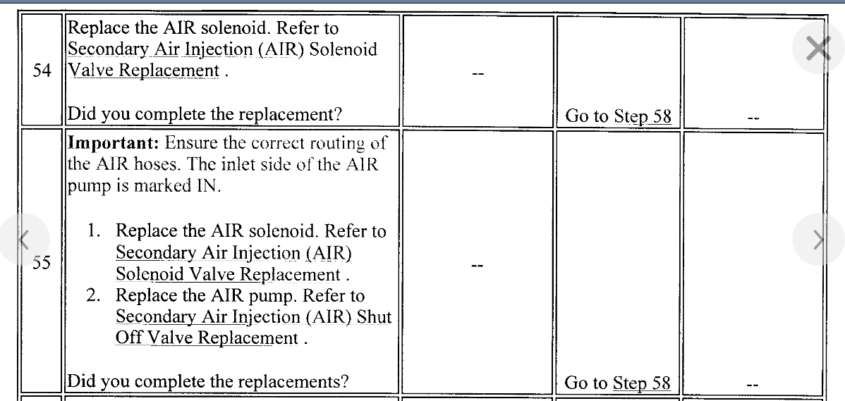

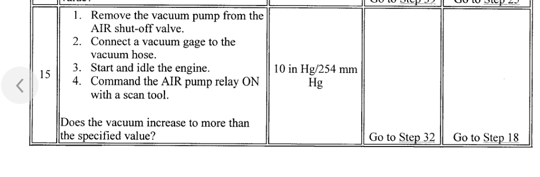

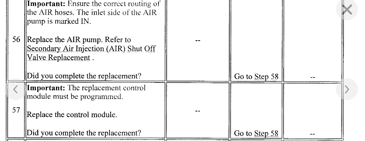

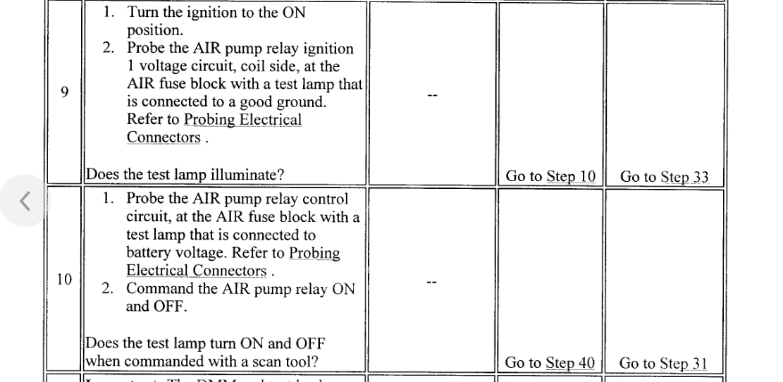

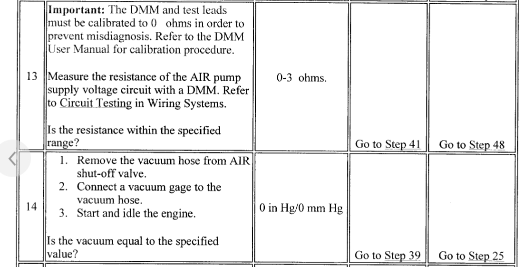

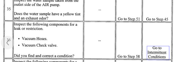

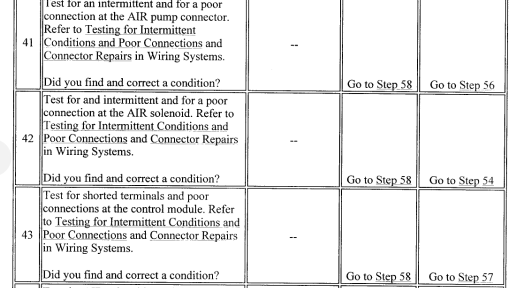

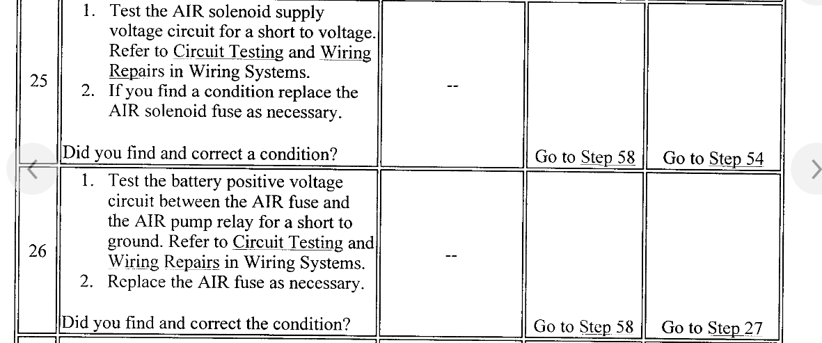

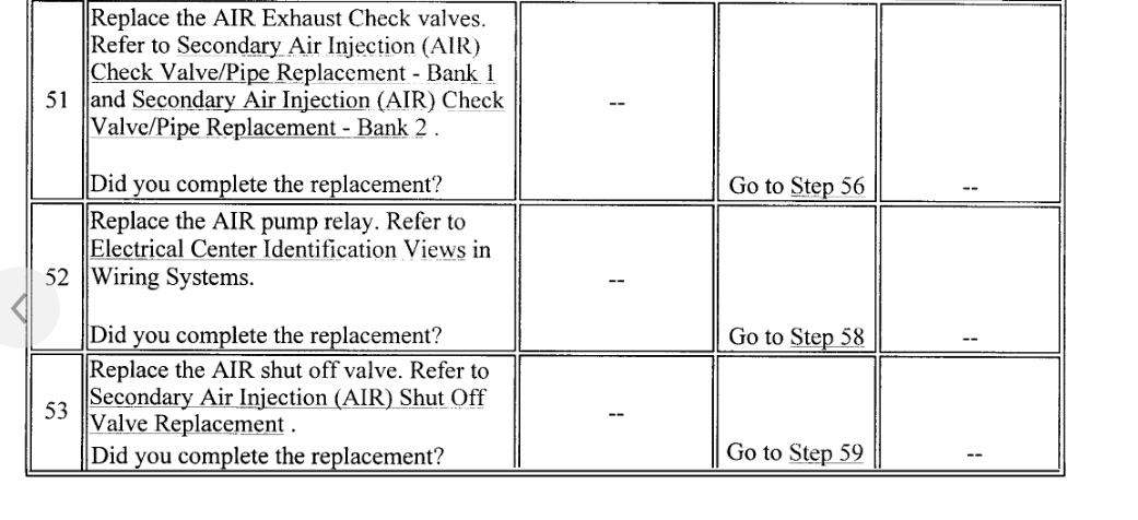

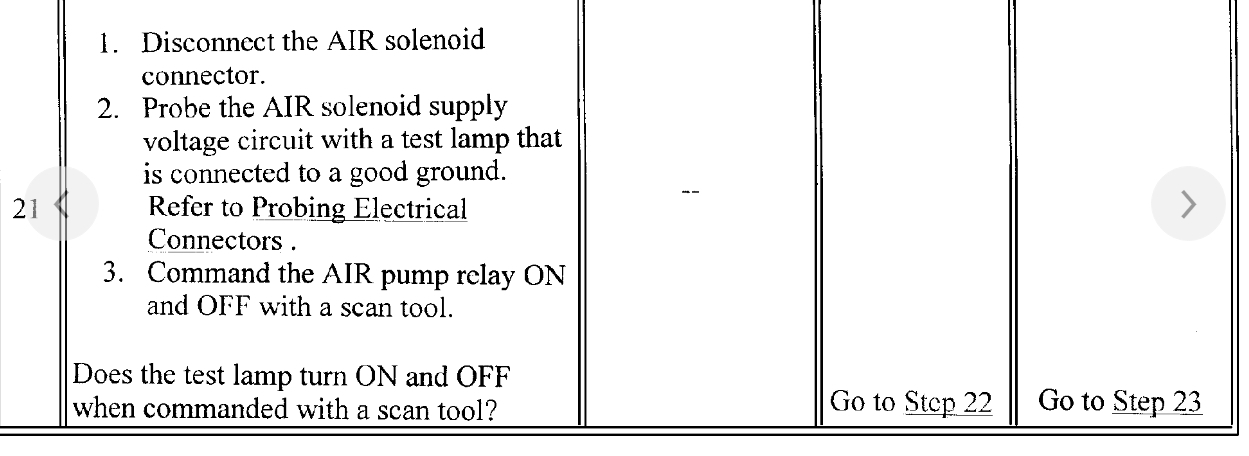

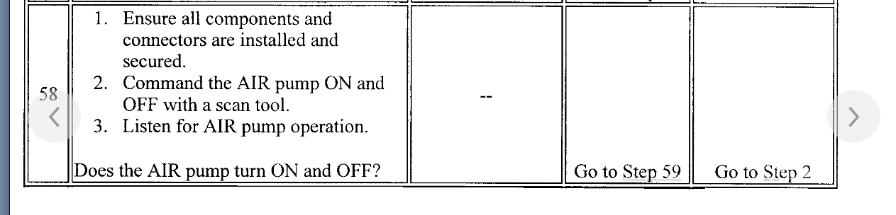

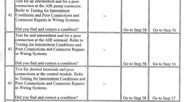

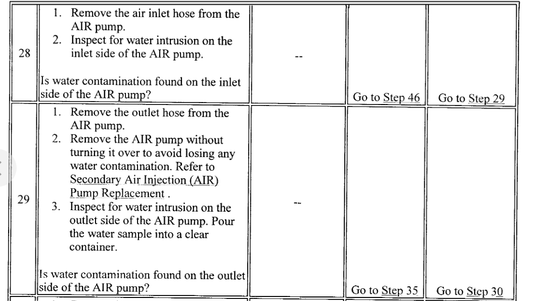

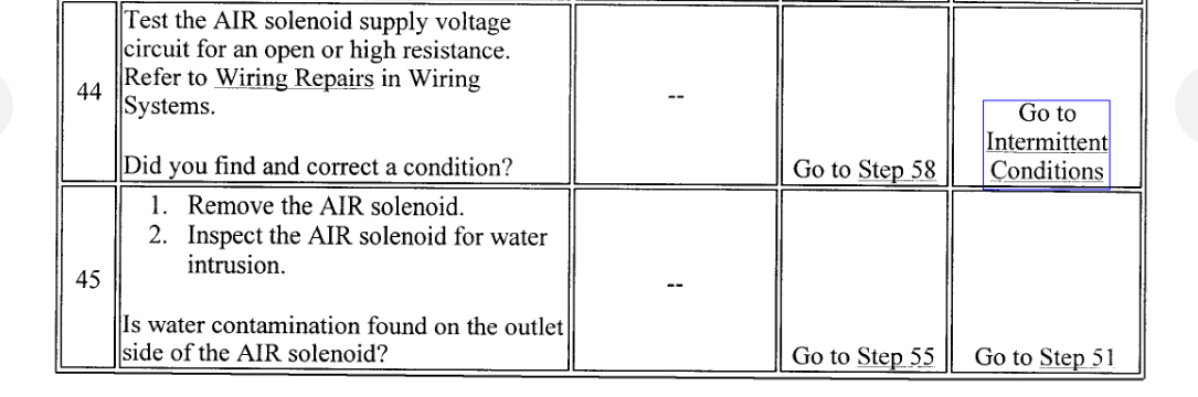

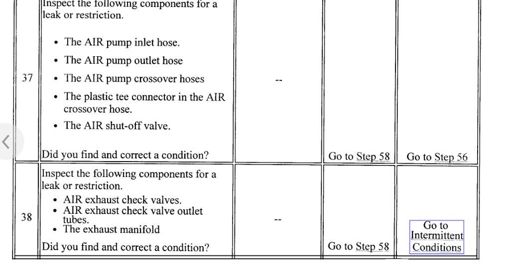

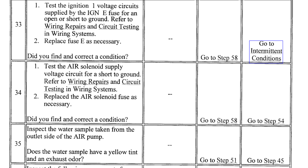

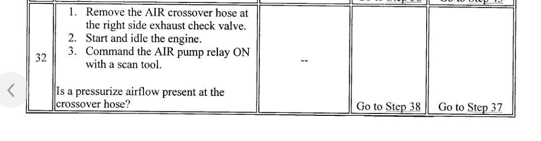

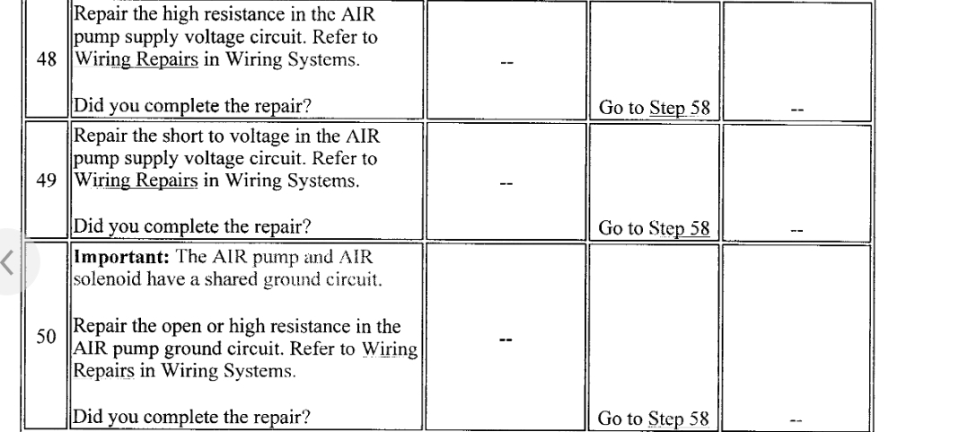

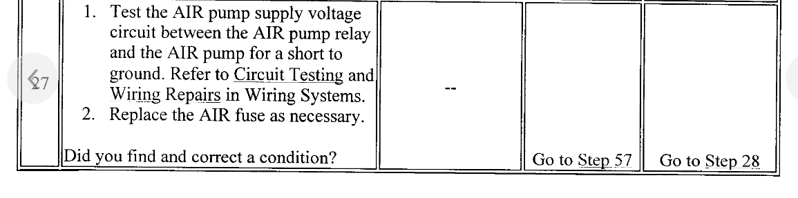

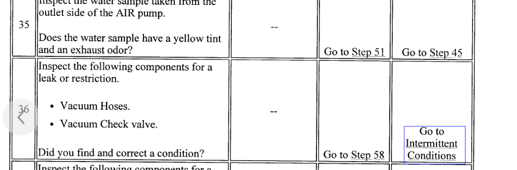

I have included the factory troubleshooting flowchart for you in the diagrams down below. Go through them and get back to us with what you find out, please.
Thanks,
Alex
