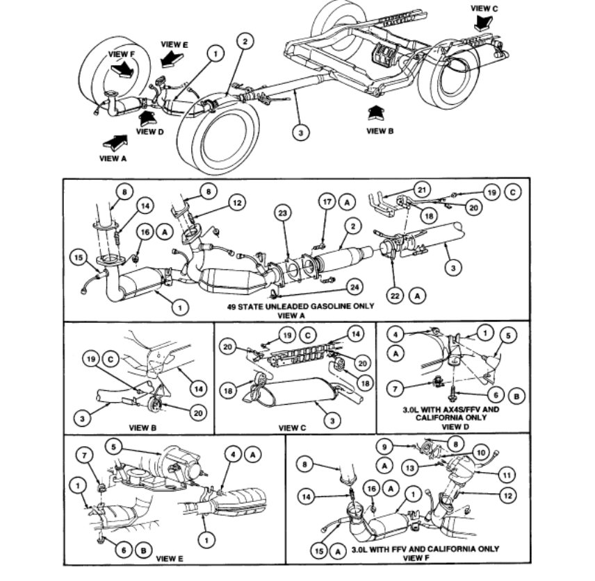

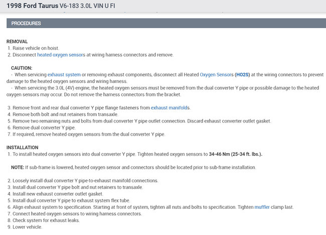

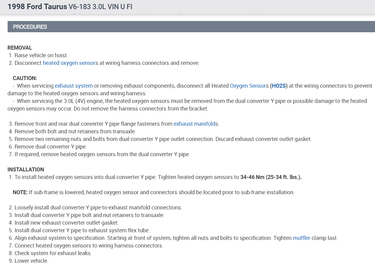

This sounds like you have a clogged catalytic converter which will cause these codes. To be sure, let's test the catalytic converter here is a guide to help and I have included the replacement instructions in the diagrams below for your car and a generic guide as well:
and
https://www.2carpros.com/articles/catalytic-converter-replacement

Ken, thanks so much for the reply. I had that thought in my mind given the mileage. A shop was supposed to do the test but didn’t. I’m wondering given no loss of power and no odd smell of sulfur, if it could be a clogged EGR tube and/or the vacuum lines to the recently replaced DPFE. Can the tube really be cleaned well or are you better off replacing? I have the new vacuum lines but haven’t installed them. One mechanic wrote that he always replaces those lines on Fords when he replaces the DPFE. The EGR image below doesn’t seem to be for my car, the DOHC 3.0L, 98 Taurus. Perhaps it’s a diagram of the 12 valve Vulcan 3.0L? On my car, the DPFE is on the right side behind and underneath the intake manifold, when standing in front of the car, looking at the engine, and the solenoid is to the left of the engine, a good distance apart…almost 2 feet.
Also, about 18 months ago, I had a downstream O2 sensor fail. I replaced it with a Bosch…all that was available on a Saturday. I recently replaced both as they should be done in pairs with Densos, which I believe are better, and OEM. But, again, the shop was to test the catalytic converters, and didn’t. Maybe they didn’t think it was necessary. It wasn’t a quality place with knowledgeable ppl, they are having a hard time getting employees.
Curious about your thoughts given the additional information? A Walker exhaust section with the three cats is $425.00 and they won’t ship to NY, and the car is 24 years old, so I am hoping it’s something less expensive, as if do catalytic converters probably makes sense to do entire exhaust as if parts of catalytic converters broken, pieces could be in mufflers, so I now understand.

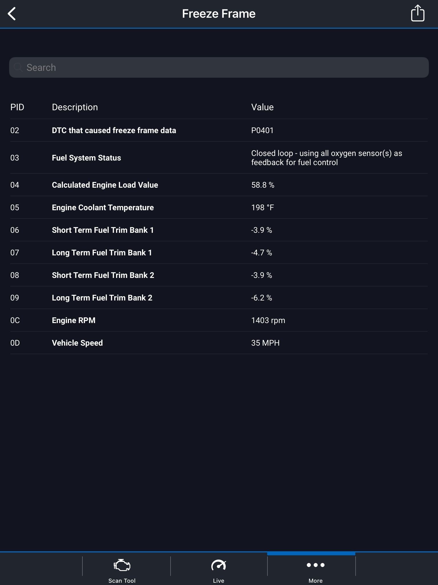

Oh, the one system I can’t get to run when checking diagnostics is the catalyst systems. Do you know the real drive pattern for my car? All I get are many contradictory instructions online. Thanks again!

Freeze Frame Data.
Apr 14, 2022 at 4:33 AM
  • 55,433 POSTS
The freeze frame data doesn't really show much wrong, but I know plugged cats will burn up the DPFE sensor. Also, all tubes and passages must be clean for the system to work correctly. You might want to try removing the system and looking into each cat to see if the catalyst is burnt up. Please let me know, it would be a fun weekend project.
