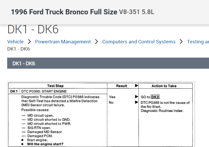

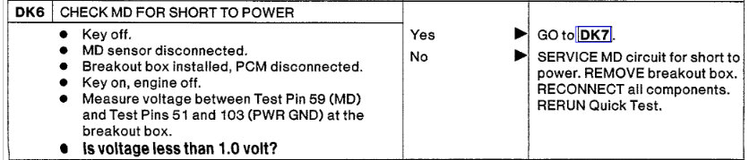

It sounds like you may have a short to power if the light turns on right away. It could be a short to ground as well, or even a wire broken internally, causing too much resistance in the wire or not having continuity at all times.
I attached the diagnostics below. It sounds like you have already done some of the procedures. Take a look through them and let me know if there is anything there that is helpful.

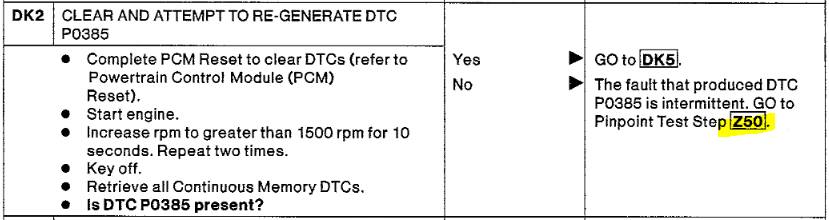

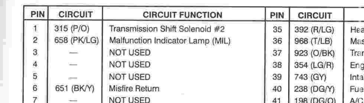

See pics below. Note: If you look at pic 2 below, you will see I highlighted one of the tests that is not listed. If you feel that is the direction you need to go, let me know.

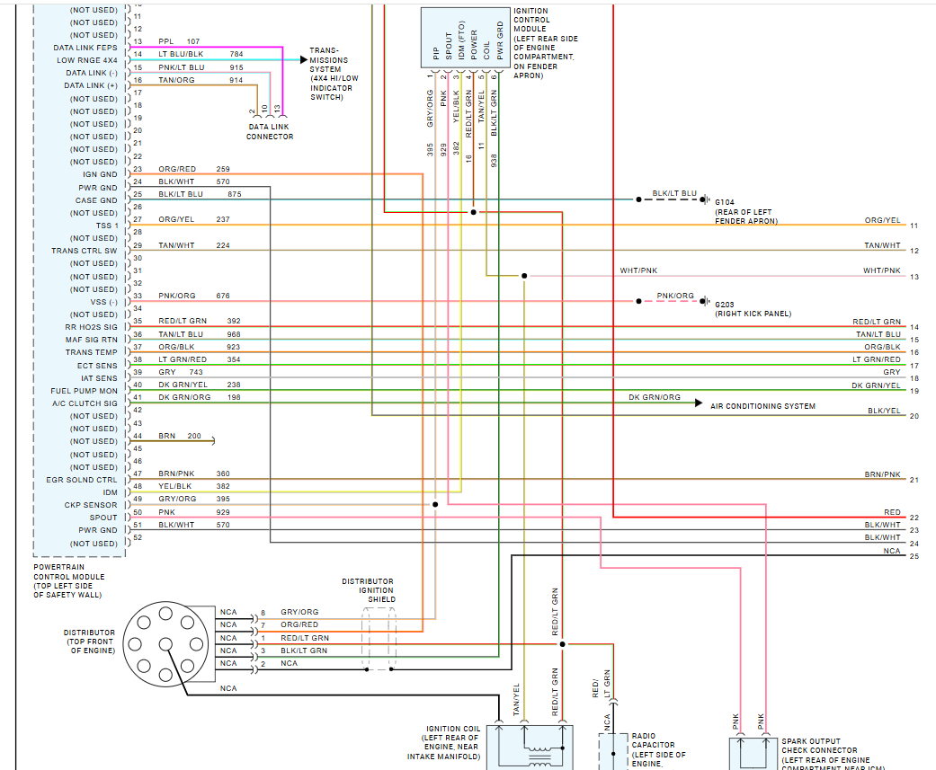

Here is a guide to help with that and the engine wiring diagrams below to help as well.
If the wiring is good replace the distributor. There is a chance the PCM is bad as well FYI. Check out the images (below). Let us know how it goes.

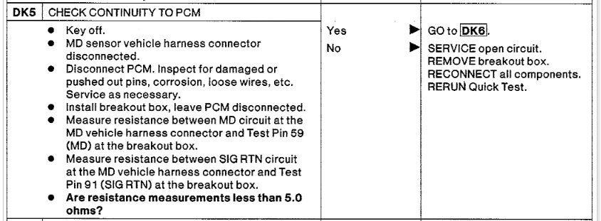

Ok so here is what I found with wire tests:
On DK2 when I reset the code the MIL doesn’t immediately illuminate but I do get the pending code and I get the code on the key on engine running test.
On DK5 the signal wire to pin 51is good continuity with resistance of .5 ohms but the return was on pin 6 of the harness not pin 91 but the resistance was also less than 0.5. But no continuity to any other pins on the PCM. Not sure if that’s an issue or the diagram is maybe wrong?
No shorts noted on DK6
DK7 all those showed OL so I believe that’s good nothing touching in the PCM.
On DK9 I backprobed the pins from the sensor and at idle I got 0.5 volts and with increased throttle it went up to about 1 volt. Not sure if I’m reading the flowchart as that’s good or bad?
DK10 is good - it’s a newer sensor and the tone ring/harmonic balancer have already been replaced.
All the connections look clean and free of debris or oil.
So should I try distributor now or does anything in those tests stick out?
Thanks

Sorry, I forgot to tell you you need to have the PCM and distributor unplugged to test the wiring.
Jul 20, 2025 at 3:00 AM
JOSH_019
  • 25 POSTS
Ok the PCM was unplugged and key off but distributor was still plugged in. Do I need to disconnect the wiring harness on distributor?
And just to confirm if I do again and I don’t get any continuity between the MD sensor return and Pin 91 and only to pin 6 then that is no good correct? Should I try a jumper and see if that clears the code?
Jul 20, 2025 at 3:44 AM
  • 55,421 POSTS
Yes, the wiring must be disconnected to test it, yep give the jumper a try to see what happens.

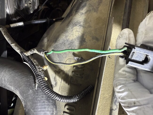

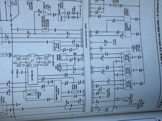

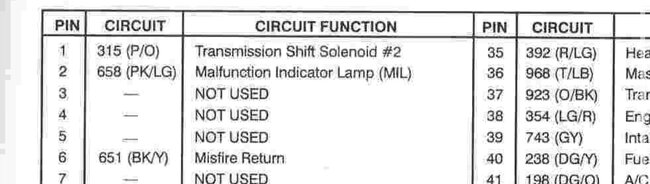

Ok so the MD sensor is a black yellow wire which the same as pin 6. The 91 should be grey red but I don’t see that ever going to the MD sensor. I just wanna make sure pin 91 is correct. One of the wiring diagrams shows pin 6 as the MD return on circuit 651. I don’t want to fry anything jumping to pin 91 if it should be 6.
Also same results with the distributor disconnected.
Jul 22, 2025 at 5:56 AM
JOSH_019
  • 25 POSTS
This also shows misfire sensor as pins 59 and 6
Jul 22, 2025 at 6:13 AM
JOSH_019
  • 25 POSTS
I also just tested that pin 91 and it seems like it’s a return for the sensors which concurs with the Chilton page wiring diagram I sent

Sorry for the multiple messages - I also pulled the current MD sensor and resistance is good on that sensor and I’m getting good AC voltage back to the PCM. And when I clear the code and I do the key on engine running test it picks up the code on the first attempt. Not sure if that helps us diagnose at all.
