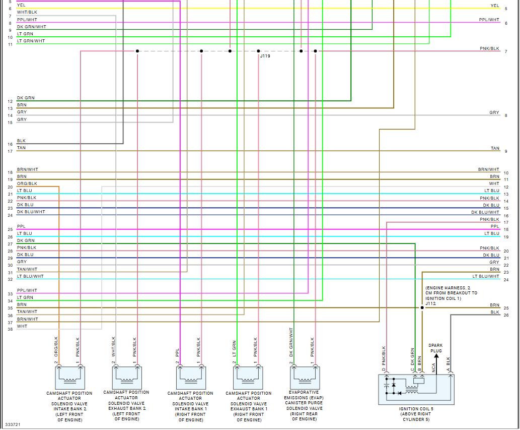

Im getting these 2 high voltage codes the bank 2 side of the motor. Inspected and replaced camshaft sensors they are good as well as the crankshaft sensor. So, its leading me to believe that it's in the wiring but I am getting the accurate 5-volts that it's supposed to get so I'm not sure why its reading "high voltage"

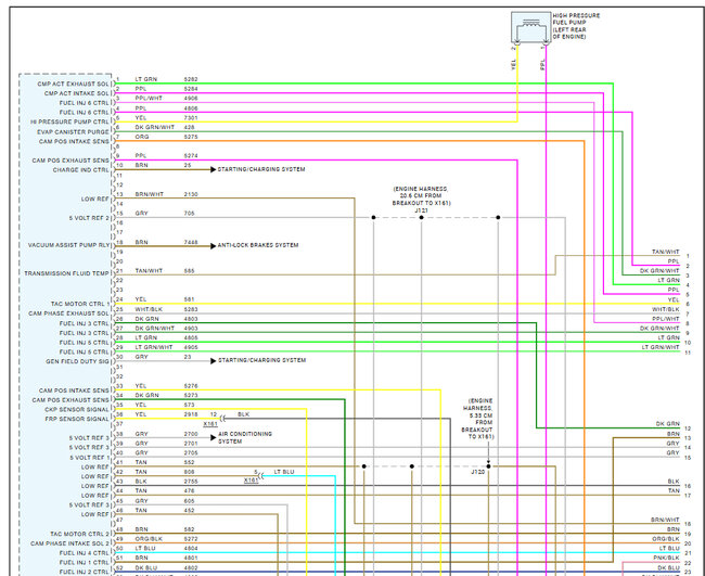

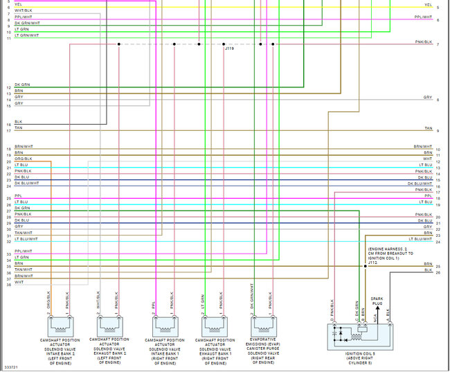

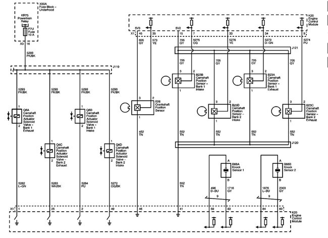

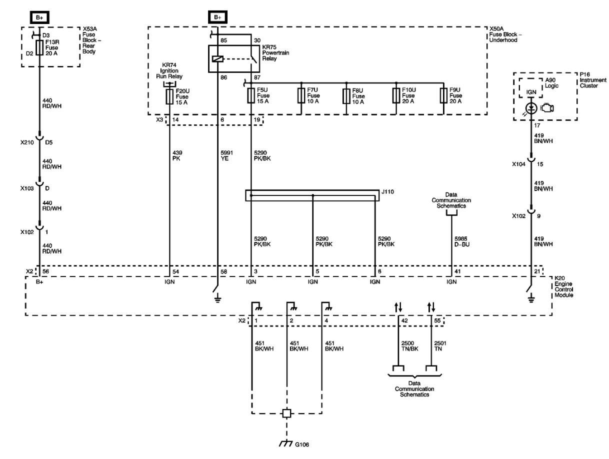

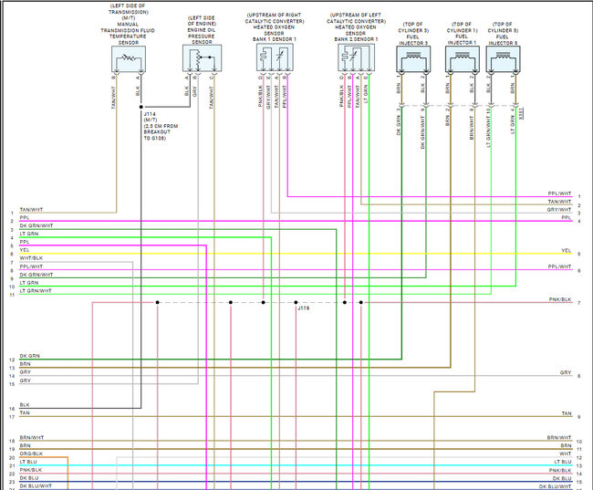

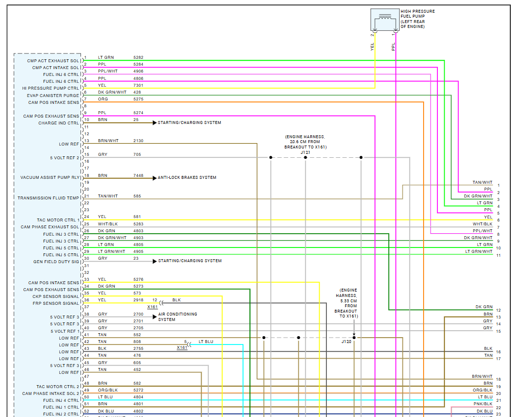

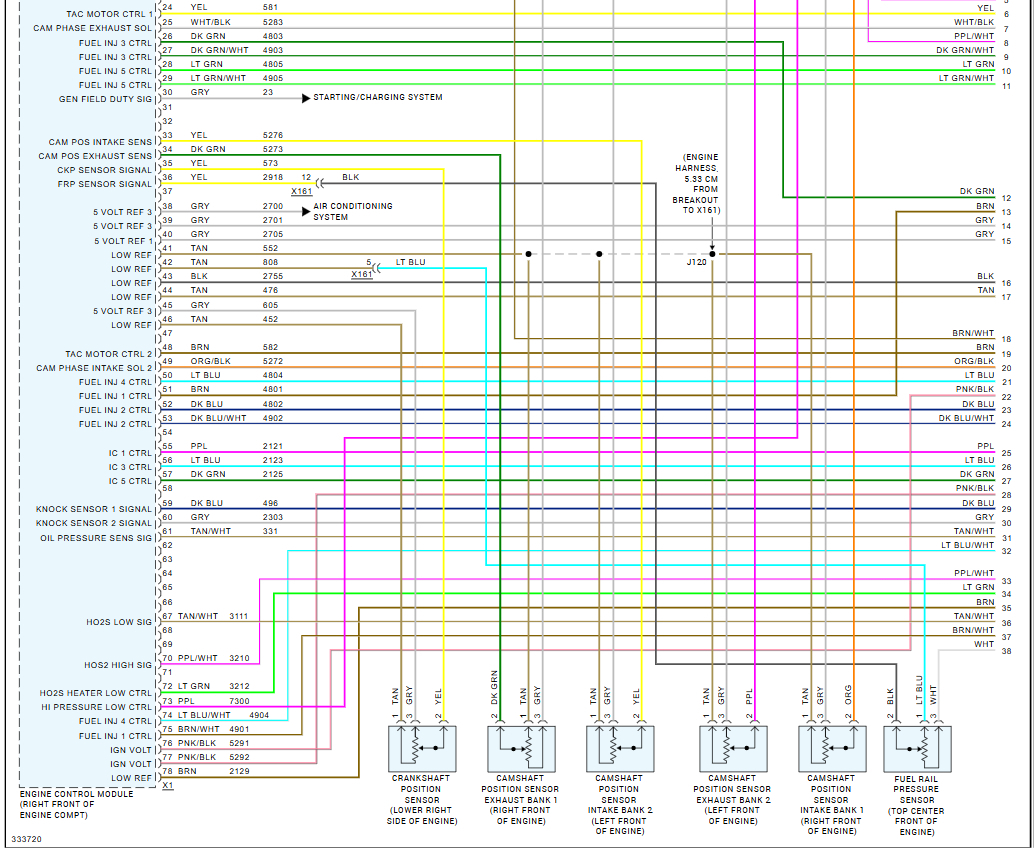

A common reason for a high voltage is if the sensors have a bad ground. To test this, you can test the gray wire for 5 volts and then the tan wire for a ground. If you don't find a good ground, then you will need to go to the PCM and test the grounds there as well. Attached are the wiring diagrams showing the various grounds and powers for the ECU and sensors.

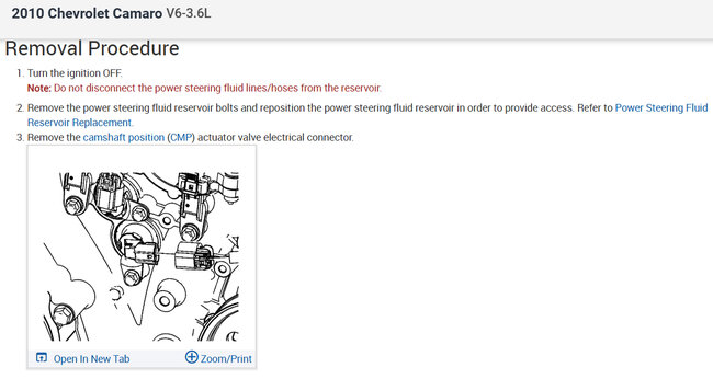

A "Circuit High" code is the camshaft is too far advanced so I would replace the camshaft actuator control valve it may not be releasing. Has the engine had this code since the new engine, and when you say new do you mean a create engine from GM?

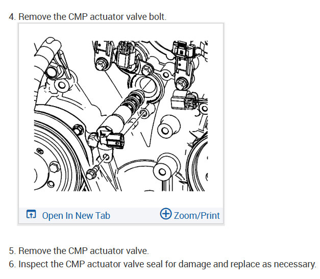

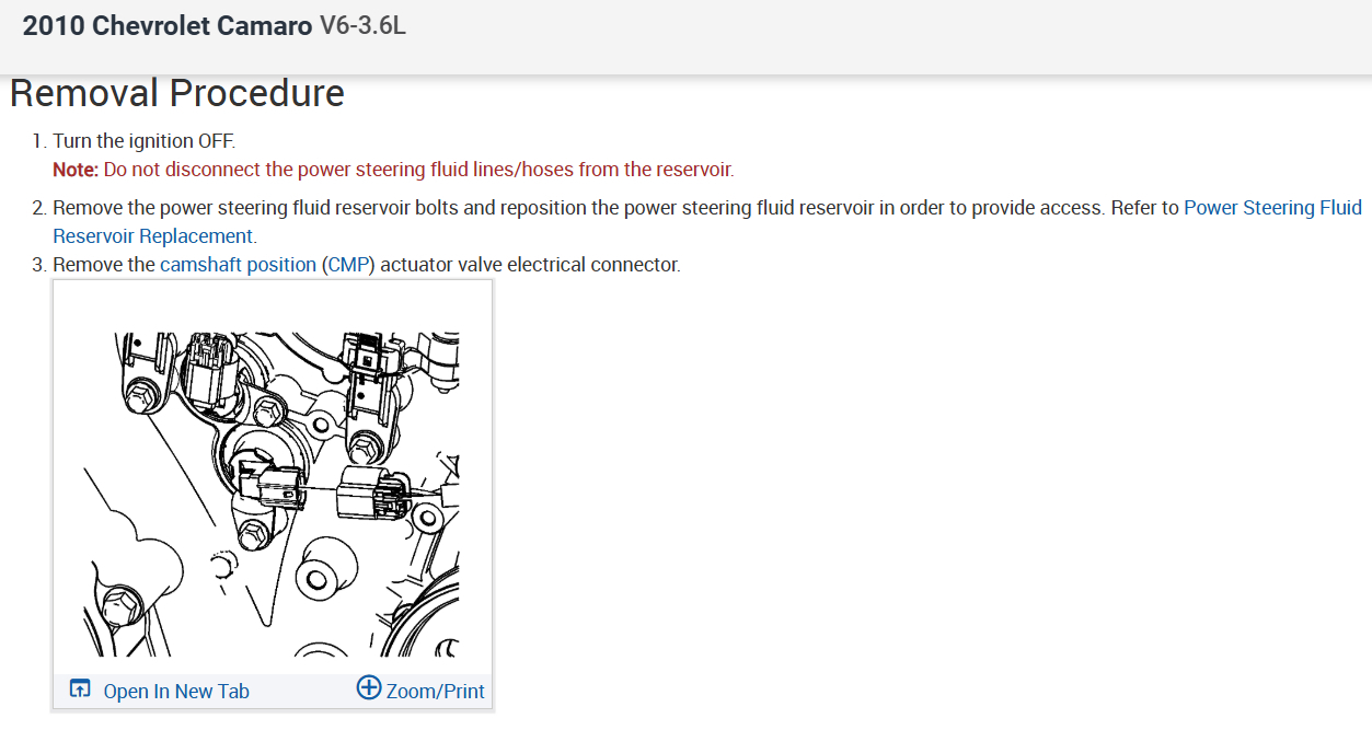

  • 55,224 POSTS
Sounds good, here is a guide to help you check the wiring and the wiring diagrams for the camshaft sensors and oil control valves.
Check out the images (below). Let us know what you find.
