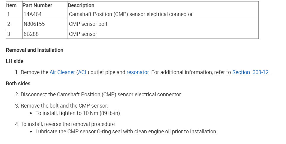

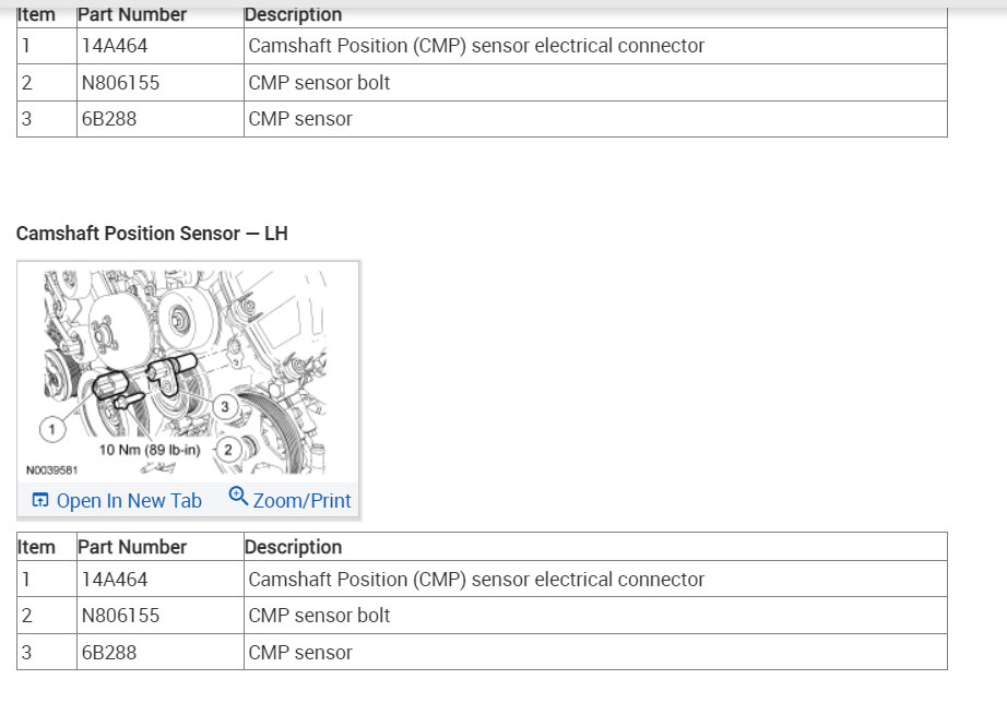

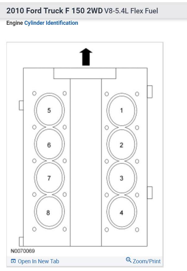

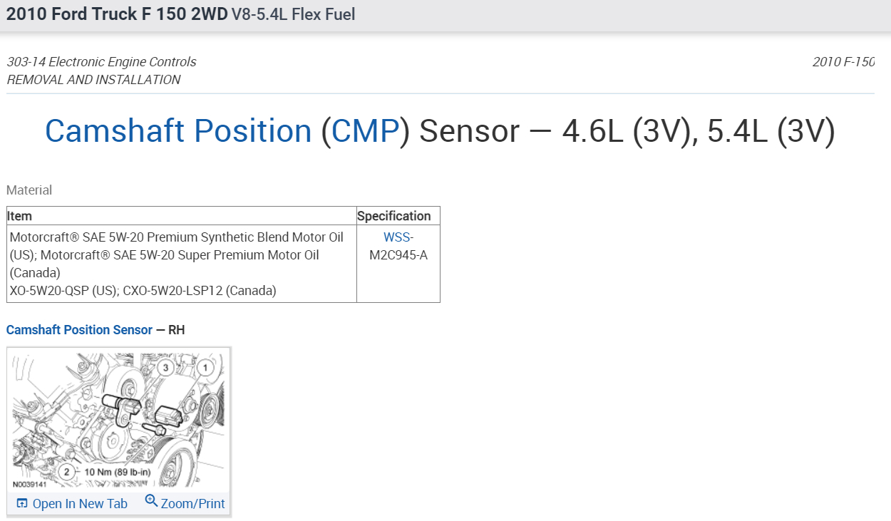

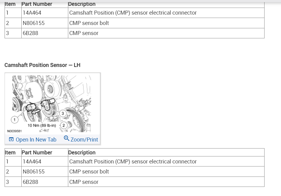

looking for the location of this camshaft sensor, Bank 2.
Sep 25, 2023 at 4:32 AM
  • 55,694 POSTS
Yep, bank 2 is on the driver's side and the camshaft sensors are on the front of the cylinder head. Here are the locations and how to change them out feature below. Check out the images (below). Please let us know if you need anything else to get the problem fixed.
