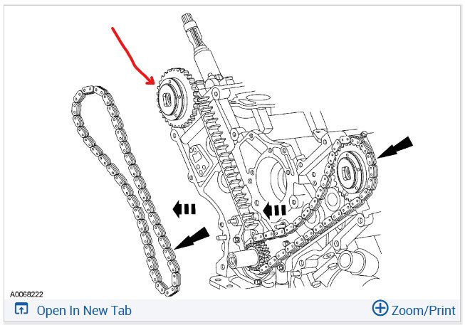

Yep, the dreaded camshaft sensor codes, these codes mean the timing chain/camshaft actuators are having an issue. I would make sure the engine oil is clean and full. Next, at idle does the engine make a slight rattling sound? If so this will be the problem, and with that many miles the components are worn out.
P0345 - Camshaft Position Sensor “A” Circuit Bank 2
P0349 - Camshaft Position Sensor “A” Circuit Intermittent Bank 2
Here is what needs to be replaced, also watch this video to show you how as well.
https://www.youtube.com/watch?v=dler2t2e4Zw&t
Check out the images (below). Let us know how it goes.

When they did the camshaft actuator, did they replace the timing chain, tensioner and guides? On the video you just watched, it is the guide that broke which prompted the engine rebuild. This will cause the codes you now have. The speaker and AC issues are not related to this problem.
