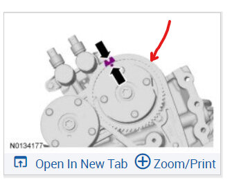

The error code P0344 on your 2014 Ford Flex indicates an issue with the Camshaft Position Sensor A Circuit Intermittent in Bank 1 or a Single Sensor.
Here is the location of the sensors so you can check it out or see what needs to be done to fix the problem. Bank 1 is on the right side of the engine as you sit in the driver's seat. If the oil is clean and full and the sensors are okay the camshaft phaser will need to be changed out, which I will included as well if you want to see how the job is done. Check out the images (below). Let us know how it goes.
Jan 2, 2024 at 3:07 AM

Yep, that will cause the codes. With no oil the engine might be seized. To tell for sure this guide can help us:

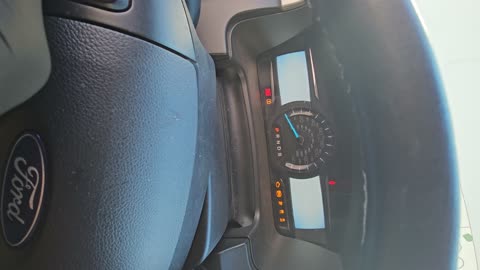

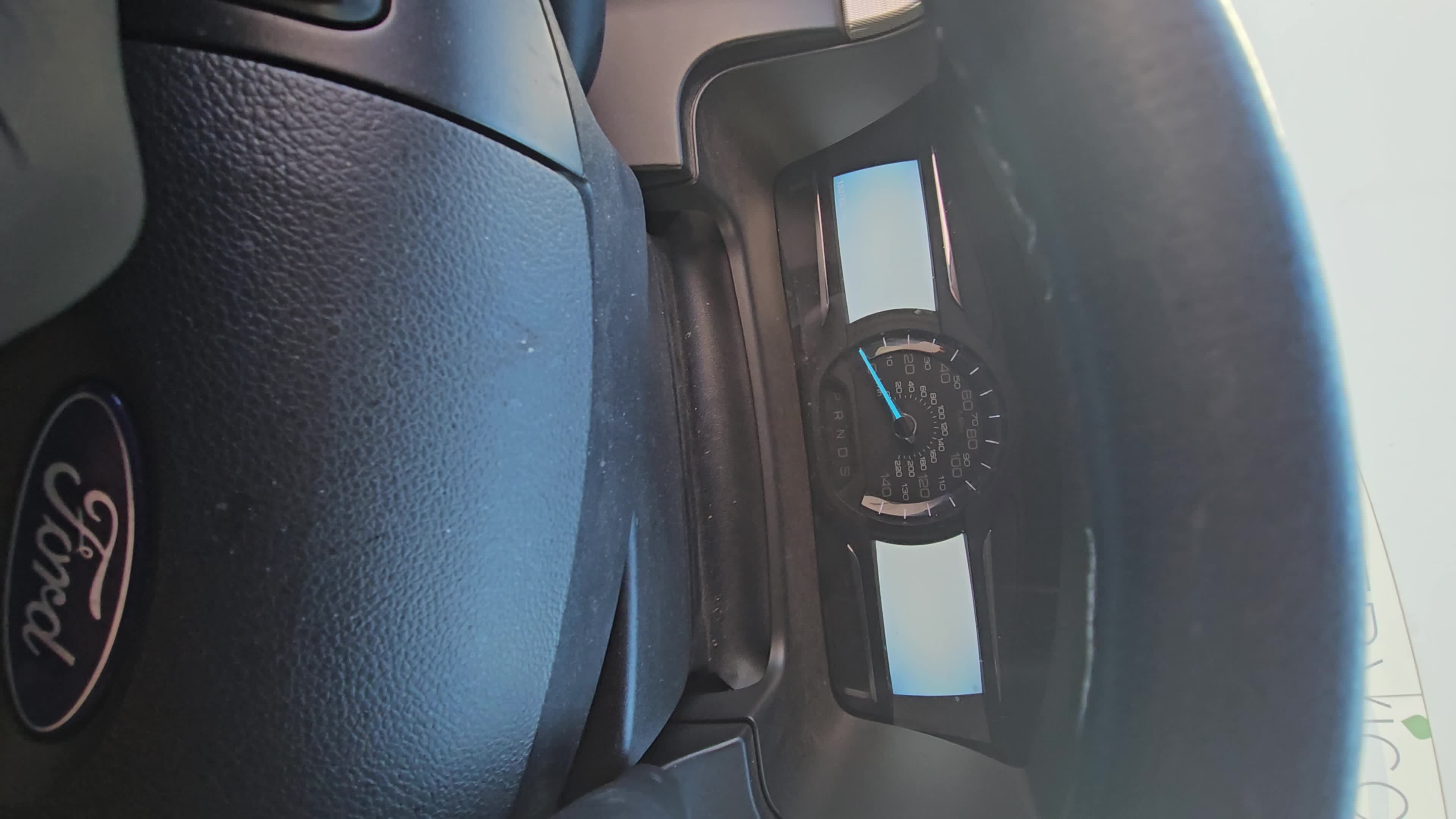

Okay, I just got here, here are the videos.
Jan 5, 2024 at 5:12 AM
PAUL-82
  • 9 POSTS
There is 1.
Jan 5, 2024 at 5:16 AM
  • 55,224 POSTS
Looks like the battery is dead, I would remove it and take it to the auto parts store for testing. Here is a generic guide to help you step by step with instructions in the diagrams below to show you how on your car:
https://www.2carpros.com/articles/how-to-replace-a-car-battery
Check out the images (below). Let us know what you find.
Jan 7, 2024 at 1:56 AM
