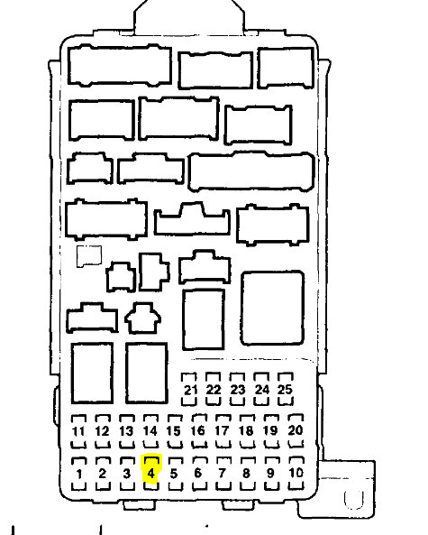

Started drove 1/4 mile or less, off for 10 minutes, tried start, wouldn’t, feathered gas pedal, got started, running very rough, hard to keep running.
Won’t idle had towed home.
Spark plugs black, replaced, hard to start, runs rough, shuts off, replaced coils, camshaft position sensors 2. Checked VDC, good, still same.
Dec 14, 2023 at 5:38 AM
  • 110,240 POSTS
That's a lot of codes. LOL Have you checked the Number 4ACG (10 A) fuse in the under-dash fuse/relay box? If not, do that first and let me know what you find.
When you check it, also make sure power is present to and from it.
Let me know what you find.
See pic below.
