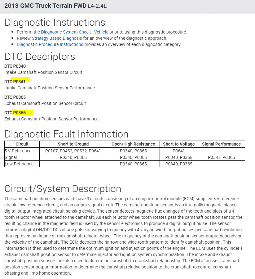

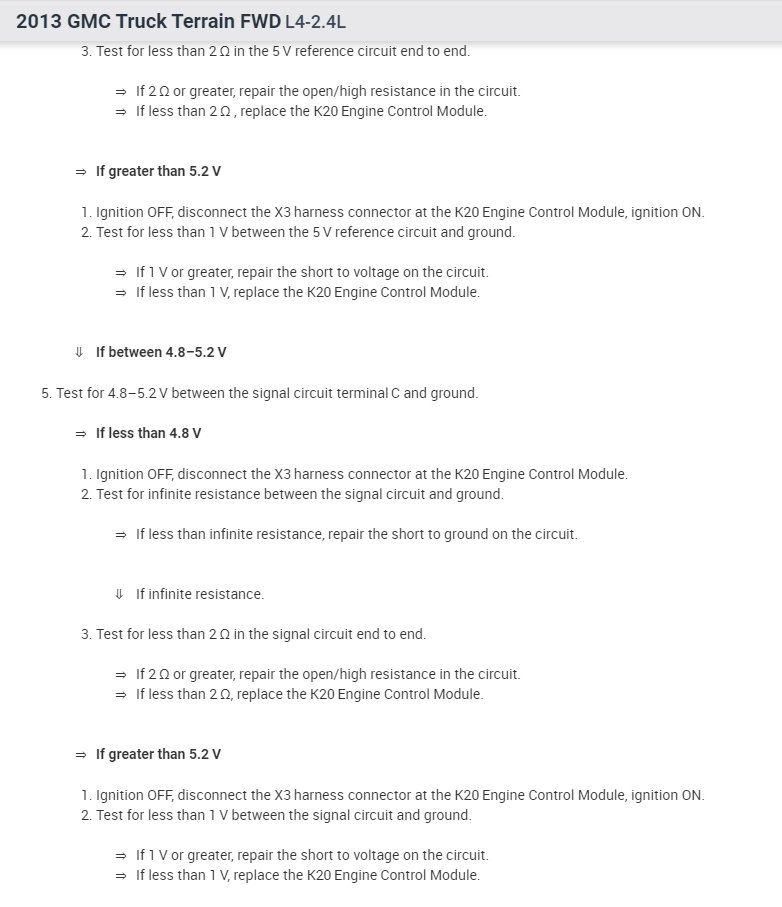

Shut off while driving, codes P0341 and p0366
2013 GMC TERRAIN
146,000 MILES • 2.4L • 2WD • AUTOMATIC
TFRIEDLINE1990
Replaced camshaft sensors but car still will not start, and codes still show on code reader. Any help?
Jun 30, 2022 at 8:44 AM
SQM
  • 6,383 POSTS

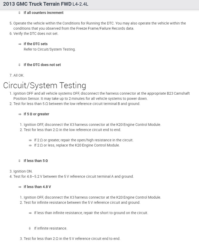

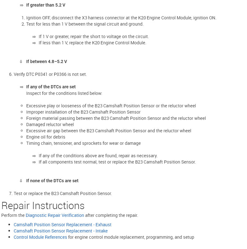

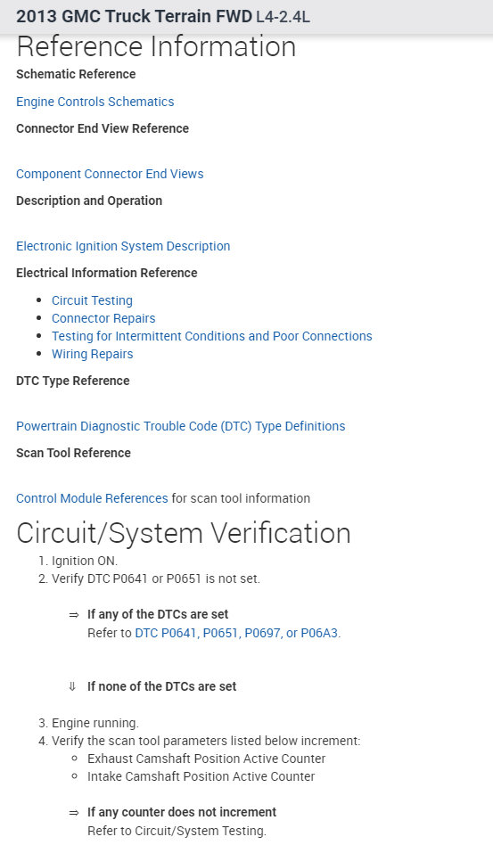

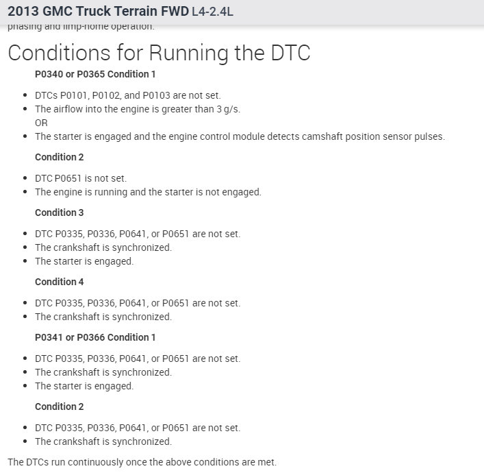

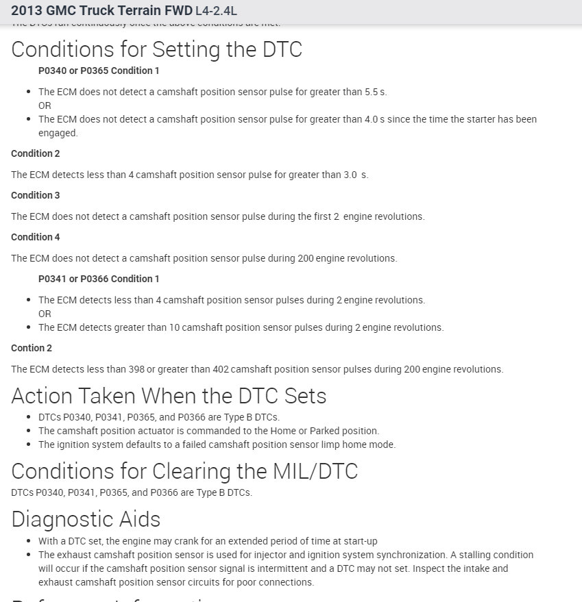

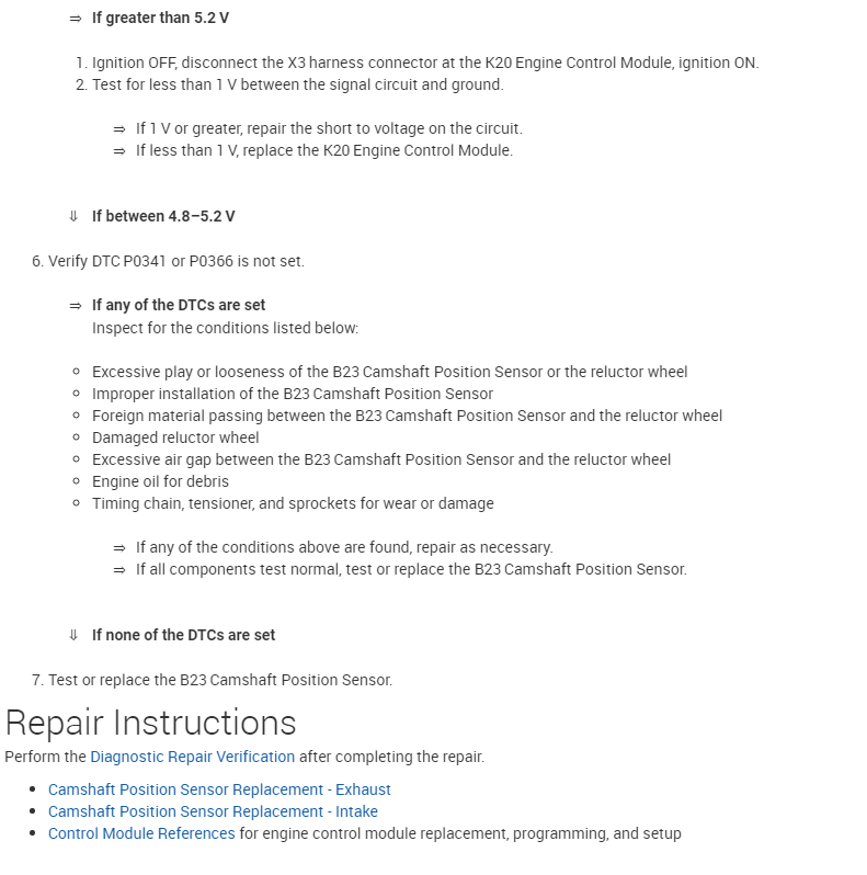

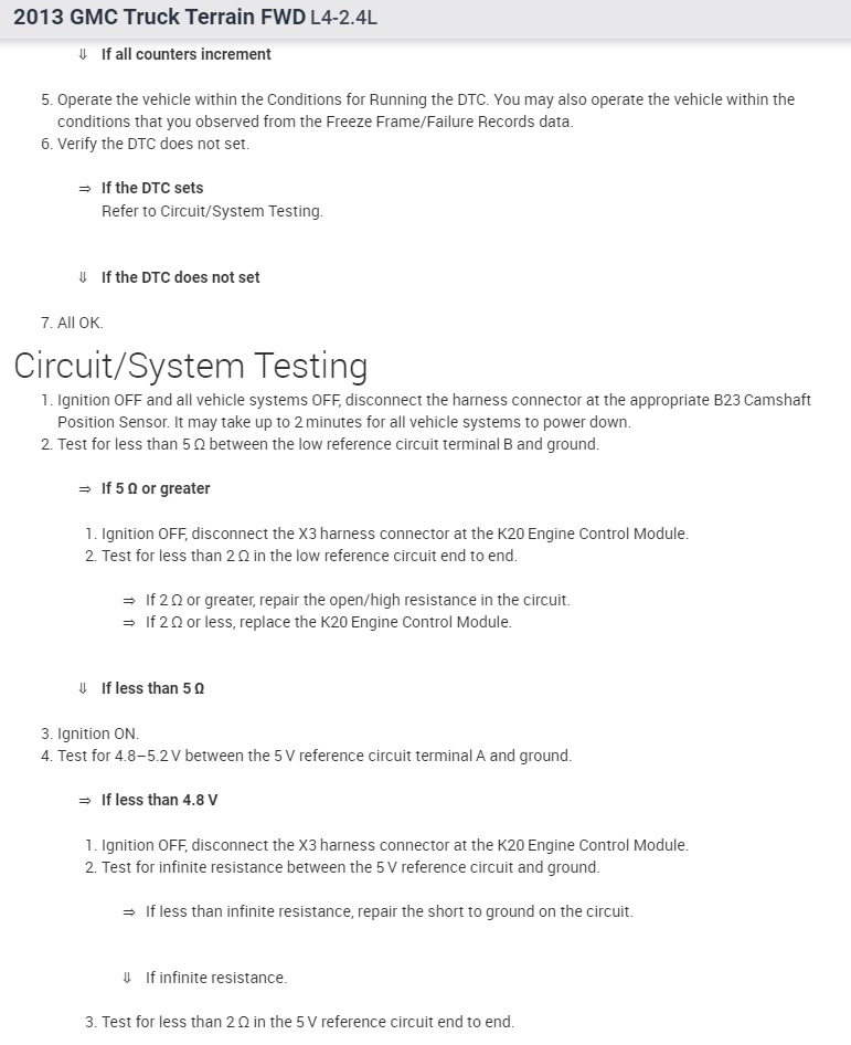

If the camshaft signal is intermittent, it can stall the engine. Keep in mind that this could be due to wiring issues for the sensor. Many times corroded connectors can cause this problem.
I have attached the troubleshooting guide for the codes below.
It can help you determine the issue.
Let me know of any questions.
