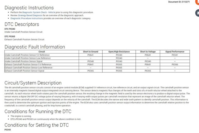

My check engine light came on and I got a code for the camshaft position sensor. So I replaced both, but the light is still on and the car is sputtering and stalling.
Apr 3, 2021 at 5:31 AM
Good evening,

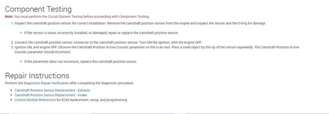

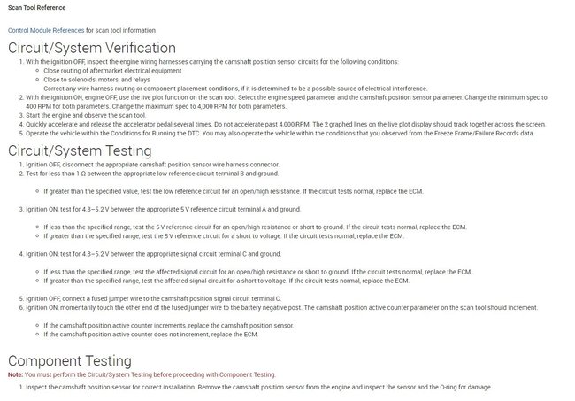

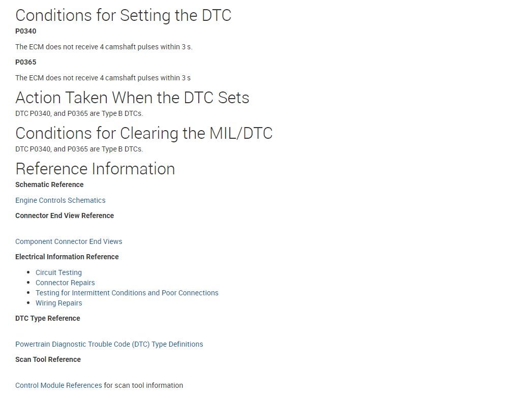

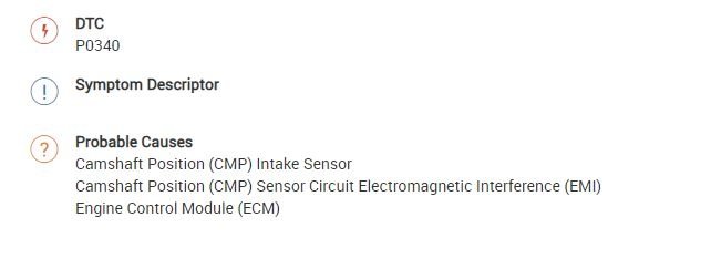

I attached the flow chart for the code below and possible failures.
https://www.2carpros.com/articles/camshaft-angle-sensor-replacement

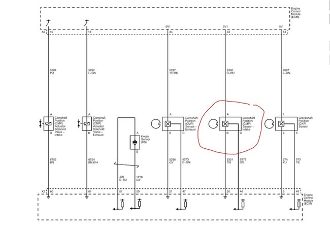

I also attached a wiring diagram. You need to verify the 5-volt reference signal to the sensor for operation.
