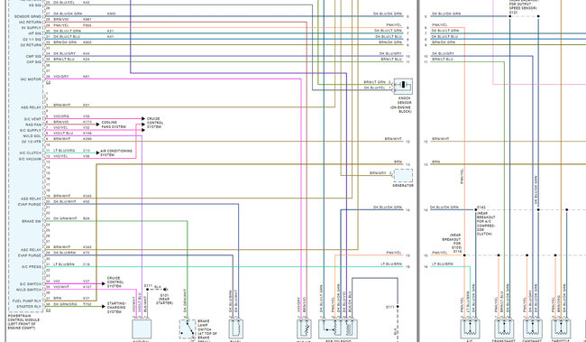

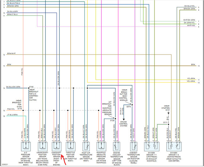

  • 54,837 POSTS
The cam sensor on this engine is a Hall-effect sensor, NOT a variable-reluctance (AC) type. So the signal is not a sweeping AC voltage - it’s a digital ON/OFF (square-wave) pattern sent back to the PCM. If you want to test the wiring here is the wiring diagram and I will email it to you as well.
Check out the images (below). Let us know how it goes

MALLYBOY
  • 329 POSTS
I have check the camshaft sensor wiring and it is not short at any point, the wiring was ok, Then I notice from the daydream that Map sensor was reading 0.00G/ms instead of 4.57G/me. Can you please send the diagram for manifold absolute pressure sensor for me to check it for short voltage or power?

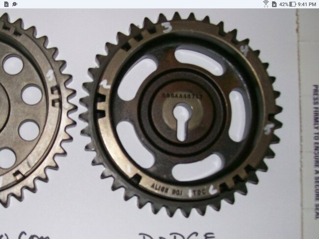

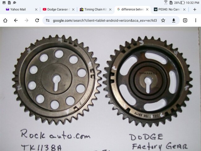

MALLYBOY
  • 329 POSTS
Good day!
Please show me the difference between 3.3 engine camshaft sprocket and 3.8camshaft sprocket using picture before it would be they interchange it with 3.3 camshaft sprocket instead of 3.8 camshaft sprocket thereby causing this problem .. look at these pictures and tell me which one is 3.3 and 3.8, thanks
Dec 8, 2025 at 1:26 PM
  • 54,837 POSTS
It looks like they are two different manufactures. I would count the number of teeth and if they are the same run it. So did you find broken chain guides?
Dec 9, 2025 at 10:47 AM
MALLYBOY
  • 329 POSTS
Thank you so far
So did you find broken chain guides? There's no broken chain.
I have come to tell you that I have solved the problem. The sprocket are not same. I replace the sprocket and it gone.
