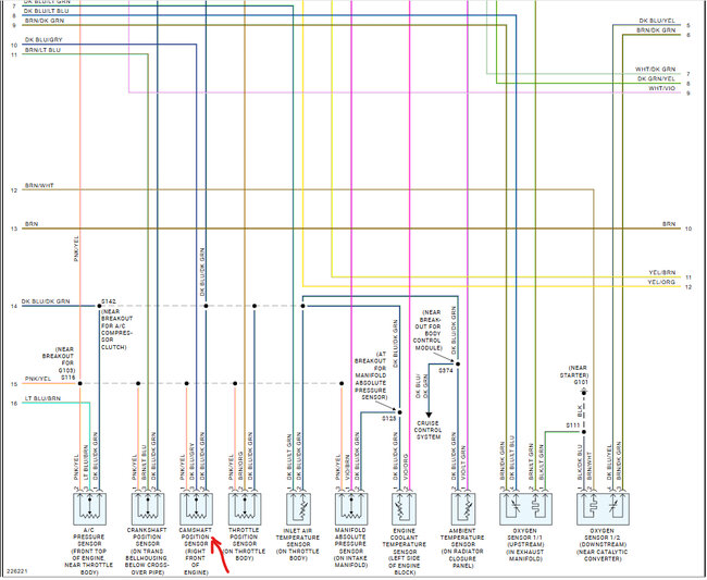

This vehicle started this before I purchase it. I have recheck the timing over and over again but it is was correct. I change Pcm and immobilizer programmed, the code keep coming back.
I replace cam sensor, it didn't solve it. How do I trace the signal circuit of the camshaft sensor to know if it's open or shorted power or ground?

The vehicle cranks,
The vehicle starts. But it does not raise above 2500 rpm. When you diagonize it will indicate P0340: NO CAMSHAFT SENSOR SIGNAL AT PCM. On the signal circuit of the cam sensor, there was 4.91volts present. I bypass the circuit from PCM connector C2-34 to camshaft sensor connector terminal-1, the 5volts still exist. I replace the PCM, the 5volts still exist. Then I go to another car of the same model and I measured the signal circuit with igntion on; engine not running, it reads 40Mv,then I start it and it reads 0.4volts at idling.
So I don't know where the circuit is bridging causing the camshaft sensor no signal. so need help on how to trace the particular circuit causing this problem?

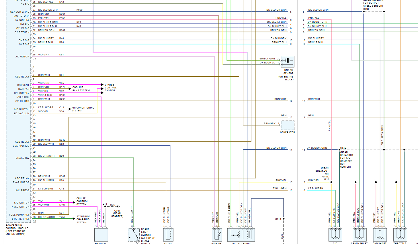

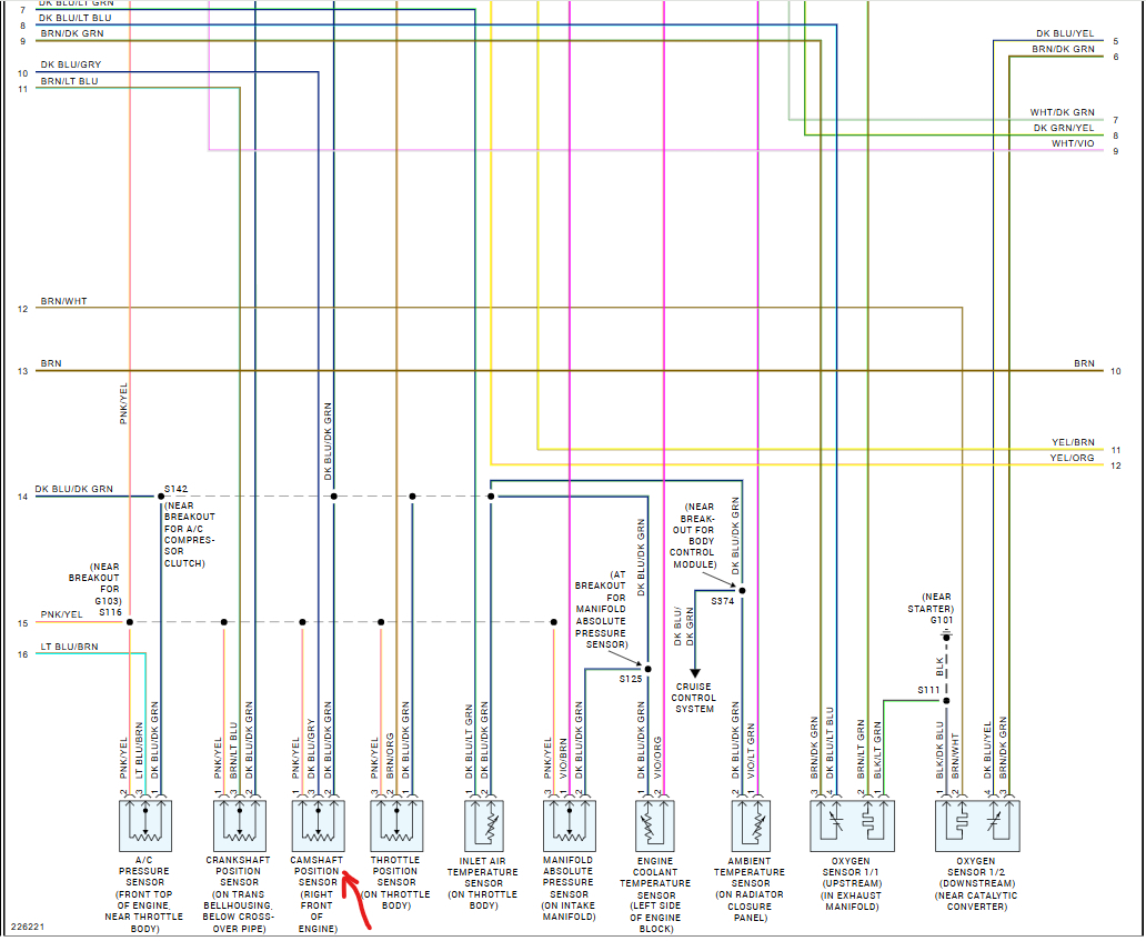

The cam sensor on this engine is a Hall-effect sensor, NOT a variable-reluctance (AC) type. So the signal is not a sweeping AC voltage - it’s a digital ON/OFF (square-wave) pattern sent back to the PCM. If you want to test the wiring here is the wiring diagram and I will email it to you as well.
Check out the images (below). Let us know how it goes
Nov 13, 2025 at 2:44 AM

I have check the camshaft sensor wiring and it is not short at any point, the wiring was ok, Then I notice from the daydream that Map sensor was reading 0.00G/ms instead of 4.57G/me. Can you please send the diagram for manifold absolute pressure sensor for me to check it for short voltage or power?
Nov 27, 2025 at 3:04 AM

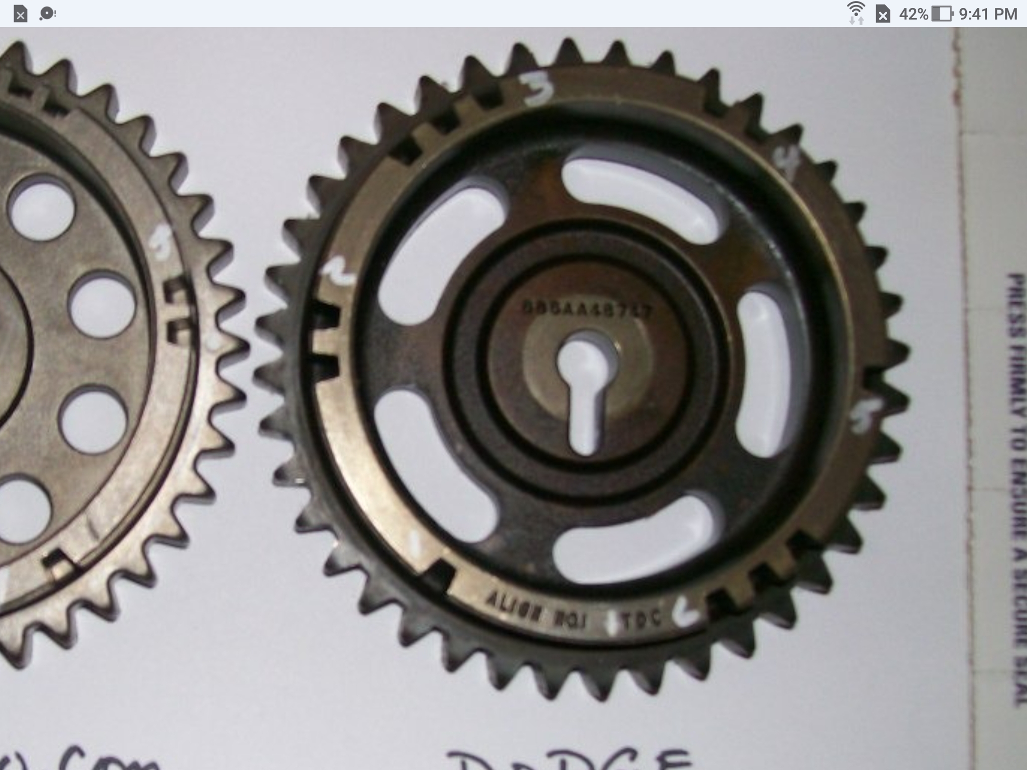

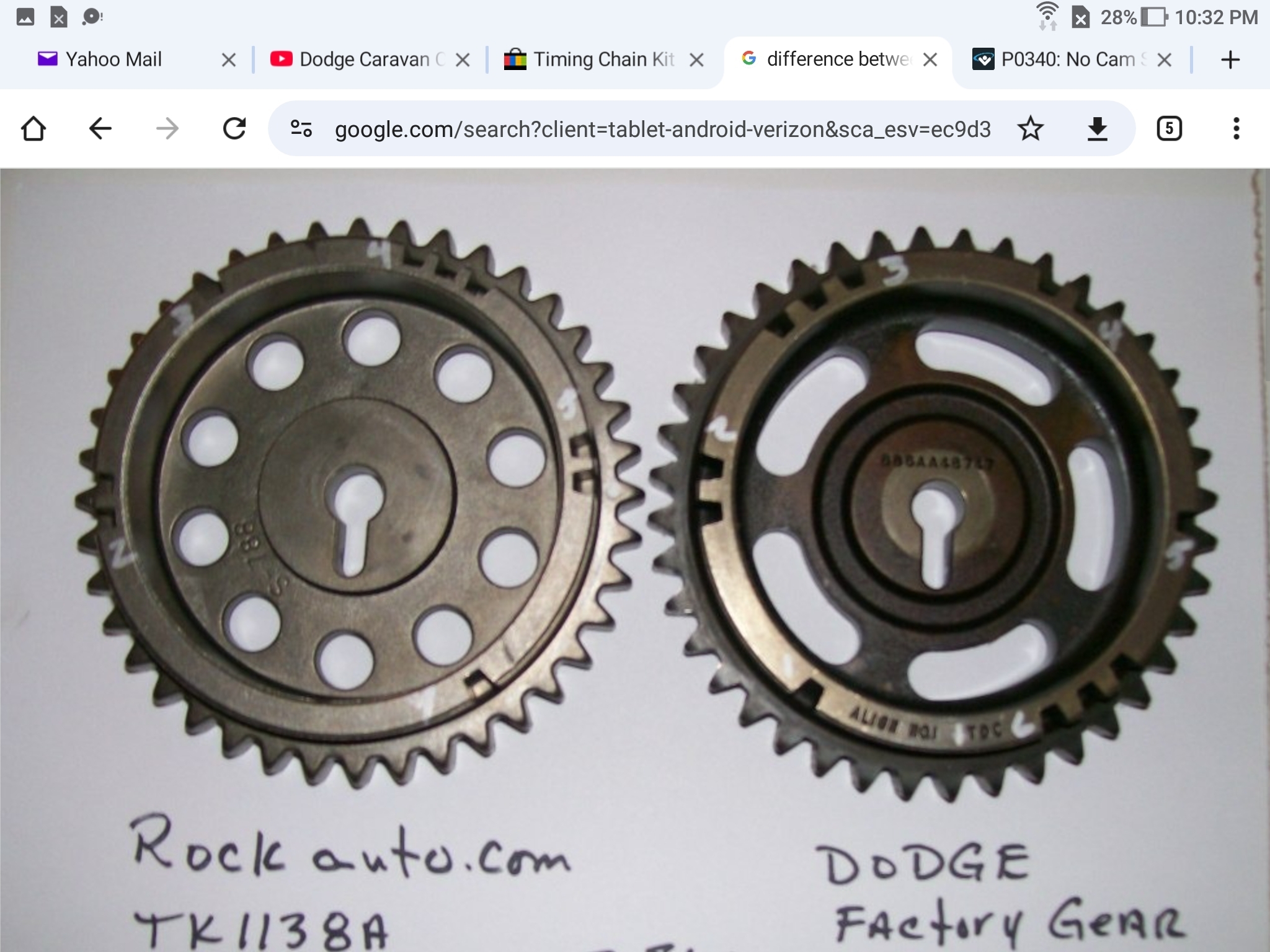

Please show me the difference between 3.3 engine camshaft sprocket and 3.8camshaft sprocket using picture before it would be they interchange it with 3.3 camshaft sprocket instead of 3.8 camshaft sprocket thereby causing this problem .. look at these pictures and tell me which one is 3.3 and 3.8, thanks
Dec 8, 2025 at 5:26 AM
  • 55,433 POSTS
It looks like they are two different manufactures. I would count the number of teeth and if they are the same run it. So did you find broken chain guides?
Dec 9, 2025 at 2:47 AM
MALLYBOY
  • 329 POSTS
Thank you so far
So did you find broken chain guides? There's no broken chain.
I have come to tell you that I have solved the problem. The sprocket are not same. I replace the sprocket and it gone.
