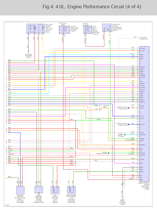

Engine starts when cold . But not hot . Cam and crank sensors replaced. Should i have continuity at all three terminals with power off ? Regards
Mar 25, 2018 at 3:37 AM
  • 55,433 POSTS

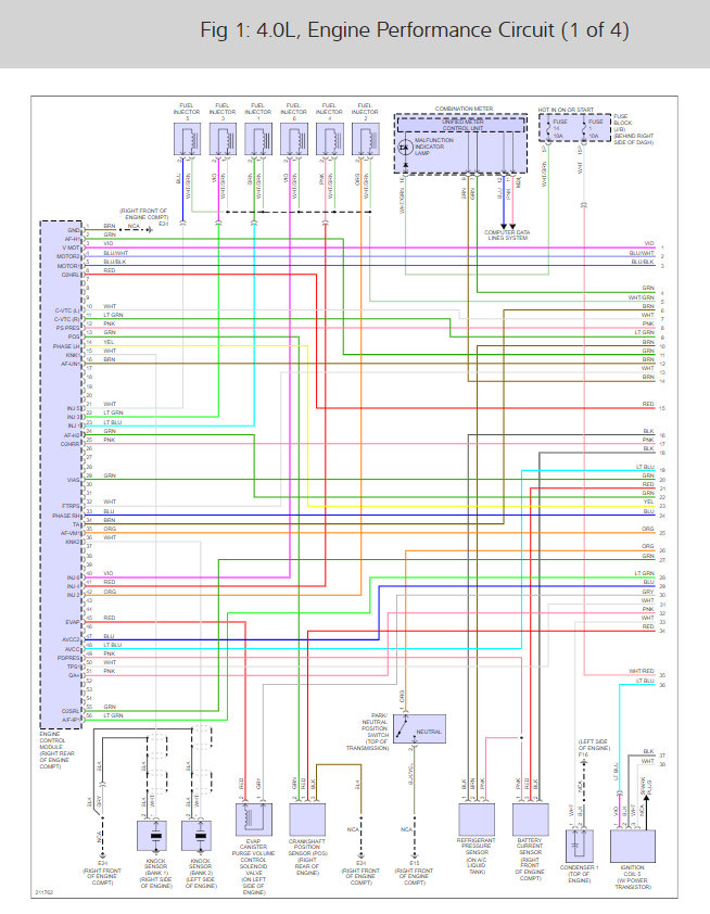

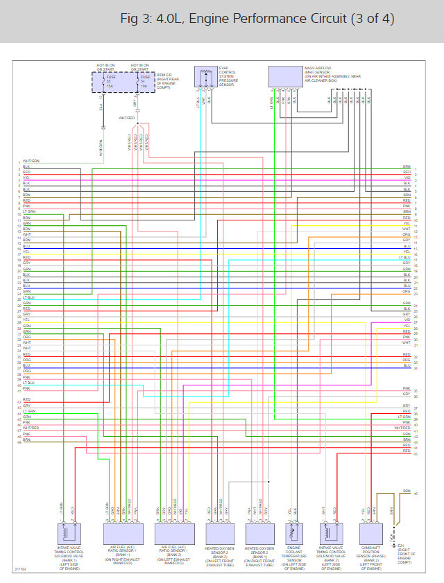

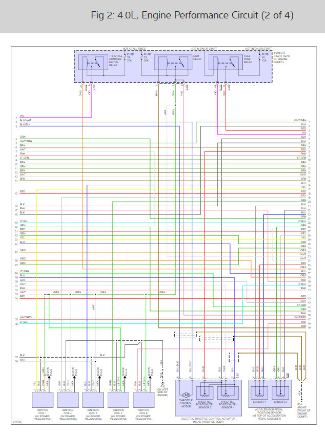

This code is a circuit error for the cam sensor so you must have a bad connection or broken wire. here is a guide to help you see what you are in for when doing the job:
Here are the engine wiring diagrams to help run the test.
Let me know if you need larger diagrams.
