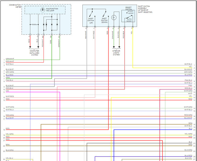

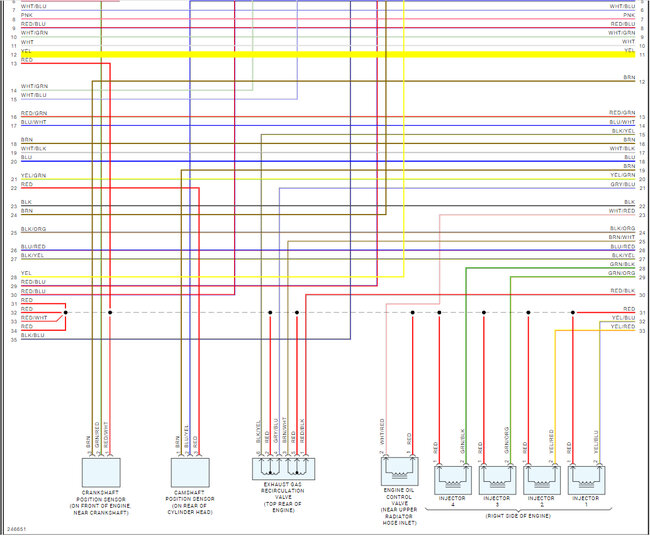

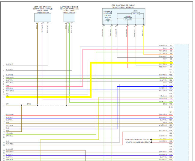

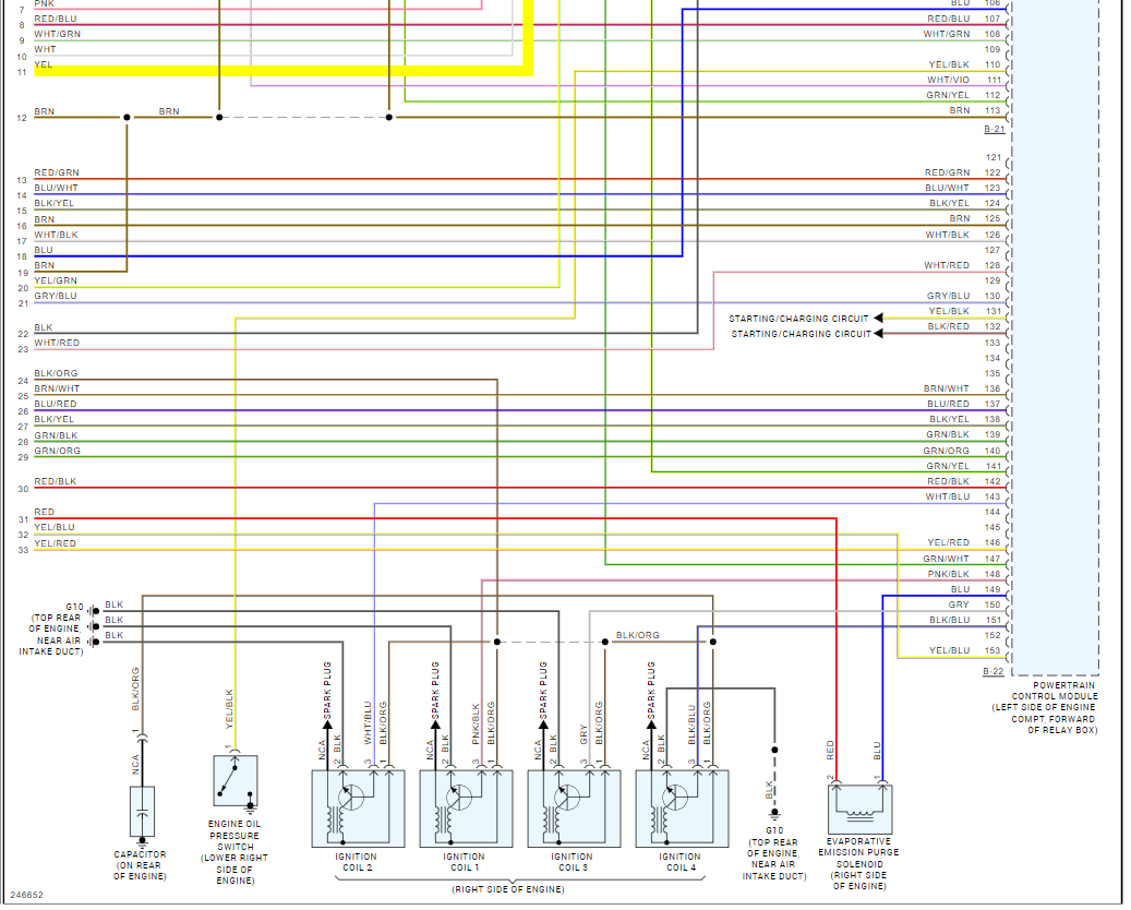

I replaced the crankshaft senor and cam sensor and timing belt still getting this code will not turn over. Plus new plugs and starter.
May 3, 2024 at 12:57 PM
  • 55,710 POSTS

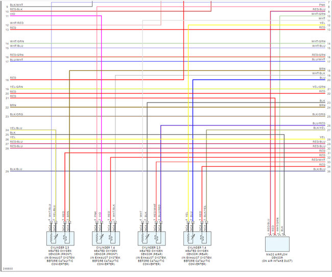

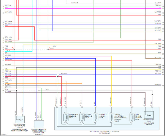

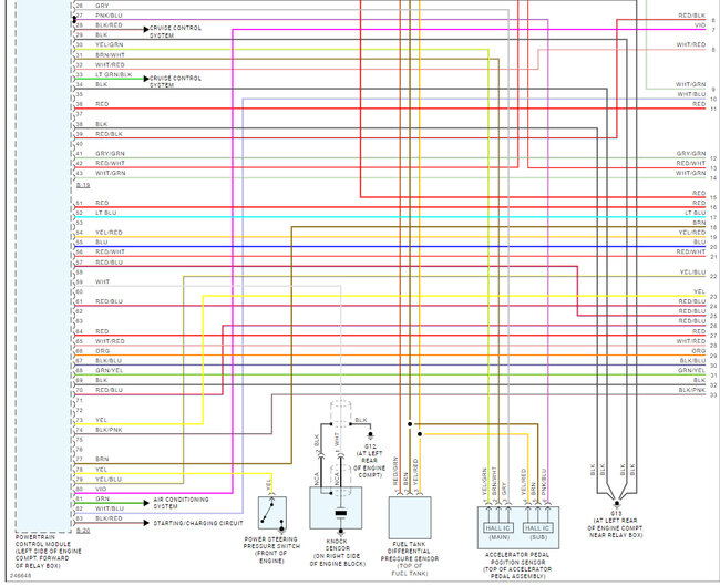

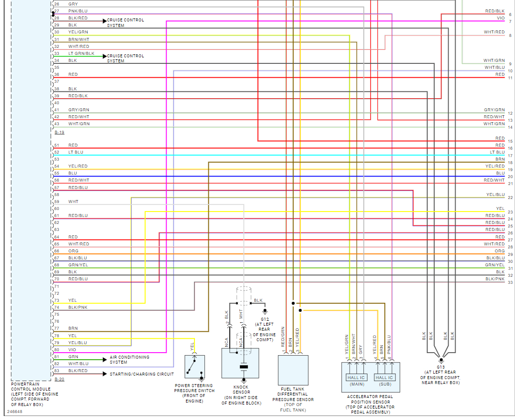

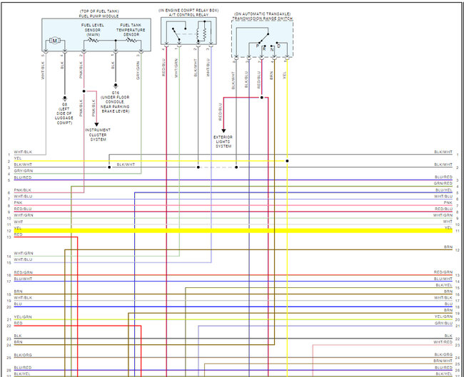

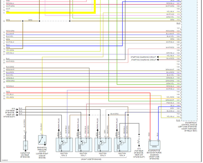

The P0340 trouble code indicates a problem with the Camshaft Position Sensor Circuit. So, I would test the connections back to the PCM, here is a guide to help and the PCM wiring diagrams so well, there should be 0 ohms at each connection with open connections to ground. Test the sensor and PCM disconnected.
Check out the images (below). Please upload pictures or videos in your response to any problems so we can see what to help you with.
