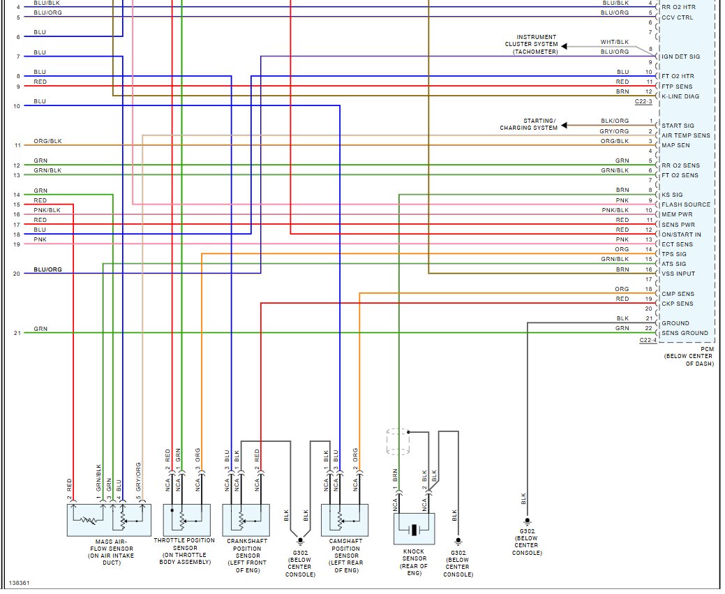

hello my name is yitayal from AFRICA ETHIOPIA Ihave hyundai sana fe 2001 2.4l manual drive it start sute after 3 second i need the wairing digram spicaly the camsensor and the crank sensor to ECU CONNECTION

Diagnostic trouble code P0340 indicates a problem with the camshaft position sensor circuit. But I can tell you it can be the timing chain system and not the sensor problem at all. Does the engine make a rattle noise at idle? This will be the sign the engine timing chains/guides are worn out. This guide can help
https://2carpros.com/articles/camshaft-position-sensor-symptoms/
Here are the wiring diagrams you need, let me know how it goes and if you could can you upload a short video of the engine idling from under the hood?
