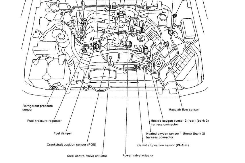

I want to know the exact place where its camshaft sensor is located. since it is not at the back of the cylinder like every other mode. Please help.

That is the only location for the sensor. I attached a general picture of the location. It has to be along where the camshaft turns to pick up the revolutions.from the cam.
Some possible issues for the code.
P0340
Descriptor
Probable Causes
Battery Voltage Low
Camshaft (Intake)
Camshaft Position (CMP) Sensor
Phase Circuit Open or Shorted
Starter Motor
Starting System Circuit

Thanks Roy. from the car it has one each from each side at the front. there was a time the car came up with p1110 and it refers to those front ones. after fixing it it gave P0340,which indicates camshaft sensor. all the videos on YouTube shows it has been at the back of the cylinder for other truck, but this 2001 pathfinder 3.5L does not have any at the back, yet the car goes on and off while driving it. I am frustrated.

But from what I heard and learnt, the 2001 Pathfinder do not have cam sensor at the back like others but only those two fixed at the front. any objection to this?
Feb 5, 2019 at 4:46 PM
Heard from who?
There needs to be a signal for the cam position for the PCM.
Feb 5, 2019 at 6:08 PM
OBEATA
  • 11 POSTS
Okay, if in doubt, please I need the exact location its fixed. I want to change it ASAP. Please help
Feb 5, 2019 at 8:37 PM
I sent you the picture of the location. Both Alldata and Mitchel show the same picture, same location.
