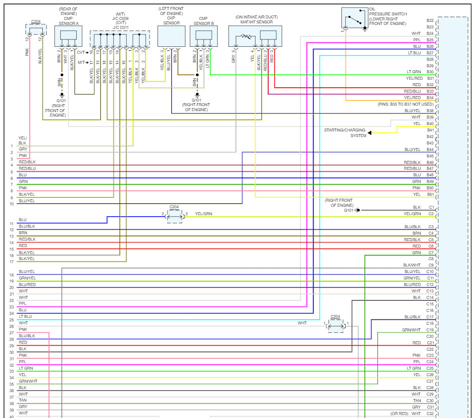

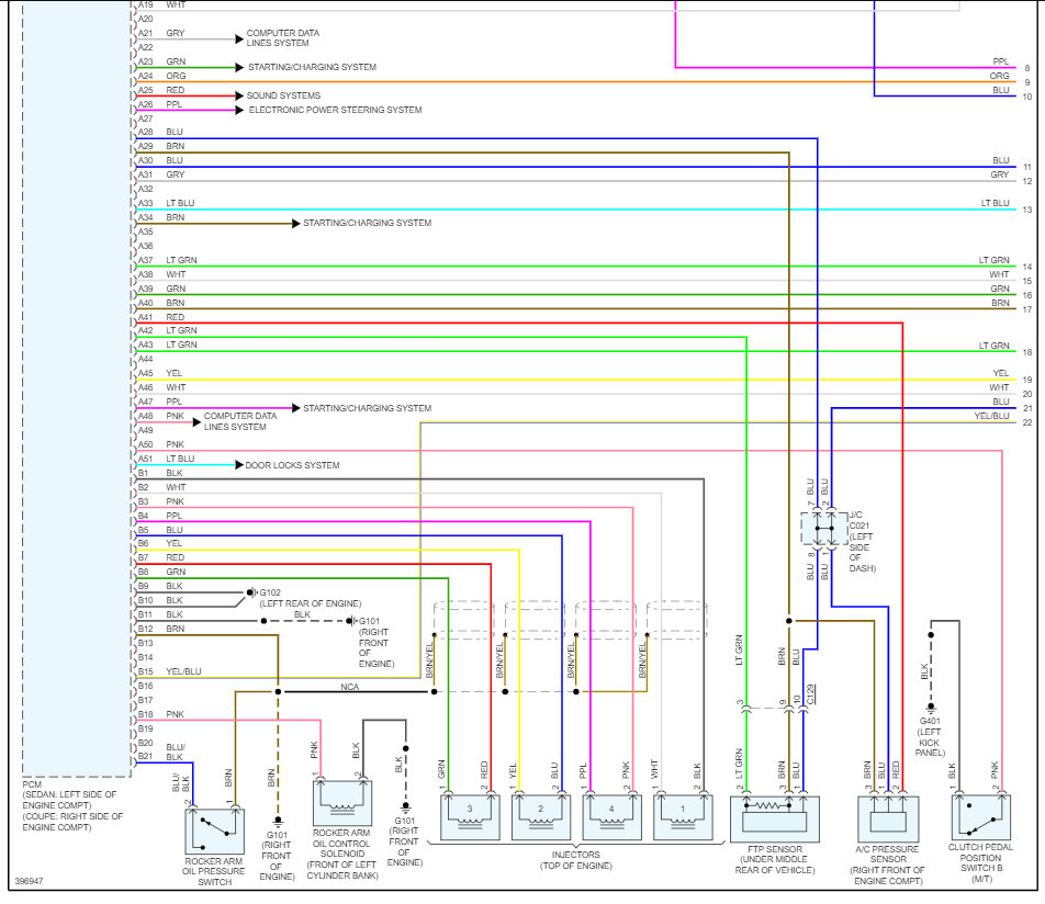

Hello, my vehicle triggered the P0339 error code. At this time, I've changed the sensor, checked the fuse, and inspected the wiring harness link to the sensor. I drove the car around for about 500 miles and tried several different driving sequences that I read about online. But the code still remains. I have no noticeable issue with the vehicle. Starts right up, does not stall or feel like there's any loss of power. Smog test is due and my concern is that the smog won't pass and that there may be some other issue with my vehicles. Any trouble shooting ideas i can try / inspect? Thanks for your help.
Oct 23, 2023 at 1:09 AM
  • 55,686 POSTS

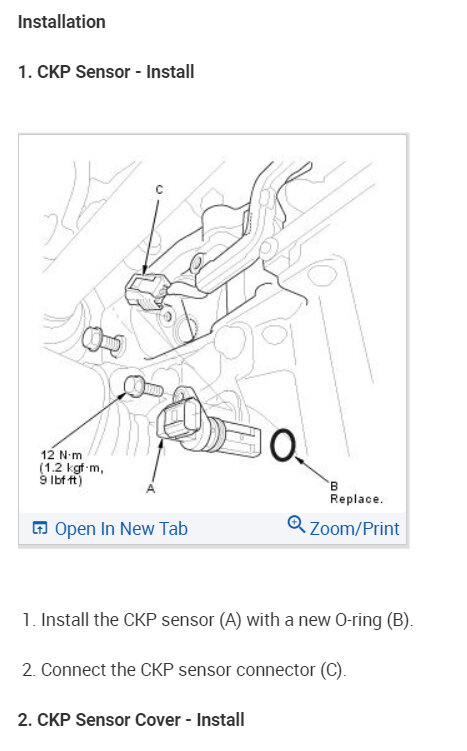

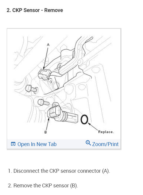

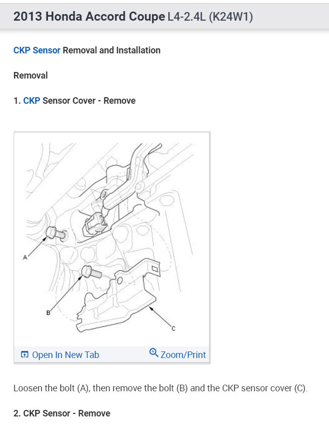

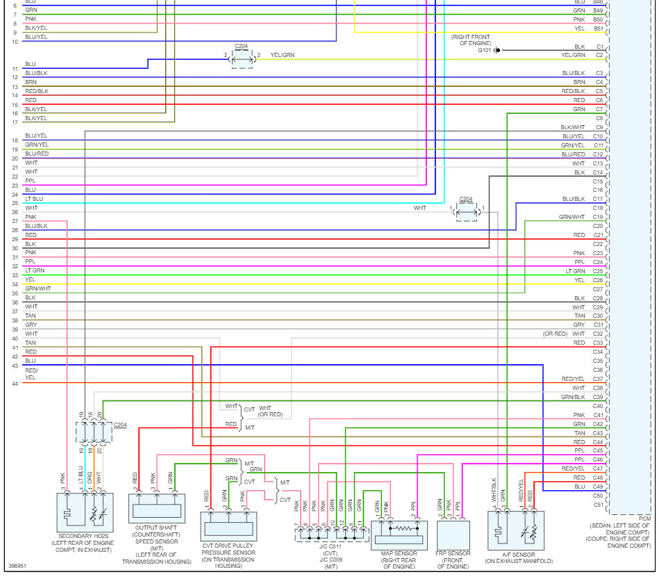

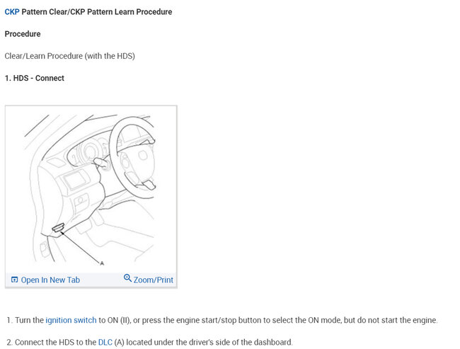

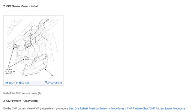

The error code P0339 in vehicles, including a 2013 Honda Accord, generally stands for "Crankshaft Position Sensor 'A' Circuit Intermittent."

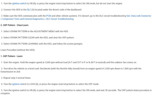

I have also included the location of the crankshaft sensor to make sure we are on the same page and how to do the sensor relearn procedure as well. Check out the images (below). Please let us know what happens.

Thank you for your help and reply. Question, in order to clear and reset crankshaft sensors. Is this software or scan tool something i can purchase? Maybe find it on Amazon? Thank you for your help :).
