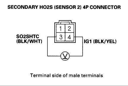

I recently bought a car with a bad timing belt, I replaced the timing belt, water pump and tensioner. Since I already had it apart I felt it prudent to replace the camshaft sensor and the crankshaft sensor at the this time. Removed the intake manifold and cleaned out the EGR channel. Now I am getting the codes:
P0336 crankshaft position "A" circuit range/performance.
P0141 02 sensor heater circuit
P0300 random/multiple misfire
Misfire codes for cylinder 1,2,3,4
What could be the problem?
Thank you
Oct 8, 2016 at 12:35 PM
JIS001
  • 3,412 POSTS
Recheck your timing belt marks and verify everything lines up. If all is good then depending on the brand sensor you bought, it could be defective. If timing is not correct that could cause the random misfire. this guide can help us fix it
On a side not. When you got the vehicle was the timing belt broken? If it was then some valves could have bent? Once you verify your timing is correct I would recommend you do a compression check.
PO141 oxygen sensor heater circuit. Verify power and ground are good on rear oxygen sensor (behinde catalytic converter) That will be pins #3 and #4 see diagram below. Using a test light connected to those two pins key on engine off it should light up. If it does your good and you will need to replace the rear oxygen sensor.
I strongly recommend you replace the sensor with a Denso brand or preferably a dealer one for the simple fact the resistance on the heater is too high on other brand sensors that your light will return.
So check those things out and keep us posted please.

In response to JIS001, I checked the 02 sensor as you suggested but connecting #3 and #4 connections the test light does not light up, checked the #4 fuse and it looks fine, so I'm not getting ground somewhere?
Oct 27, 2016 at 12:49 AM
JIS001
  • 3,412 POSTS
Check pin #4 for battery viltage. Pin 3 is the control circuit. So depends when the computer actually turns it on. Majority of the problem is the sensor. Only time I have seen a computer problem was because they swapped engine with harness but not the computer for that engine so pin configeration was different.
