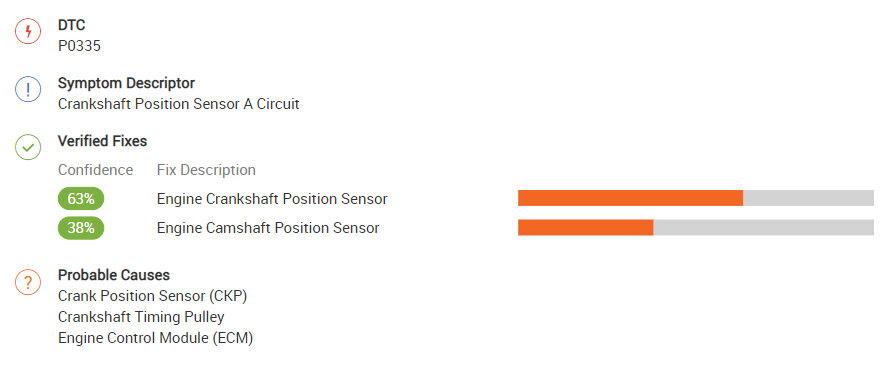

The code is related to the crankshaft position sensor. I don't feel the vehicle stability control is connected other than the computer is shutting it down.
The code P0335, is specific. It indicates there is no crankshaft position sensor signal. I would start by either testing or replacing the sensor and see if that helps. In most cases, it is a faulty sensor. see pic below.
Let me know your thoughts.
See pic below.

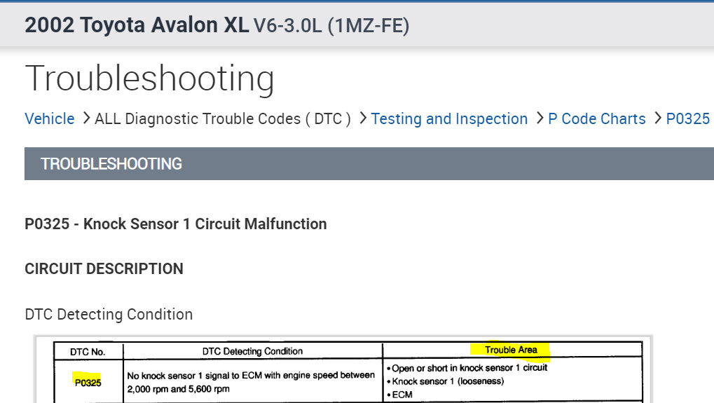

Oh, shoot, I'm sorry, it's not p0335, it's p0325 - knock sensor 1.
Nov 14, 2022 at 2:25 PM
  • 110,240 POSTS
No problem whatsoever. LOL It happens to all of us.
Yep, the 325 is the knock sensor. To be more specific, there is no signal from it. However, I don't feel that it is tied into the VSC. I guess indirectly, there could be an issue within the ECM that is setting both, but it's unlikely.
A knock sensor is used to finetune the ignition timing. With the code you have, it could be caused by a few things. See pic 1 below.
Is this the only code present? Do you have any misfire codes? Is the ABS light turning on?
See pic below.
