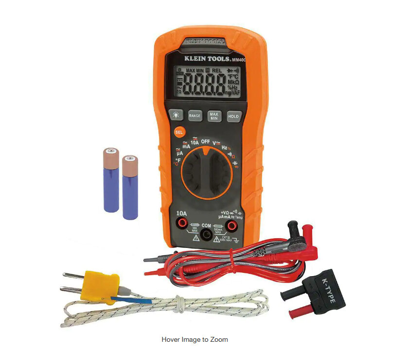

You will need a multi-meter or DVOM. If you don't have one, Klien makes a good one that you can pick up at The Home Depot. I will add an image for you in case you need it.
Here is the link to a pretty decent one for $60:
https://www.homedepot.com/p/Klein-Tools-600V-Auto-Ranging-Digital-Multimeter-MM400/206517333#overlay
