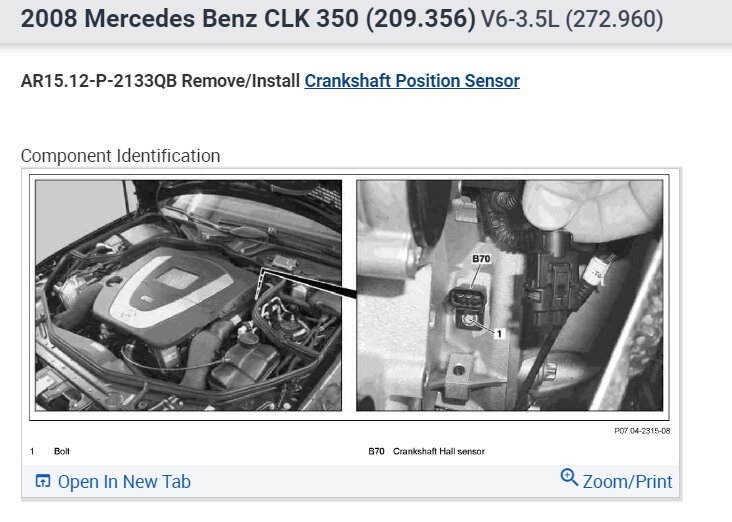

Code P0335? Crankshaft position sensor a circuit malfunction?
2008 MERCEDES BENZ CLK 350
10,500 MILES
ANTHONY MCNAIR
Same as p0018 but this code is p0335. Crankshaft position sensor a circuit malfunction, how many or it is the same location, send me pictures, auto store near me 28$,I don't know. Thanks

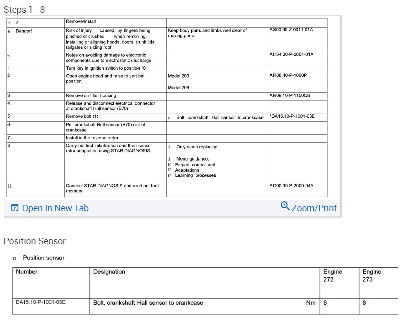

Sure, here is the location of the crankshaft sensor so you can replace it, also after you are done clear the codes. You will need a star scanner to reset the adaptation for the crankshaft sensor. Check out the images (below). Please let us know how it goes.
