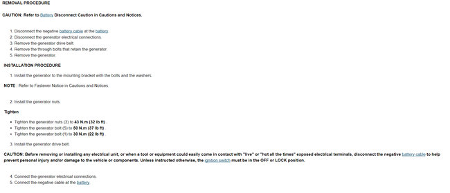

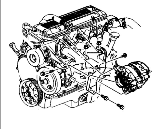

It sounds like you need an alternator and an engine knock sensor. Here is a guide to show you what you are in for when changing the alternator out.
https://www.2carpros.com/articles/how-to-replace-an-alternator
You will need to jack the car up

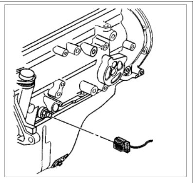

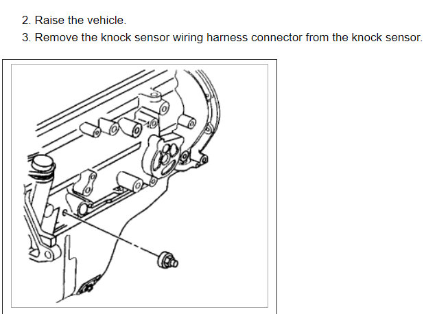

Here are diagrams to help you see what it will be like to change the alternator and knock sensor.
