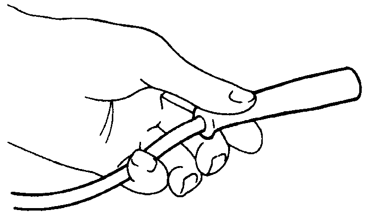

INSPECTION AND CLEANING
1. Disconnect the spark plug cable from the spark plug.
NOTE: Pull on the spark plug cable boot when removing the sparkplug cable, not the cable, as it may be damaged.
pic 1

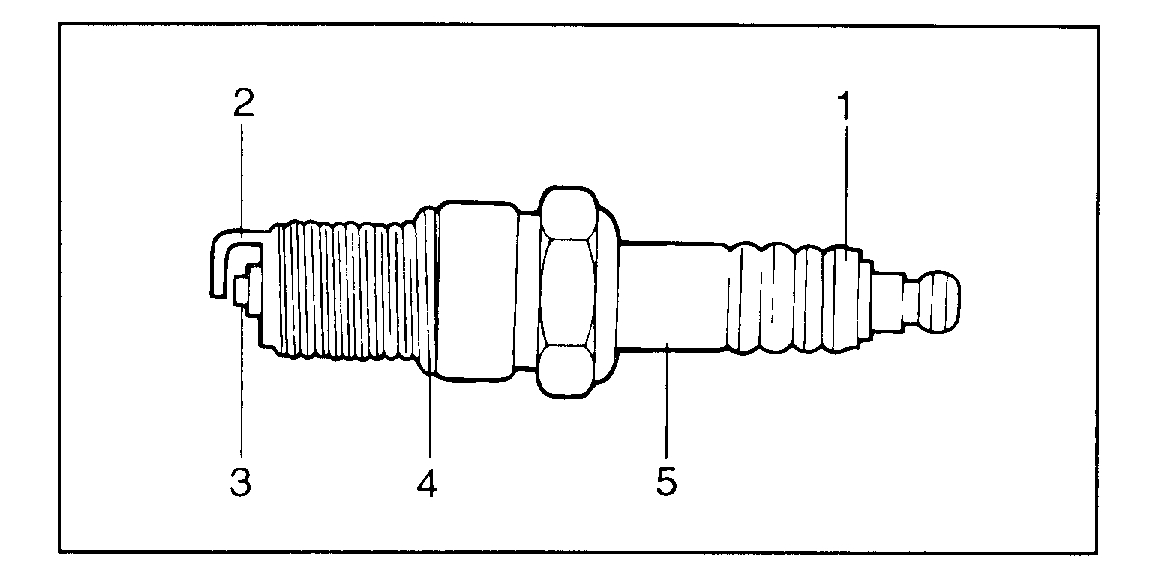

3. Check spark plugs for the following:
1. Broken insulator
2. Worn electrode
3. Carbon deposits
4. Damaged or broken gasket
5. Condition of the porcelain insulator at the tip of the spark plug
pic 3

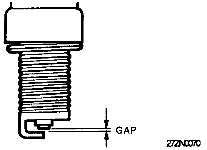

4. Check the spark plug gap using a wire gap gauge, and adjust if necessary.
Standard value
Spark plug gap: 1.0 - 1.1 mm (0.039 - 0.043 in.)

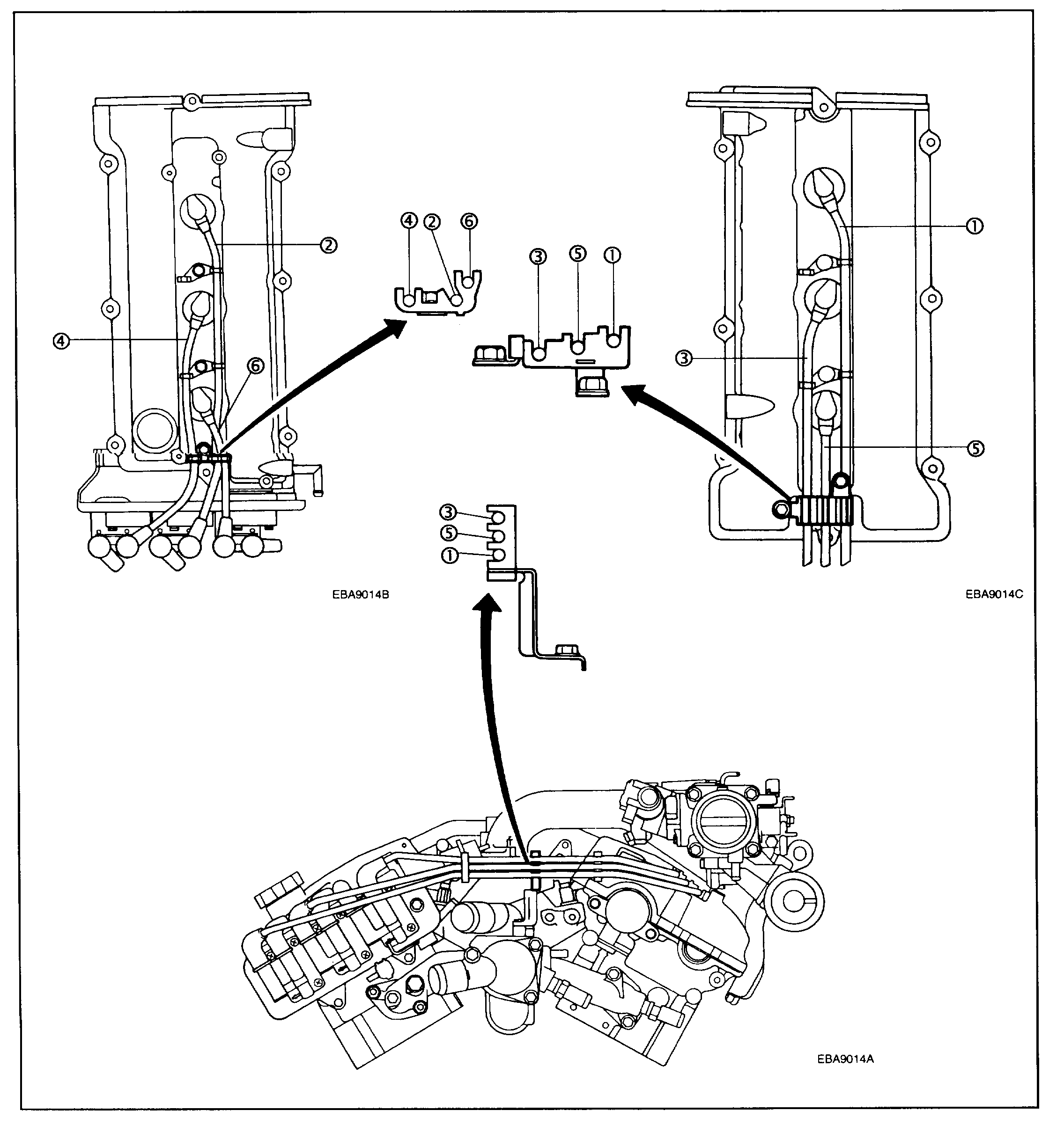

Here are the spark plug wiring routing directions.
2003 Hyundai Sonata V6-2.7L
Installation of Spark Plug Cable
Vehicle Powertrain Management Ignition System Ignition Cable Service and Repair Procedures Installation of Spark Plug Cable
INSTALLATION OF SPARK PLUG CABLE
pic 4
Improper arrangement of spark plug cables will induce voltage between the cables, causing misfiring and surging at acceleration in high-speed operation.
Therefore, be careful to arrange the spark plug cables properly as shown in the illustration.
