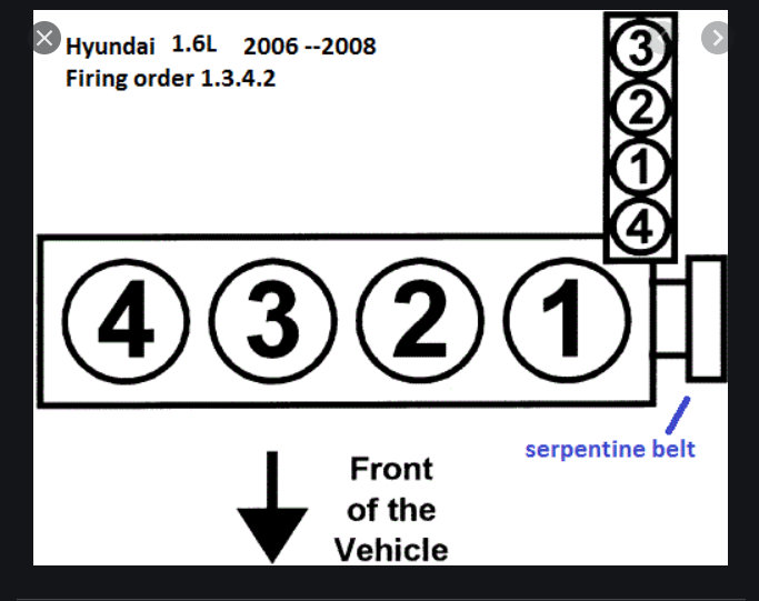

When you're looking at the car, what is the cylinder order (not firing order)? I've looked online for awhile, and Autozone help guides don't have a graphic posted.
C C C C
Front of car
Me-looking for cylinder 4

Good afternoon,
The front of the engine that has the drive belt, look there.
The cylinder closest to that is one, then 2 then 3 and finally 4.
I would start with a compression test to be sure there is nothing wrong inside the motor. Then check your plugs to see if there is any fuel or oil on them.
https://www.2carpros.com/articles/how-to-change-spark-plugs
I attached a picture for you below.
