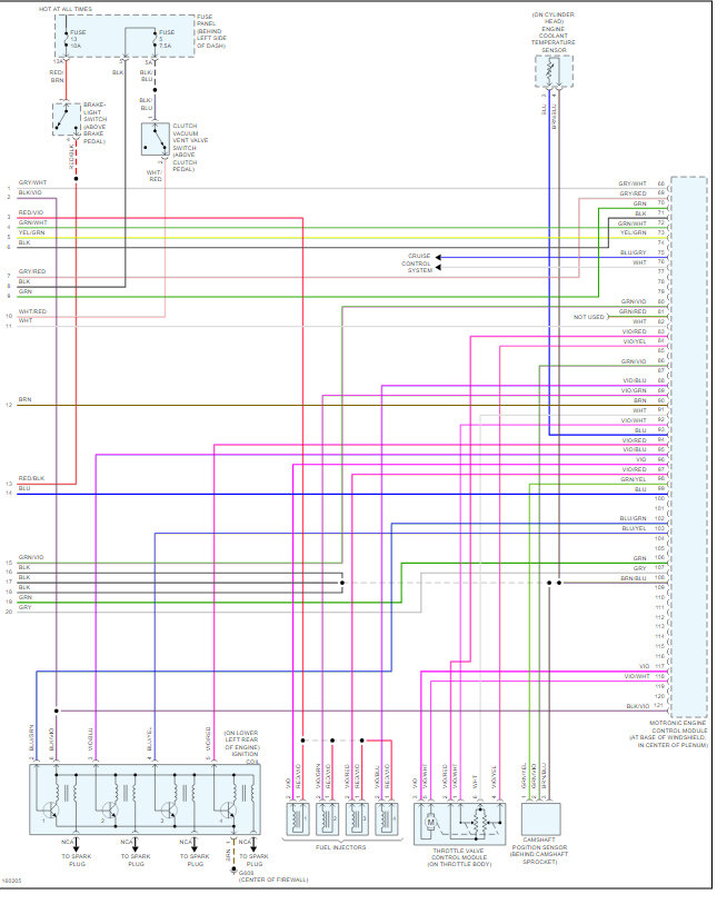

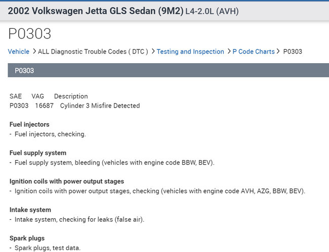

Cylinder three misfire that is bad when cold and only in 1,200 to 1,800 rpm range when warm. I have gone through: plugs, wires, coil pack, intake leaks, injector, compression, TSB on ground to the coil pack harness, still no progress.
Feb 20, 2019 at 1:39 AM
SCGRANTURISMO
  • 4,897 POSTS

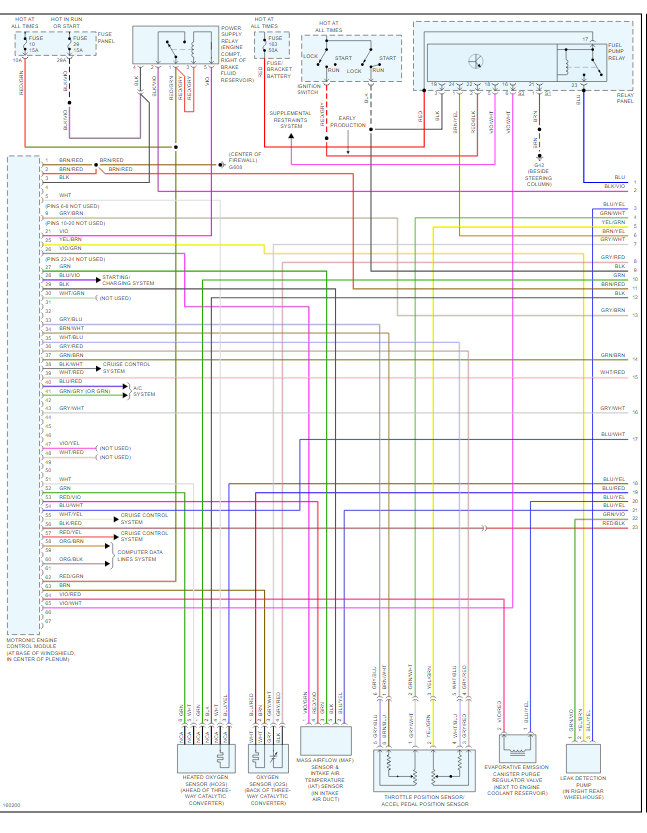

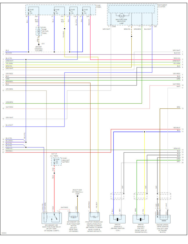

This could be an intermintant injector problem or wiring harness problem. I have included a link for you to go to. Go through the guide and let us know what you find out. I have also included a wiring diagram with the injector circuits on it for your reference. Let us know what you find out.
Thanks,
Alex
