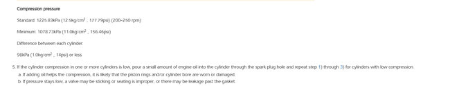

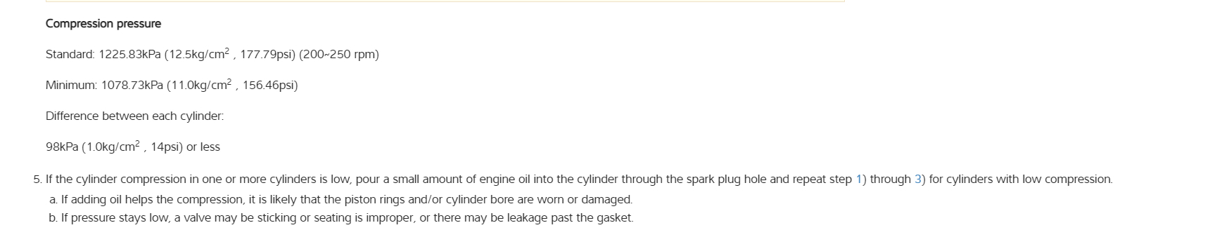

I'm looking at the specs for compression right now and I'm sorry to say that the Standard spec is 200-250 PSI, with a minimum of 156 PSI. But again, the valve timing is off, so the compression reading is going to be off as well.
So, I wouldn't go doing an entire timing chain kit, I would just do a tensioner or whatever it needs to just tighten up the chain. and go from there. It's very low on compression, you can see by the wet compression test you gained 10-15 PSI, but still, that doesn't even bring it close to minimum spec. So do your best with the chain issue first. I don't know how it's not throwing more codes, possibly from not driving through certain drive cycles, but I am sorry for the bad news.
