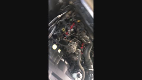

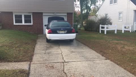

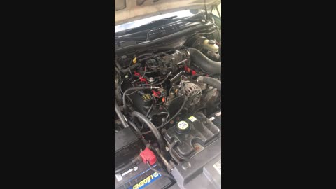

Can you shoot a quick video of the noise so we can hear it?
Nov 1, 2017 at 11:21 AM
JUSTINVOIGTS
  • 11 POSTS

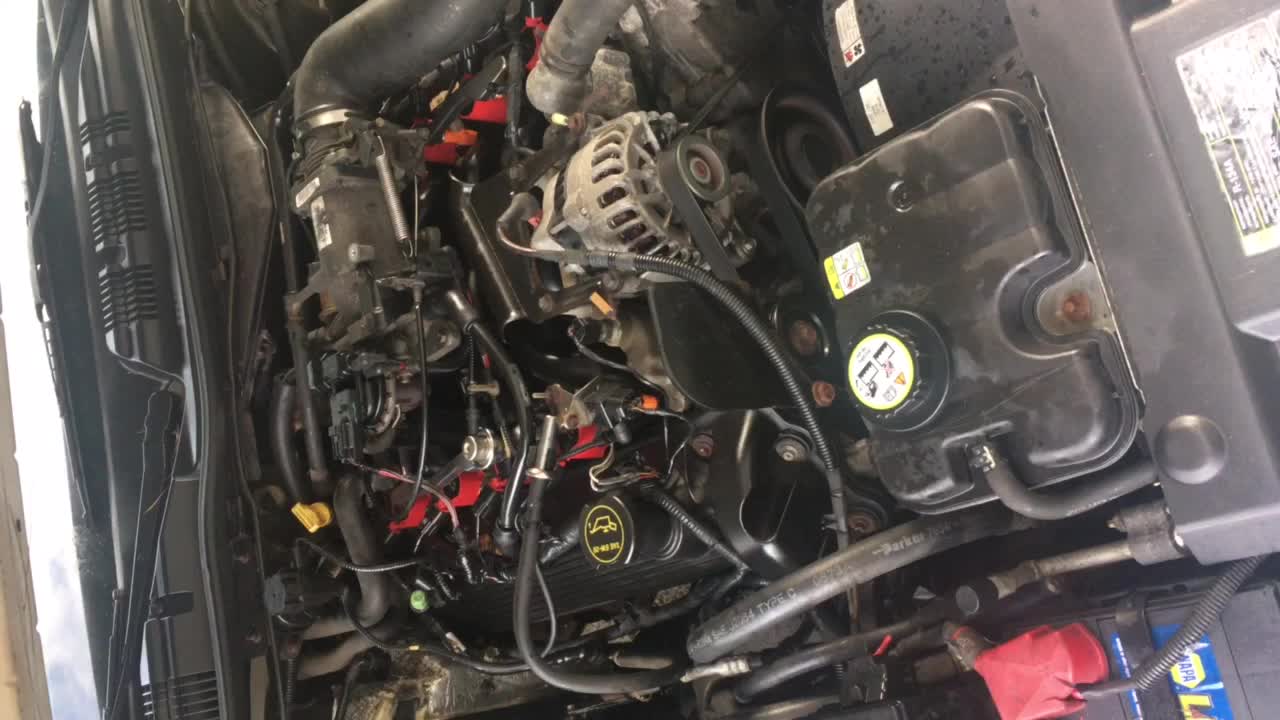

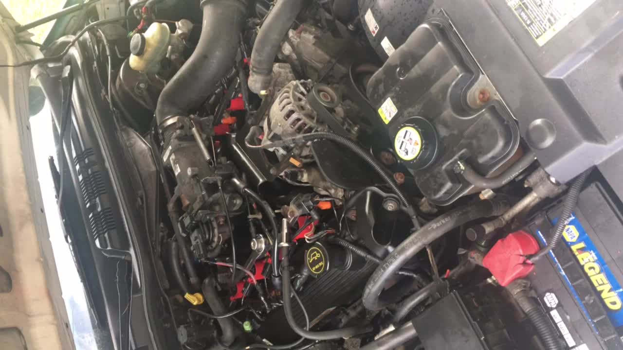

Question if I pull valvecover again on right side pull intake should I be able to see a bent or burnt valve if I do can I put vise grips holding chain to cam gear then pull cam gear off then pull head and send it out. I am trying to get away with not pulling front cover and taking timing chain off the job calls for 16 hours and pulling motor I don’t have a cherry picker at home nor air compressor for air ratchet all I have is Milwaukee 1/4 3/8 and powerful 1200 ft lb 1/2 inch guns do you know? Yesterday sucked can sea foam into intake while giving it gas obviously did that twice half can each time letting it sit a half hour in between. No Change did the same thing with a gallon of washer fluid no change I don’t know let me know please. Just so u know too it has fresh oil 520 synthetic and a bottle of Lucas and when I did lifters lost some oil and put in a bottle of marvel 120 miles ago because I read that will help sticking valve
Nov 2, 2017 at 12:08 AM
  • 55,433 POSTS
Thanks for the videos they really help. First you won't be able to see a burn valve from above. It sounds like you have a camshaft lobe that is worn down. Please remove the valve cover on the side that is making the noise and check it out. Take videos if you can so I can see.

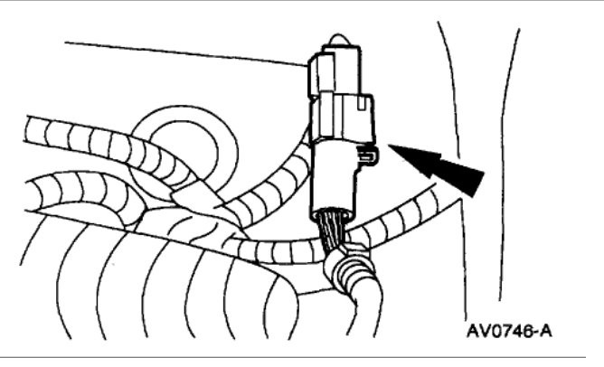

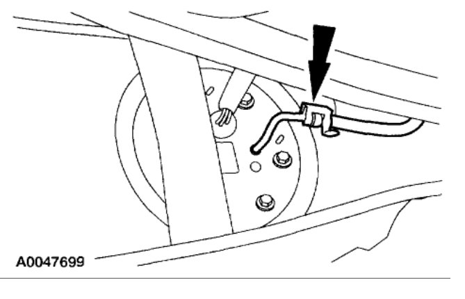

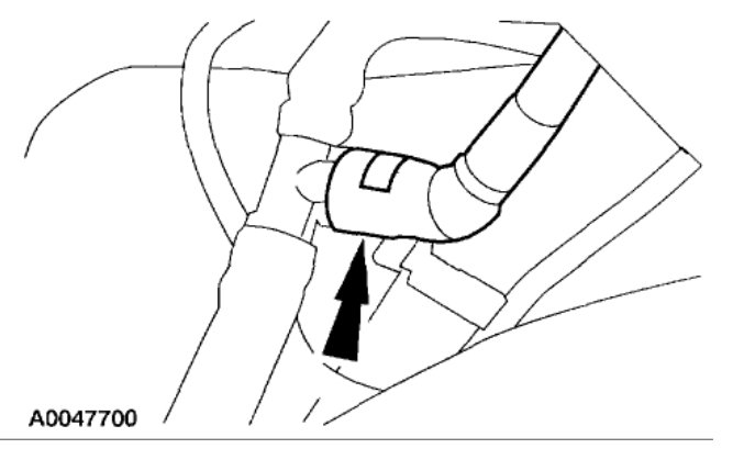

  • 55,433 POSTS

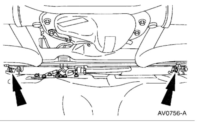

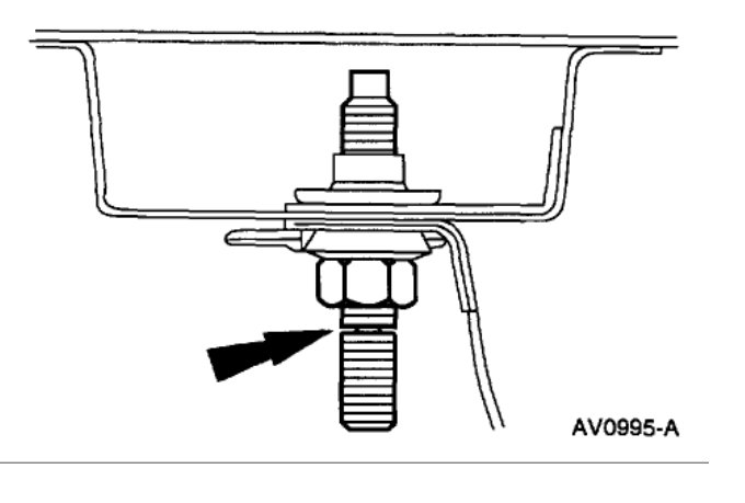

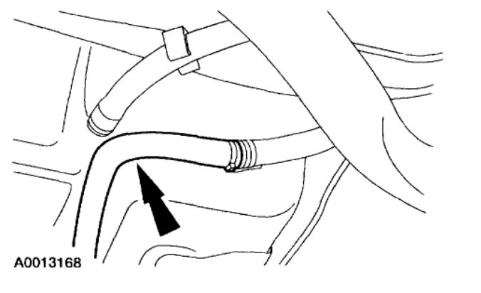

No this is not normal it sounds like you have a fuel pump that is going out. Here is a guide that will give you an idea of what you are in for when doing the job.
https://www.2carpros.com/articles/how-to-replace-an-electric-fuel-pump
and the video
https://youtu.be/SOmd3BoE4YU
Here is some diagrams of what it will be like for your car (below)
Nov 3, 2017 at 4:55 AM
JUSTINVOIGTS
  • 11 POSTS
Thank you but I have already replaced the fuel tank myself with car on jack stands at dads house only took a little over an hour. I won’t have to drop the tank as your illustrations show because it is a police interceptor the tank is on end fuel pump goes in through the side. Remember this is a returnless system no Schrader valve that was just the pressure read from scanner I know my dampener is damaged I can get a whole rail with injectors and dampener and electric fuel pressure regulator for 40 should I do it. I know this won’t help compression issue but may help misfires somewhat. I know there is a leak too because it takes a little cranking to get it started no fuel leak though I think it bleeds down.
