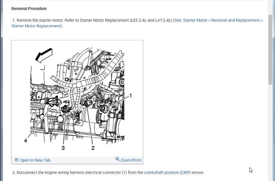

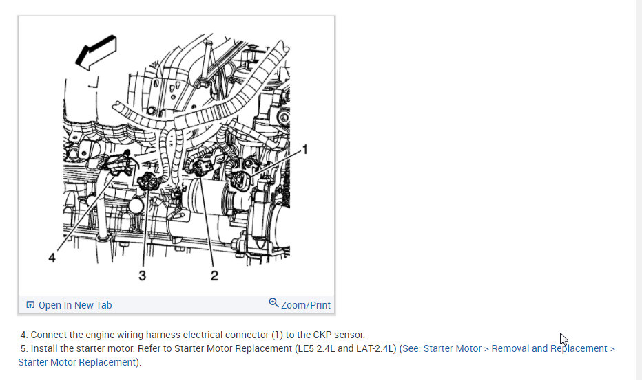

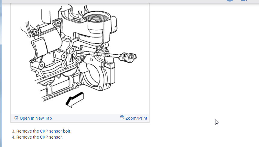

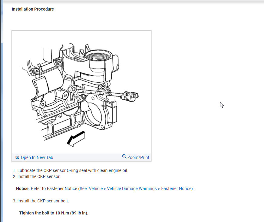

I would replace the crank sensor if you have already replaced all these components and it did not fix it before you put an ECM in it because there is no real testing for this. I attached below the process for replacing it.
