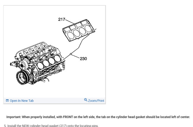

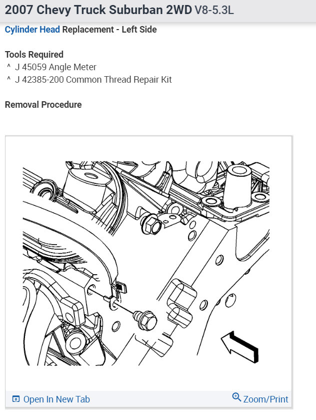

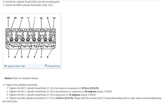

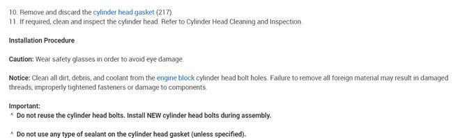

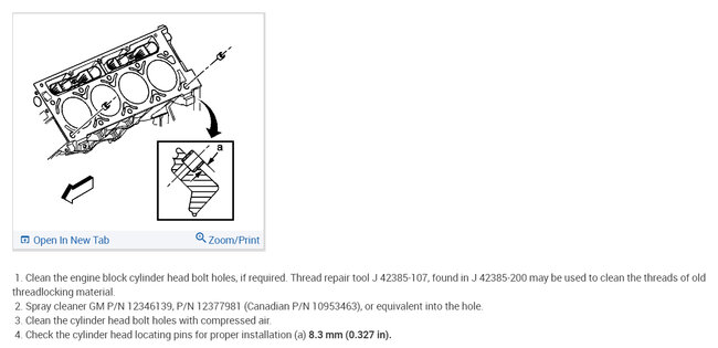

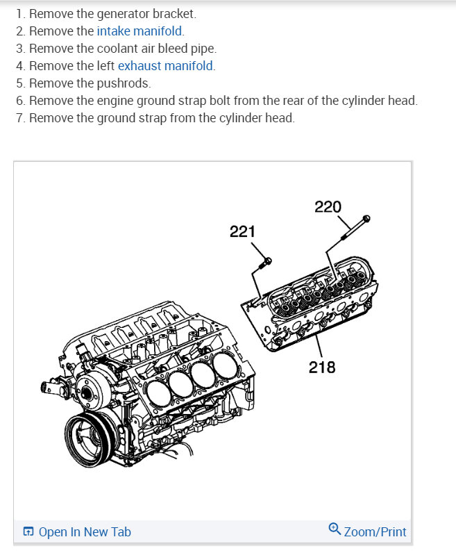

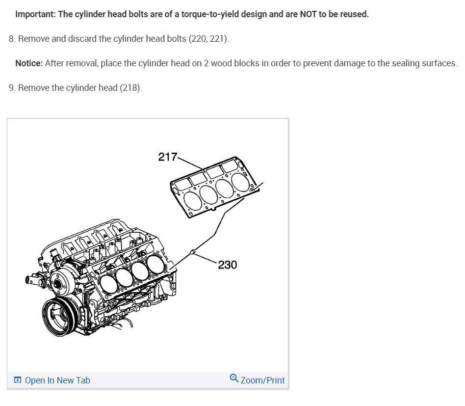

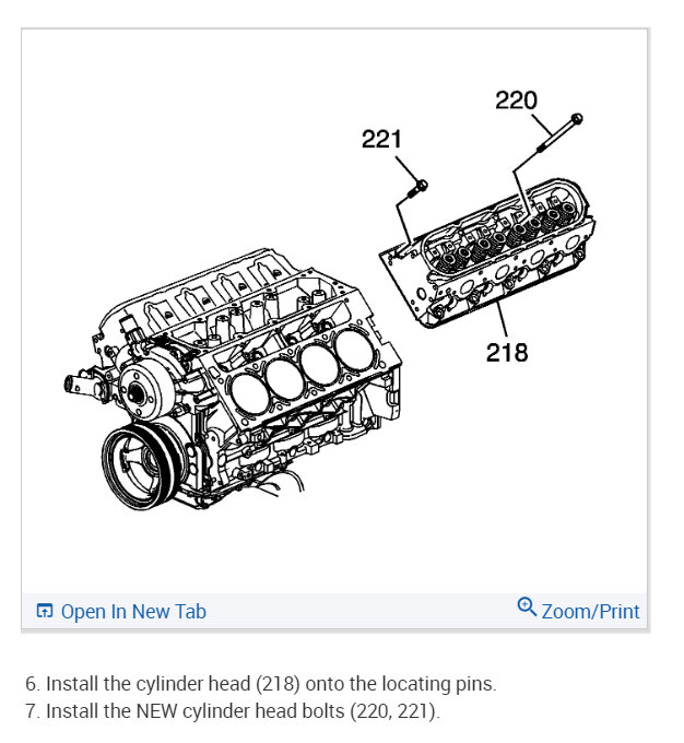

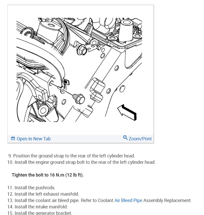

Yep, you have found the problem, it sounds like the intake valve is leaking or damaged. I would remove the cylinder head for inspection. Check out the images (below). Let us know what happens and please upload pictures or videos of the problem so we can see what's going on.
