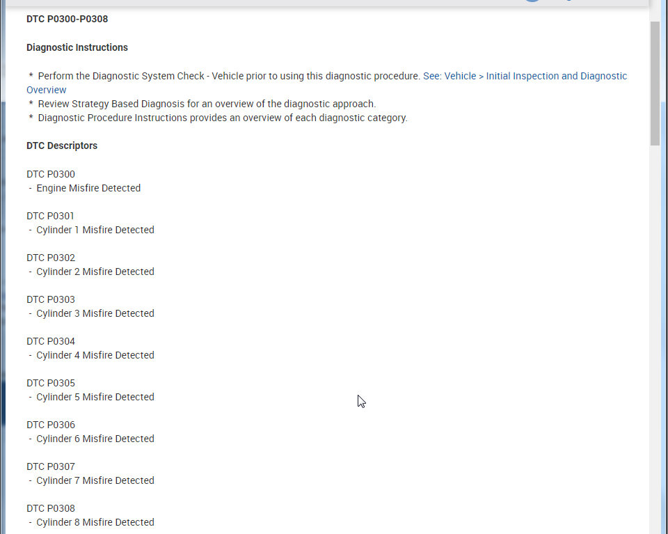

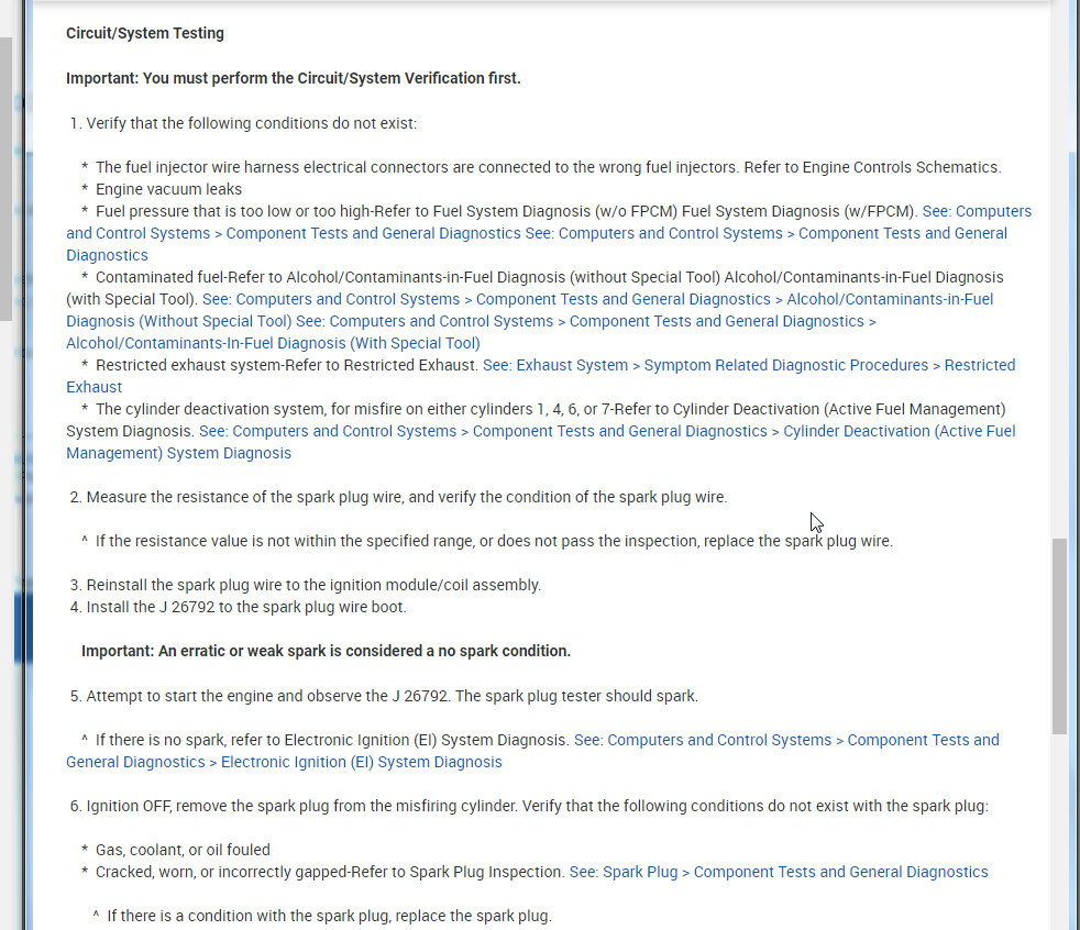

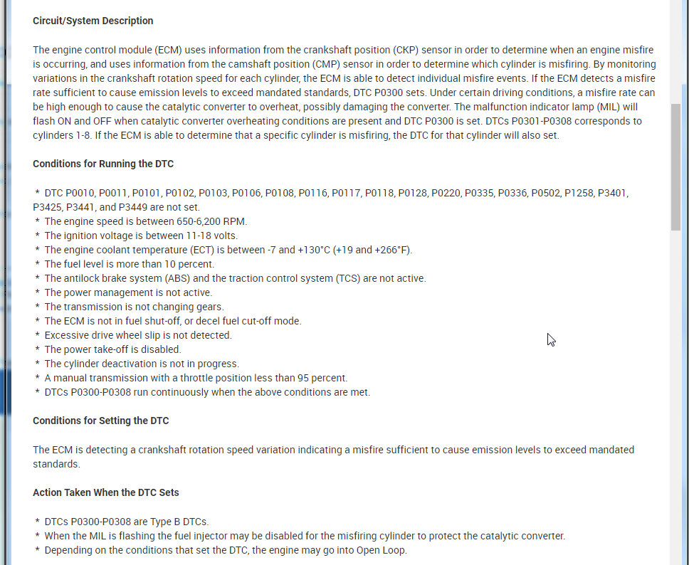

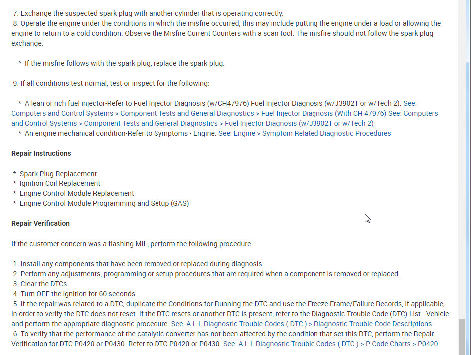

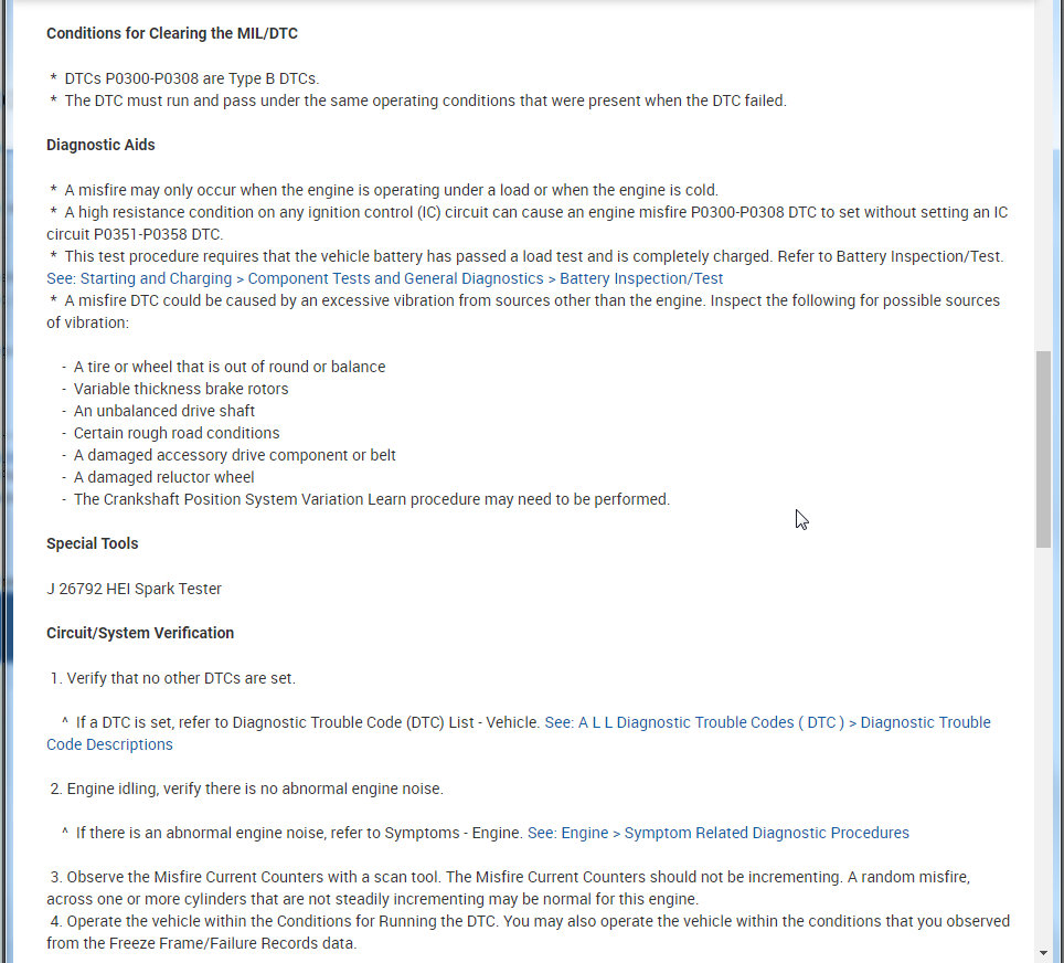

If you only have a cylinder 1 misfire then we need to assume the basics that affect the other cylinders like air and fuel are okay for now. We may have to come back to them but since you have replaced the injector, plug, and coil, the most important thing to check is the compression at this point. Here are some guides that will help with this:
Once we know what the compression is on the cylinders on that bank we will have a better idea if this is the issue but this is the next step that we need to take. Thanks
