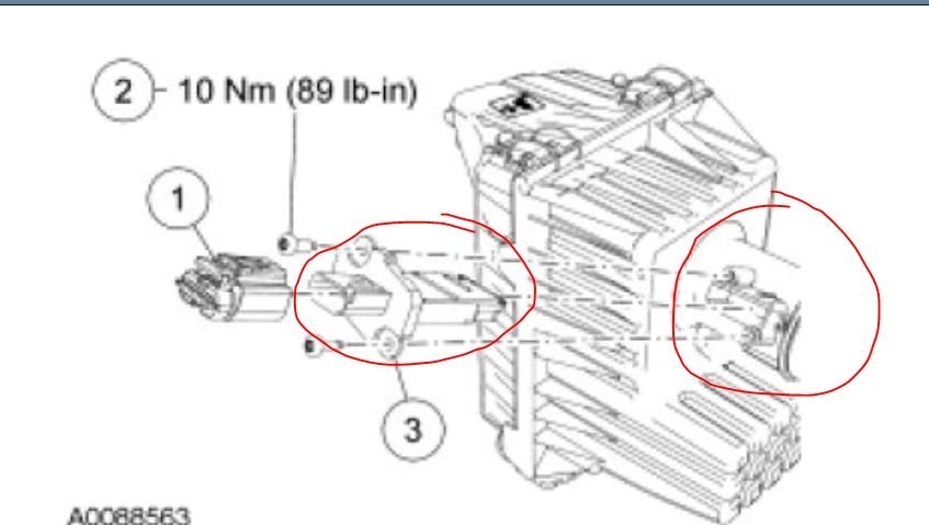

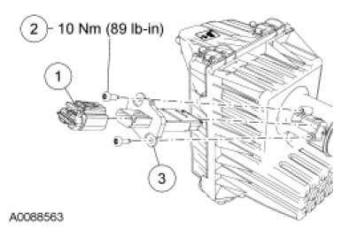

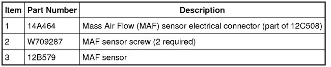

As far as the mass air flow (MAF) it is mounted on the air box and doesn't require the intake to be removed. There are two screws that hold it in place. See the attached pics.

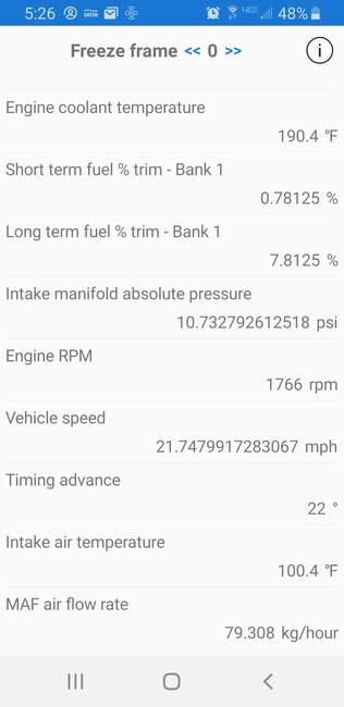

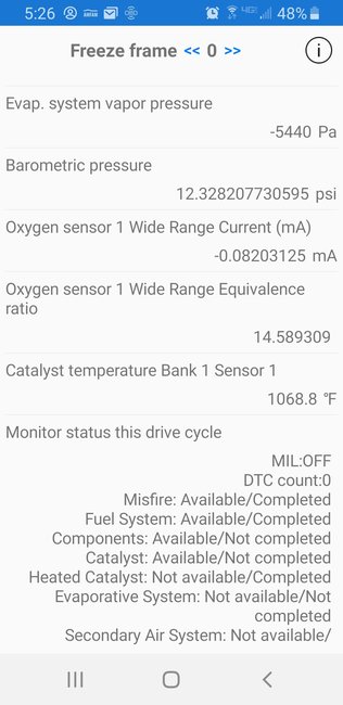

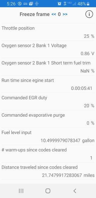

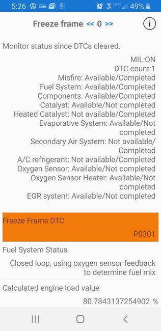

7. I have a OB2 scanner and am primarily using the Torque Pro app currently. I had attached the snapshot of the P0301 when last happened today to the original email, 21 minutes into driving.

No donation needed. I have to be honest, I can't see why the EGR would cause a misfire only on once cylinder. Can you tell me what the compression readings were? I did notice that the long term fuel trim is at the high end. Interestingly, I remember there being an issue with the cylinder head temperature sensor that was causing a misfire issue. Have you noticed anything with the temp gauge, cooling fans, or anything other? Keep in mind, they don't have to exhibit problems and the sensor can still cause a misfire. I'm questioning of that is why the LTFT is on the high end. Let me know if you replaced it.
