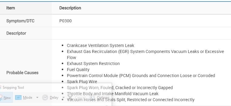

I have a p0300 trouble code with flashing check engine light and engine misfiring badly.

I would start by performing a compression test to make sure there is no internal damage to the motor.
How old are the tune-up parts?
I would also check the fuel pressure as well to be sure the proper amount of fuel is being sent to the engine.

I replaced the ignition control module and that fixed the P0300 trouble code and misfire. thank you.
