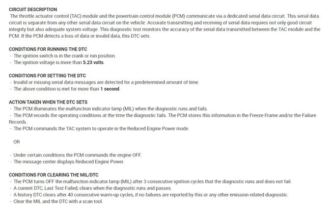

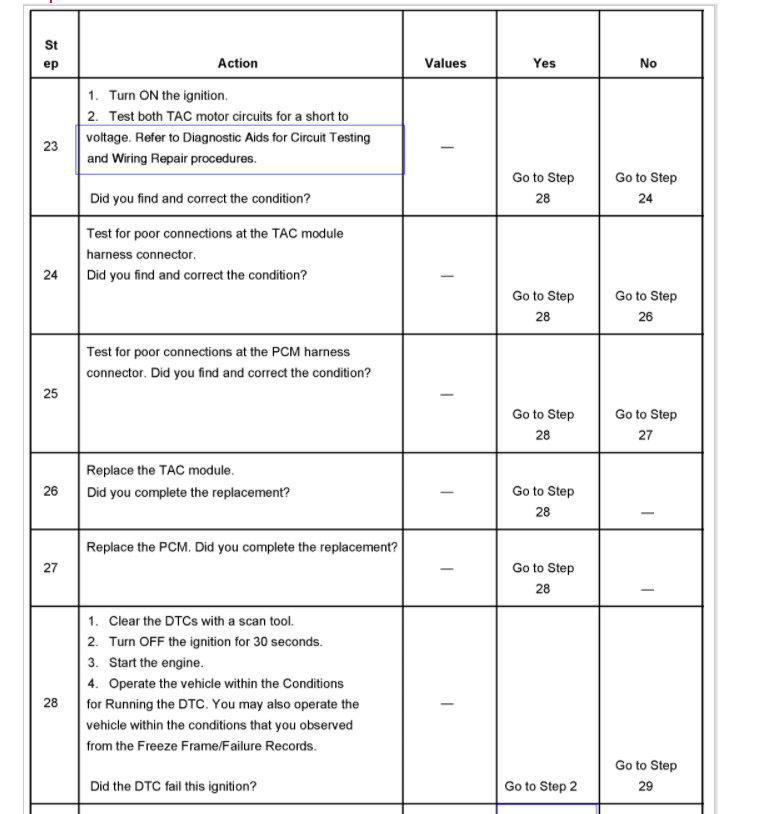

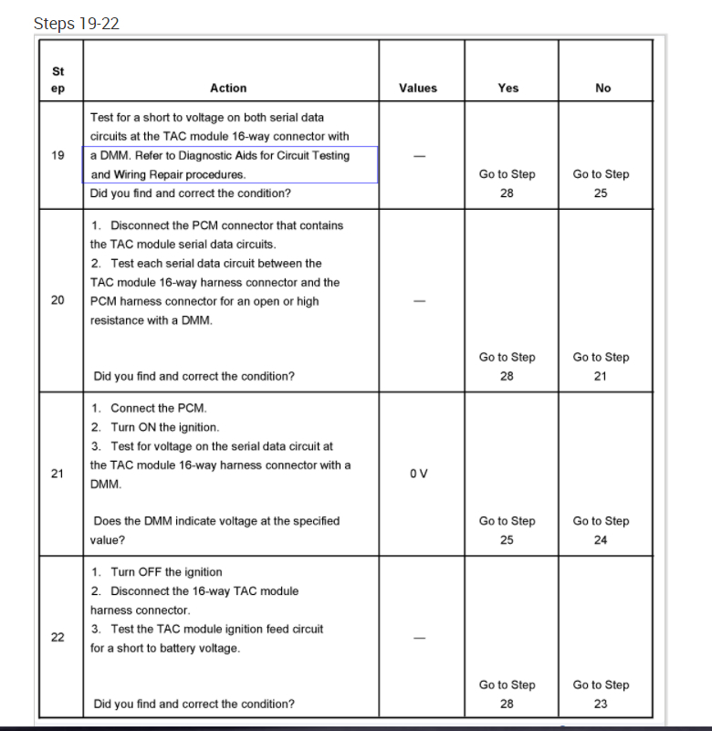

Started with reduced power P0300 misfire problem and a freeze frame fuel trim bank 2 of -54% short term -25%. Check data streams and all was normal O2 sensors all normal so I erase codes and start again and get reduced power P1518. Don't know where to look!!
Sep 1, 2021 at 5:56 PM
Good morning,
What are the long-term trims for both banks while running? They are more important than the short-term trims.

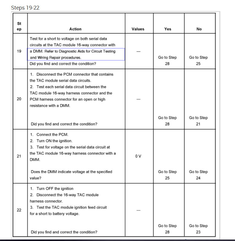

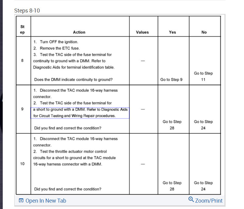

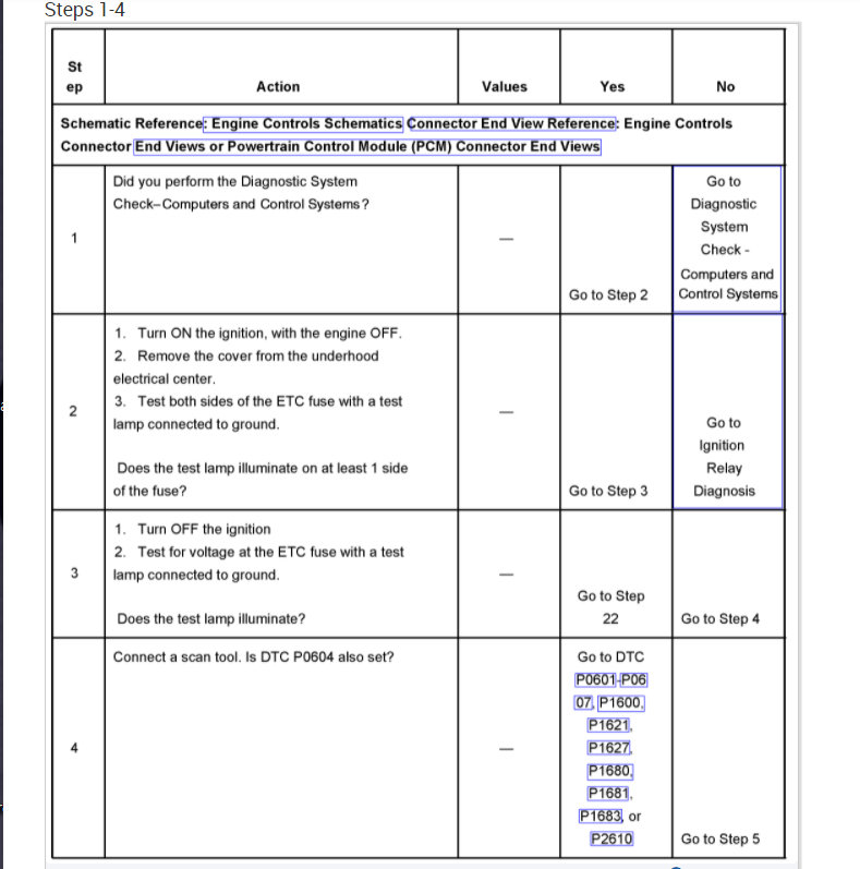

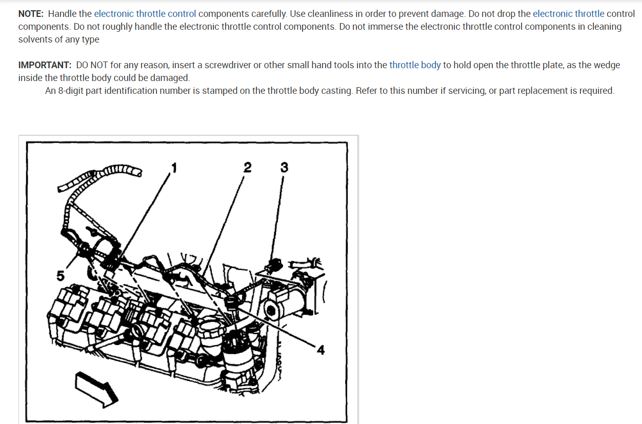

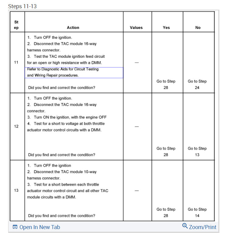

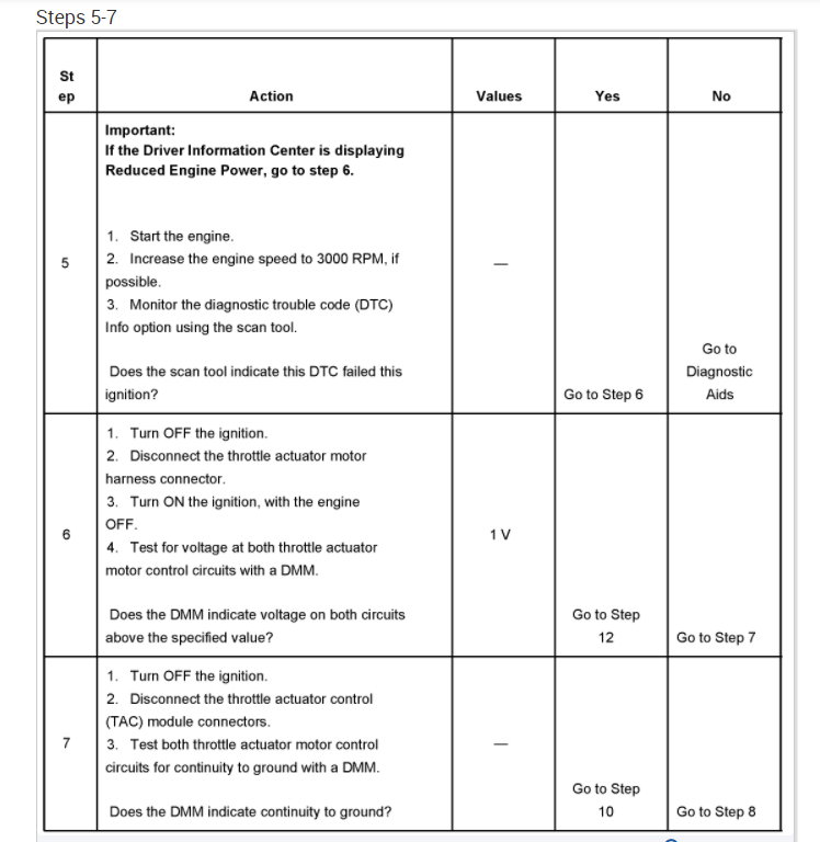

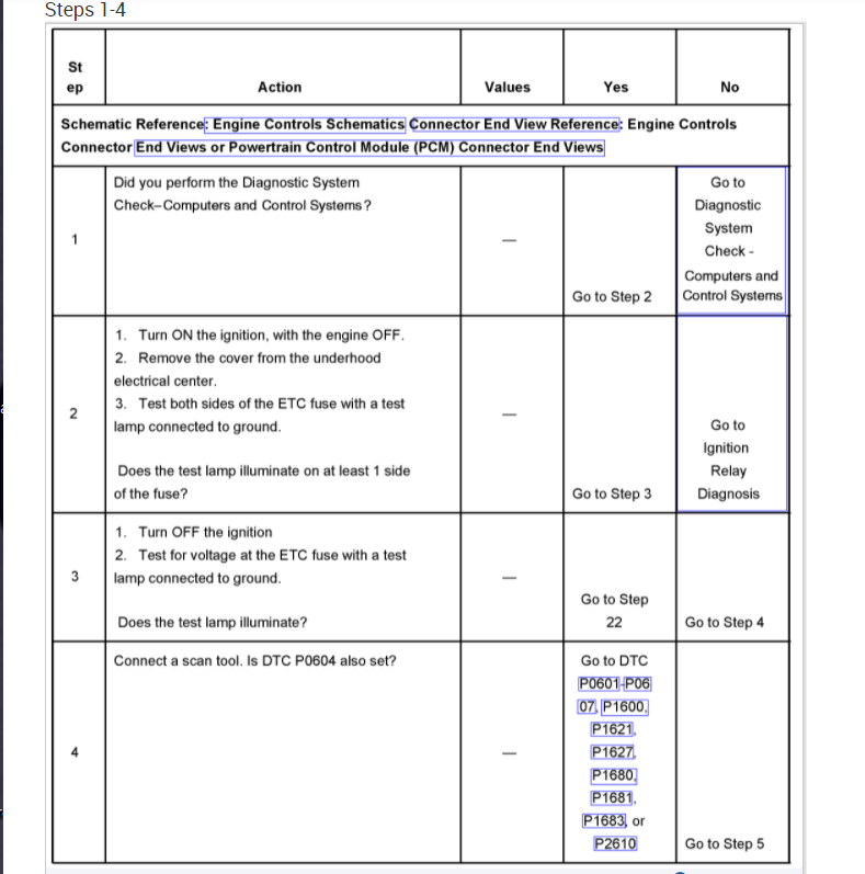

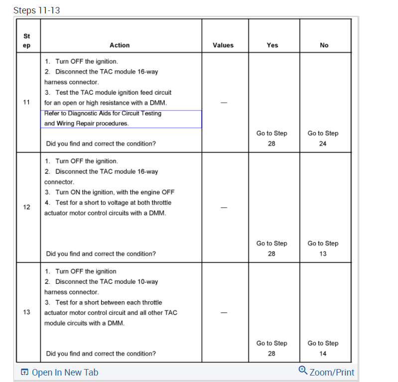

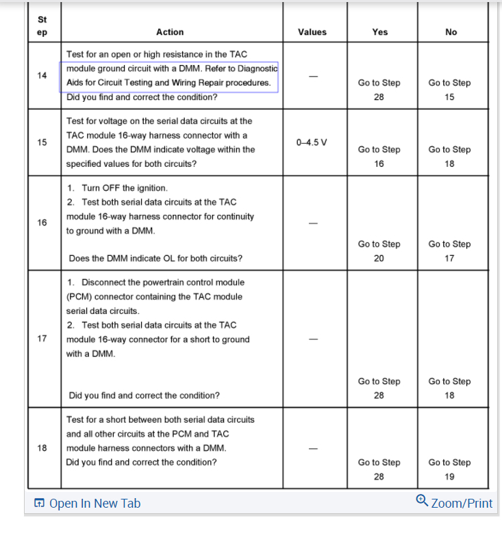

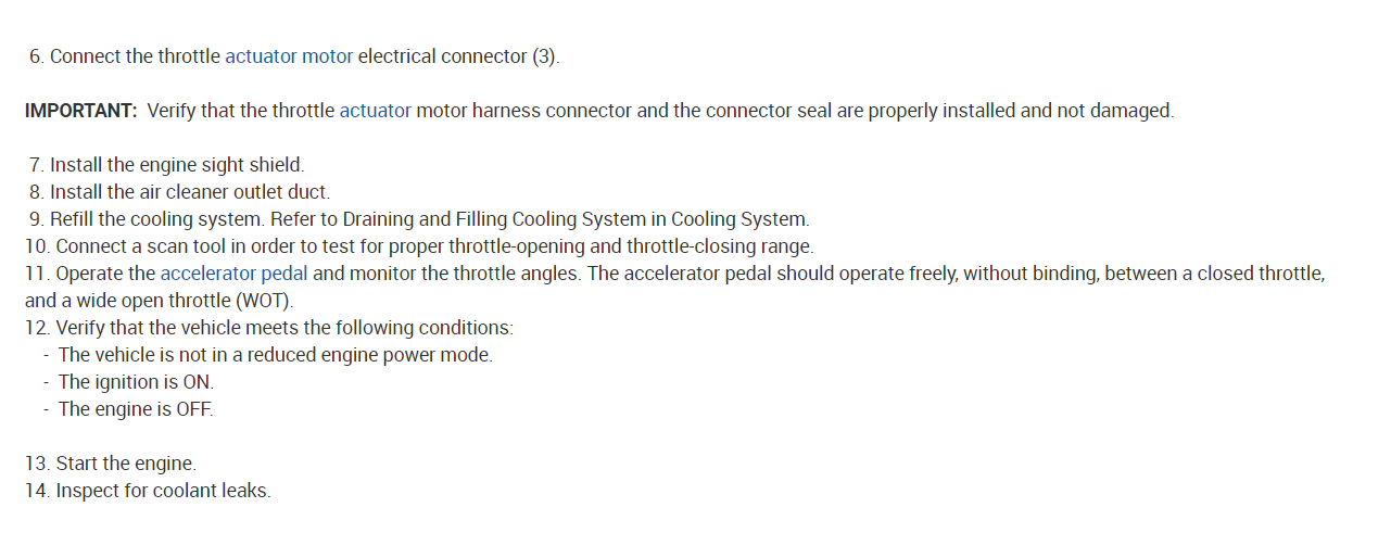

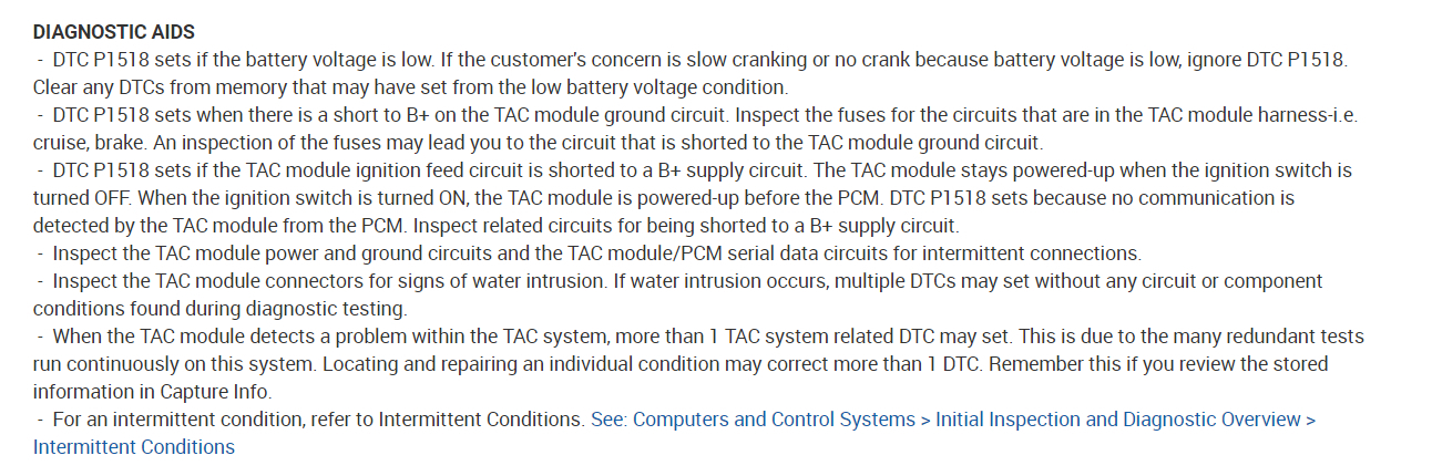

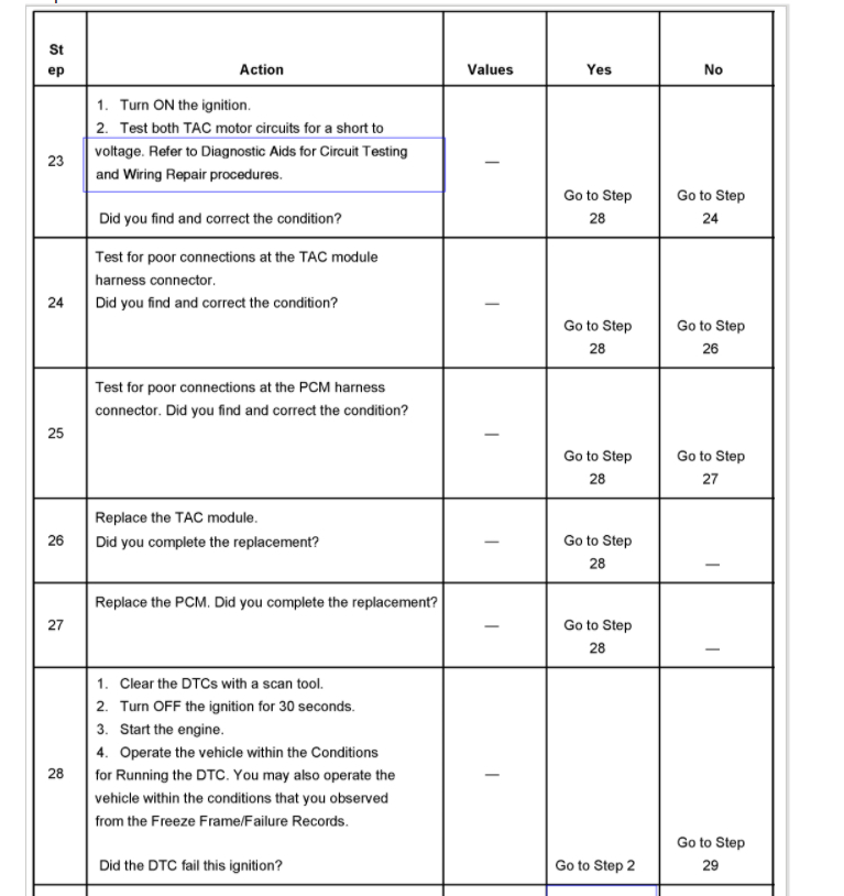

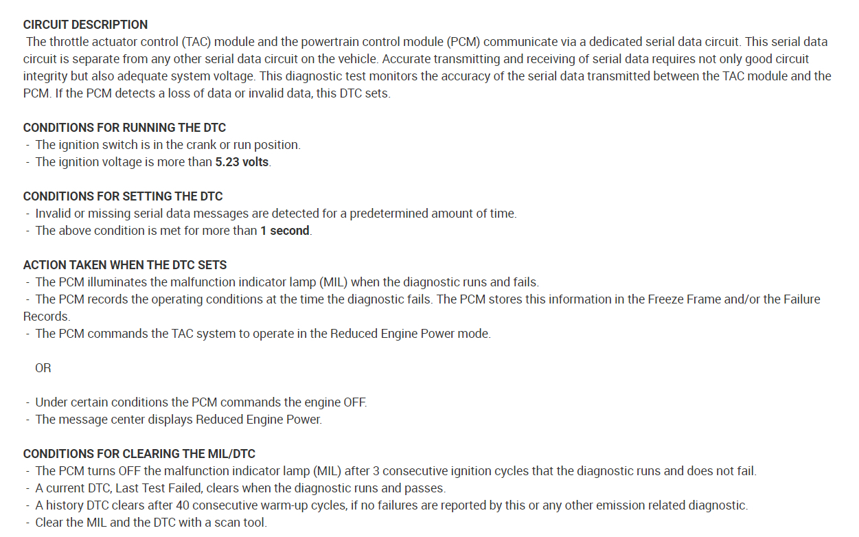

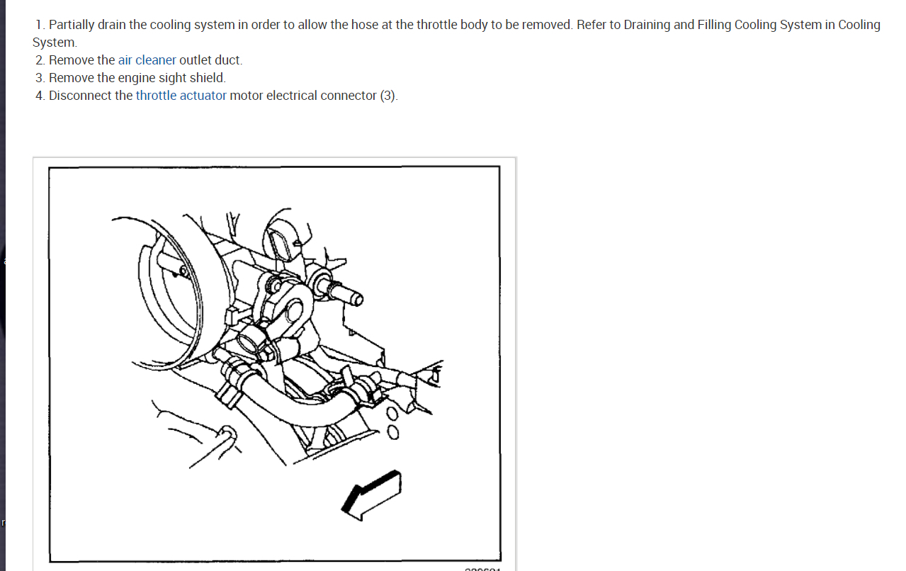

I attached the flow chart for you below of the code with steps to follow. In most cases, it is the throttle body that is the issue for both complaints.
https://www.2carpros.com/articles/how-a-throttle-body-works

What steps did you follow in the flow charts that I left? The flow chart was very specific in tests that needed to be done.
