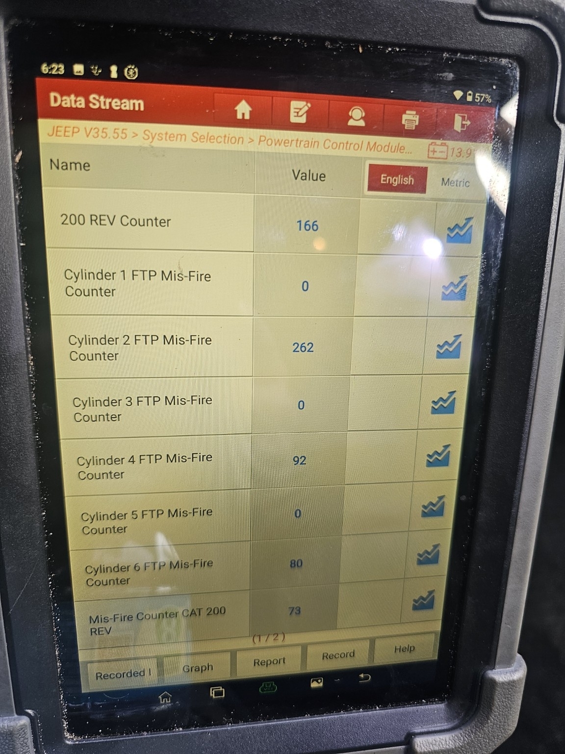

* Misfire counters show:
* Cylinder 2: 262 counts
* Cylinder 4: 92 counts
* Cylinder 6: 80 counts
* Cylinders 1, 3, and 5: 0 counts

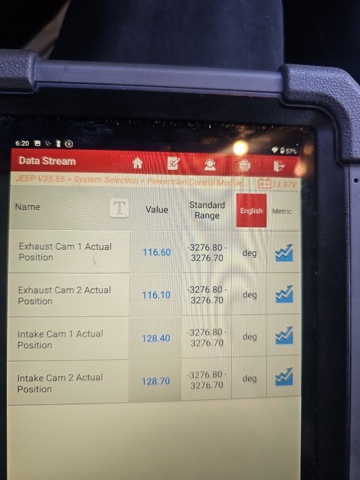

Timing:
* Camshaft actual values checked with scan tool
* Intake and exhaust cam values between banks are nearly identical
* No obvious indication of jumped timing chain or cam phaser issue

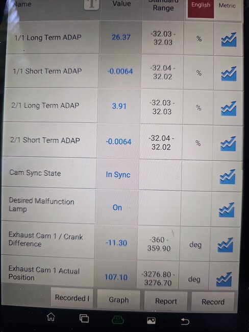

Scan Data:
* Freeze frame when code set:
* RPM: 713
* Coolant temp: 192°F
* LTFT Bank 1: +26.5%
* LTFT Bank 2: +3.9%
* Current trims closer to normal during testing

1. Has anyone seen a Pentastar with acceptable compression and normal-looking valvetrain still have an idle-only valve sealing issue?
2. Would you recommend a running compression test or leakdown test as the next step?
3. Any known PCM driver, injector control, wiring, or Bank 2-specific issues that can cause cylinders 2, 4, and 6 to misfire primarily at idle?

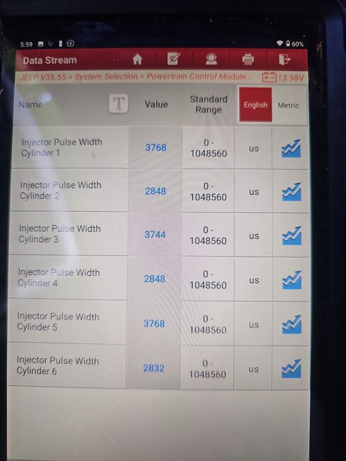

4.) Can anyone shed some light on why bank 2 injector pulse values are ALL lower than bank 1 ?

Yep, can I ask if the engine has an exhaust leak? Also, I would swap out the MAP sensor and check the O ring seal as well. Does the front of the engine have a slight rattle noise when cold at idle? You might have a broken timing chain guide or a worn timing chain allowing "slop". Can you please upload a short video of the engine at idle when cold from under the hood so I can see hear and see it? Thanks for the detailed question.
