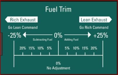

I try to understand the fuel trim data and the o2 sensor stuff, but it is quite confusing to me. I have enclosed several of the freeze frame data i have accumulated, and perhaps you can see causes there. I have also enclosed a video of live data at idle.

The fuel trims are perfect along with all other things I saw. You want the trims to be as close to 0 as possible, and yours stay well within the specs. What a negative trim indicates is that the O2 sensor is indicating the fuel mixture to be slightly rich, and the computer is trying to compensate by shortening the time the injectors are open. The opposite happens when they are positive. However, as mentioned, your's are good.

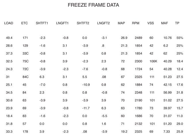

Did the Freeze Frame Data I supplied indicate anything at higher speeds when the code was set off? I put in enough information from several events. Seems like something should have stood out.

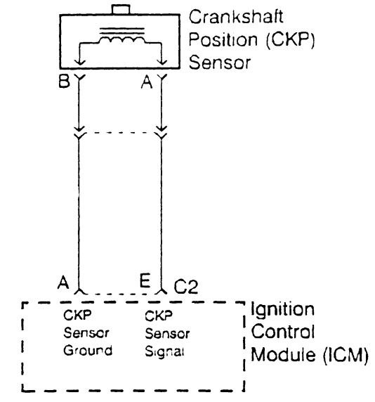

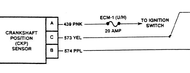

The sensor can be tested.
A) Disconnect the CKP sensor harness. Connect an LED test light between battery ground and CKP harness terminal A .
B) With the ignition ON and the engine off, verify that the test light illuminates.
If not as specified, repair or replace the fuse and/or wiring.
C) Carefully connect the test light between CKP harness terminal A and B . Verify that the test light illuminates.
D) If not as specified, repair the CKP harness ground circuit (terminal B ).
E) Turn the ignition OFF and disconnect the test light.
F) Next, connect suitable jumper wires between the CKP sensor and CKP sensor harness. G) Connect a duty cycle meter to the jumper wire corresponding to CKP terminal C and battery ground.
H) Crank the engine and verify that the duty cycle signal is between 40-60%.
I) If it is not as specified, the CKP sensor may be faulty.
J) Next, connect a AC volt meter to the jumper wire corresponding to CKP terminal C and battery ground.
K) Crank the engine and verify that the AC voltage signal is at least 10.0 volts.
If not as specified the CKP sensor may be faulty.
__________________________
To determine duty cycle, you will need a multi meter. Most have a DMM setting to measure frequency.
I attached a couple pictures with the wiring to the CKP you may find helpful.
Let us know.

Did you see the data that I enclosed before on the Freeze Frame data from several fault codes (Po300)? (Beginning of post)
I would think that is where we might see something.
I've also enclosed below two videos....one from February 28th and one from tonight.
Maybe there is some useful information there.

I was just reviewing this one and it looks like the short term fuel trims are just fine at idle. You show them bouncing around 0 and then dropping to about -2. This is ok as the PCM will be able to adjust for this and will not directly cause a misfire. Remember that the PCM uses the IAC, MAF, MAP, Baro, to calculate what the air/fuel ratio should be. It then monitors the o2 sensors to see how it did. The goal is to stay at 14.7:1 and a short term fuel trim of zero is this ideal state. So the fact that it is bouncing back and forth from positive to negative shows that the PCM is able to add and remove fuel in order to keep it around 0.
Also, the PCM on these older engines can only control fuel to match the amount of air that is coming in. So an accurate air flow is crucial. Based on these numbers on the recordings that you have, it looks like the volumetric efficiency at idle is about 54%. This number seems off so I am thinking you have a MAF sensor issue but I see you replaced it. So let's run this test at wide open throttle so we can see what the VE is at that point. A healthy engine should be between 75-90% efficient at WOT.
If you can take that scan tool and write down these numbers while doing a WOT stab, it should help point us in a good direction. DO NOT hold it at wide open in order to get all of the numbers. Do one at a time and record the highest number that you see for each.

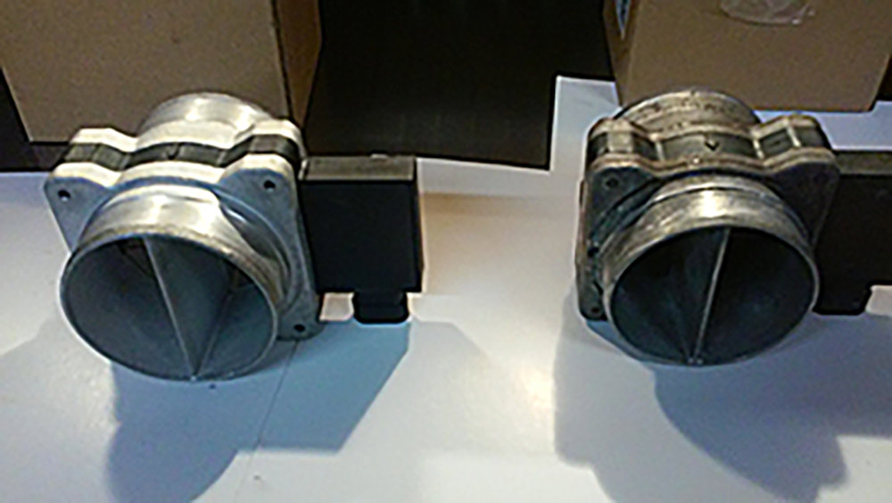

Speaking of MAF sensors:
Check out the enclosed photos.
I ordered one just to be on the safe side in case the one in the truck was faulty.
The one they sent idled at 6.? so I asked to return it as I was told to expect it to be close to 4.3 at idle. Well, they sent the one that is currently in the truck, and never asked me to send back the one I questioned.
Now I have a total of three and I don't know if any are good?
Apr 15, 2019 at 11:07 AM

To answer your question about the MAF. I am concerned about this. In my experience it should be around 2 g/s at idle and then climb when you accelerate. Your MAF is around 5.5-6 g/s at idle. This means the PCM is seeing a larger amount of air coming in and it thinks it needs to add fuel in order to achieve the 14.7:1 ratio. Hence your short term fuel trim being a little rich and the PCM commanding it to go lean. I think this command to go lean is actually what is causing your misfire.
Anyway, removing the o2 sensor and running it will prove out a clogged converter. It could still be carbon on your valves that is restricting flow but this is unlikely to cause a bad misfire as you describe.
