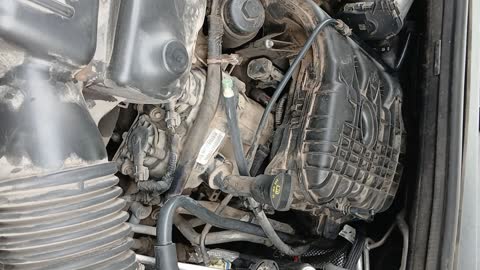

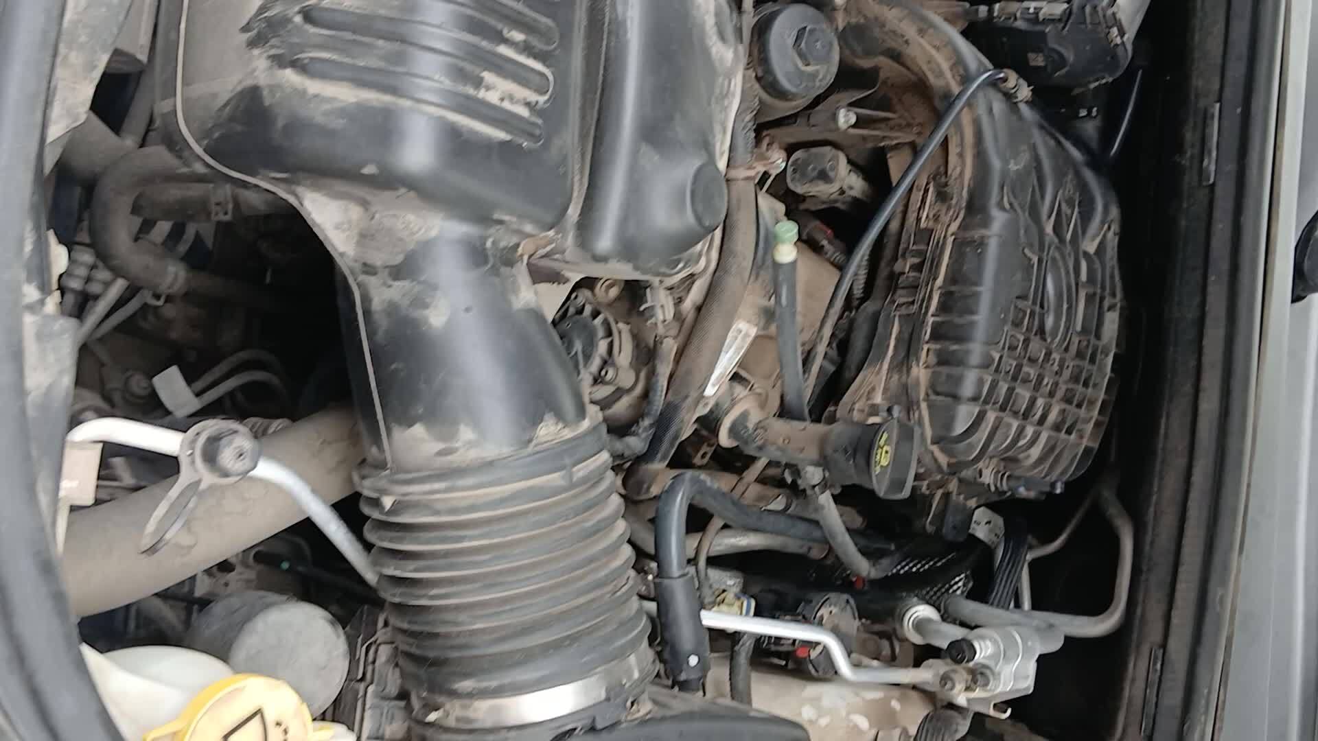

JSITORIUS
Hope this helps
Aug 9, 2025 at 9:17 AM
  • 55,222 POSTS

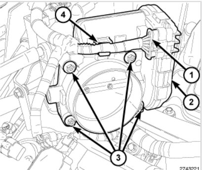

That was one of the better videos, thank you. I would clean the throttle body, this guide can help. Please check the images below as well.
Also, lets use a scanner to check the LT trim an ST trim to see what the computer is doing. We may have a weak MAP sensor. I would still try the smoke machine for the vacuum leak, sometimes the spray misses the leak. Read the guide completely before you begin. Please upload a video of the throttle body condition :) Check out the images (below). Let us know how it goes
