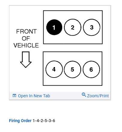

There is a misfire on #2 and #3 (both are bank 1).

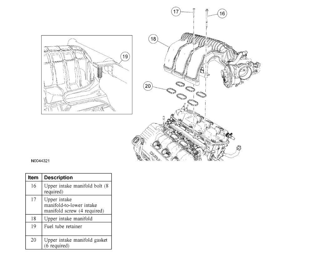

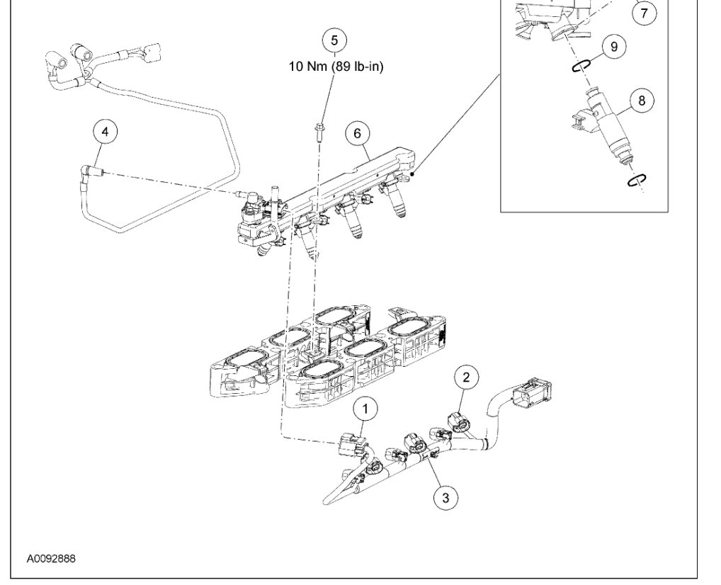

When you pull the spark plugs on number 2 and 3 what do they look like? It sounds like you have two injectors that are having a spray pattern problem. Here is how to remove the injectors and how to check the spray pattern to see if this is the issue. I have included diagrams below to show you how to use your car as well. Please upload what the plugs look like so I can see what's going on.
https://www.2carpros.com/articles/how-to-test-a-fuel-injector
Also let's make sure the gaskets for the intake are not leaking, this guide can help:
Apr 29, 2022 at 2:36 AM

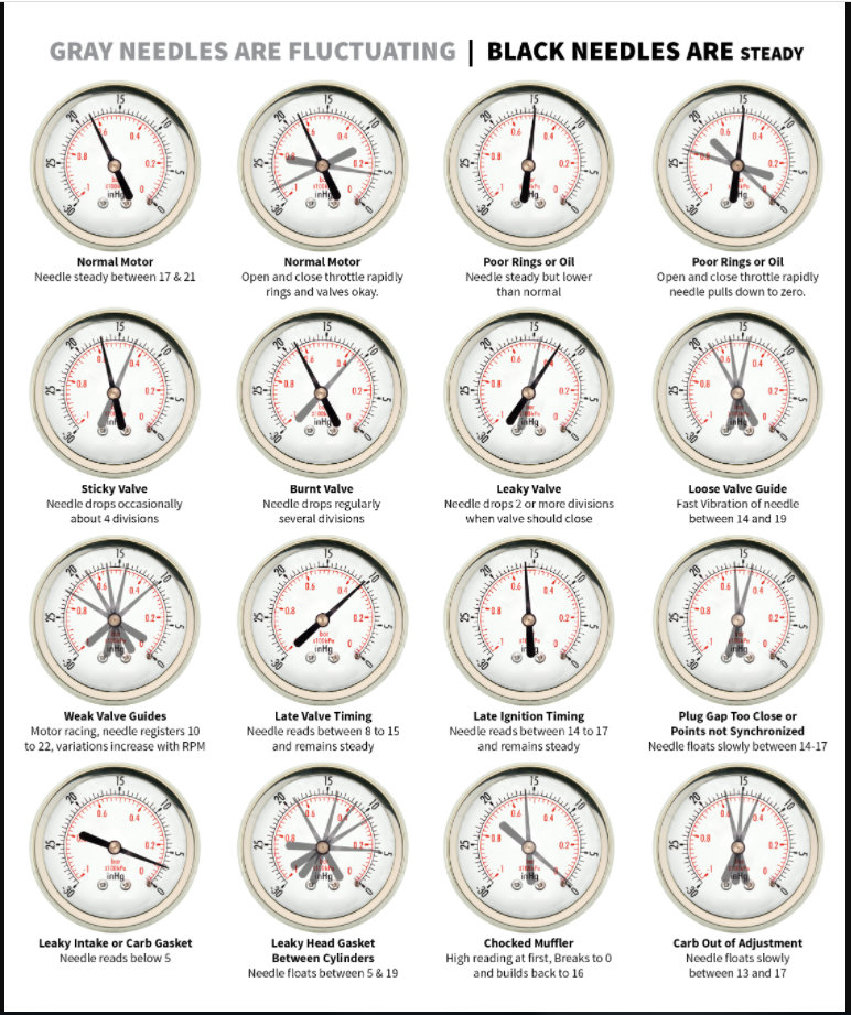

If we are not, then we need to monitor the intake vacuum using a vacuum gauge and find out if we have intake valves hanging open. I attached a chart below that will help with this.

Lastly since these two cylinders are next to each other, we need to ensure we don't have a head gasket failure between them.

Okay, so, I performed a vacuum test, the numbers were perfect - steady 19 at idle, when you hit the gas fluctuated down and up then back again.
I'm pretty sure this passed test eliminates a lot of the other tests to perform (I was looking through the list of things that the vacuum gauge would show if they were faulty).
Hopefully there's no need for a compression or leak down test now, seeing I passed the vacuum test.

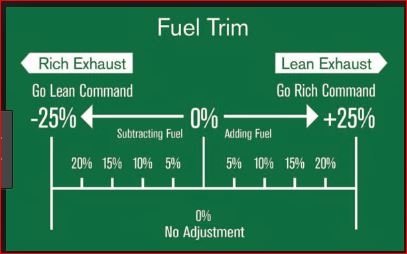

So, if you have misfires and the check engine light comes on then we need to rely on o2 sensor data. However, you mentioned that the o2 sensors were reading correctly.
This is what is odd. If you have an actual misfire the o2 sensors should be reflecting this. The short-term fuel trims would be rich or lean depending on what is happening. If they are not, then I suspect you have an o2 sensor issue.
What happens is when the engine is running rich or lean, the PCM adjusts for it, and it bases this on the o2 sensor data. If the o2s are not telling the PCM that it is rich or lean, then it will never adjust, and the engine will just misfire. This is the most common cause of only the P0300 misfire with no other specific cylinder's misfire.
So, I would look at the fuel trims and see if they are correct while it is misfiring and if they are then I would suspect the o2 sensors are the issue. If you are getting misfires on only one bank, swap the upstream side to side and see if the misfire moves.
