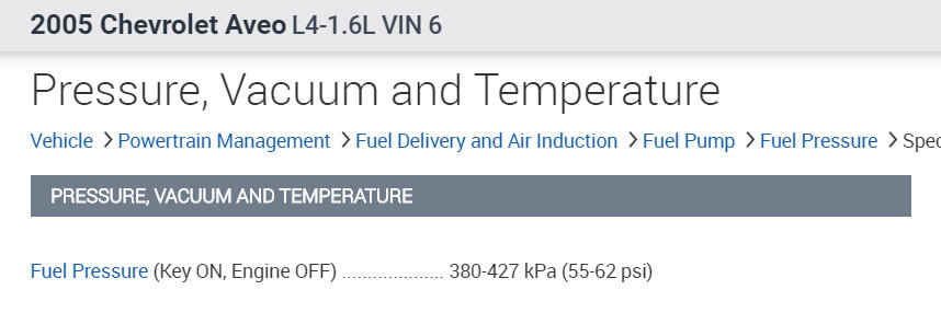

Many things can cause a random misfire. Is the P0300 the only code you get? If so, have you confirmed fuel pressure to be within spec? Also, have you checked for engine vacuum leaks?
If you haven't done that, I would start there. Also, keep in mind that fuel pressure ( too high or low) can cause this. Here are the manufacturer's specs for pressure.
Fuel Pressure (Key ON, Engine OFF) .................... 380-427 kPa (55-62 psi)
Check that and let me know what you find. If you need a gauge, most parts stores will lend or rent one to you.

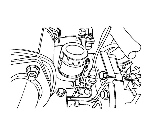

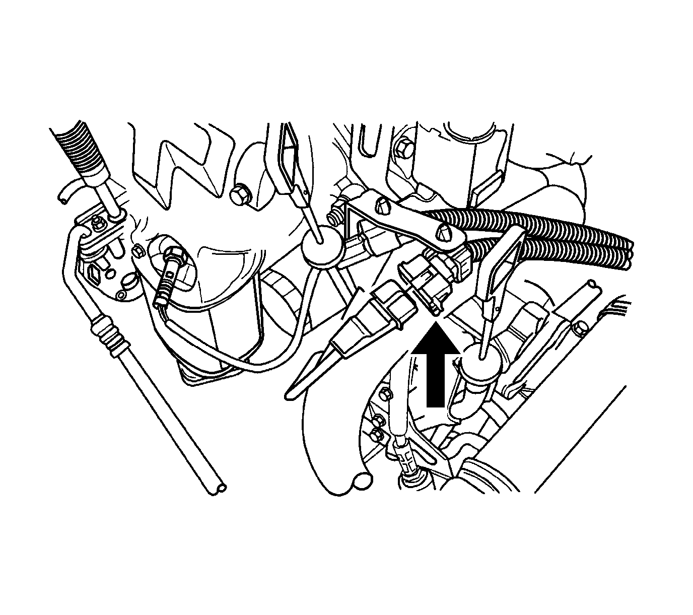

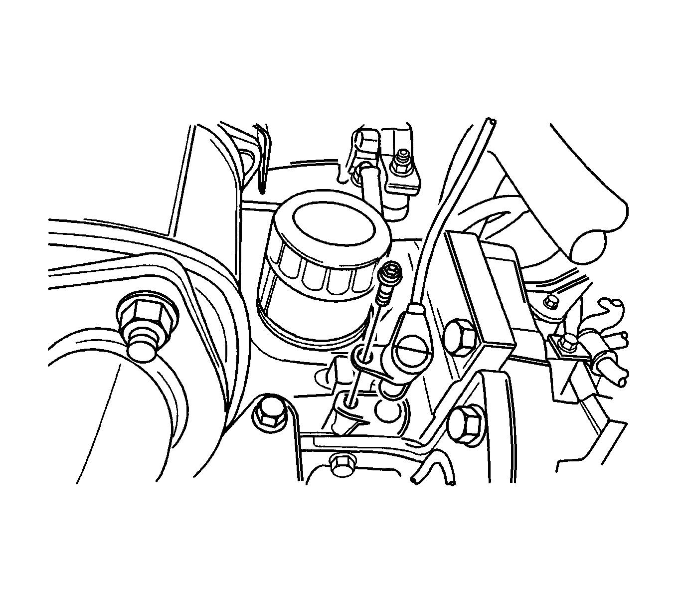

CRANKSHAFT POSITION (CKP) SENSOR REPLACEMENT
Crankshaft Position Sensor Replacement
Removal Procedure
Caution: Refer to Battery Disconnect Caution in Service Precautions.
pic 1
1. Disconnect the negative battery cable.
2. Disconnect the crankshaft position (CKP) sensor electrical connector.
pic 2
3. Remove the CKP sensor bolt.
4. Remove the CKP sensor.
Installation Procedure
Notice: Refer to Fastener Notice in Service Precautions.
pic 3
1. Install the CKP sensor with the bolt.
Tighten
Tighten the CKP sensor bolt to 6.5 Nm (58 lb in).
pic 4
2. Connect the CKP sensor electrical connector.
3. Connect the negative battery cable.

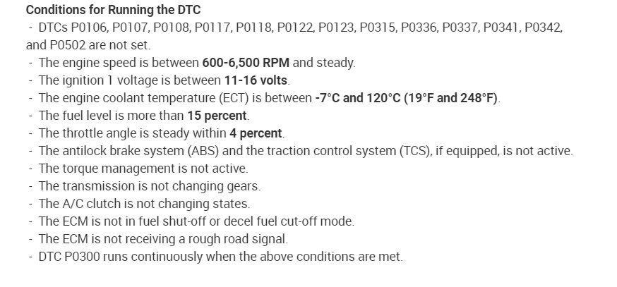

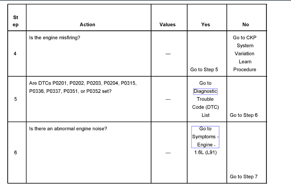

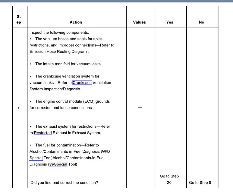

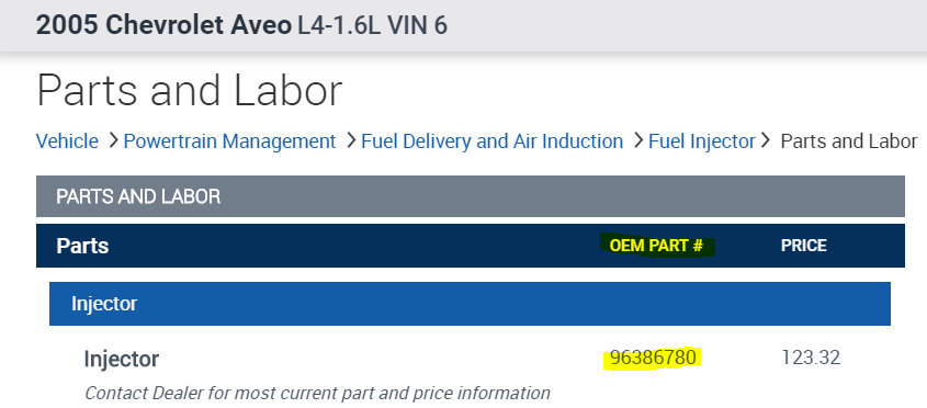

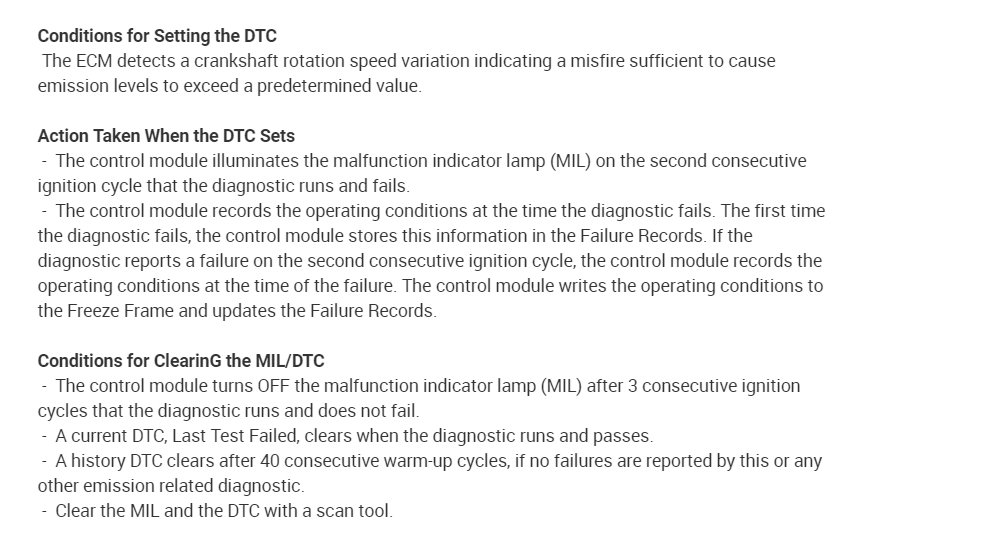

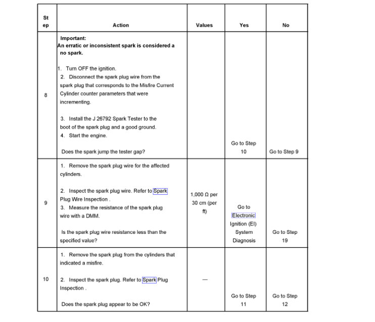

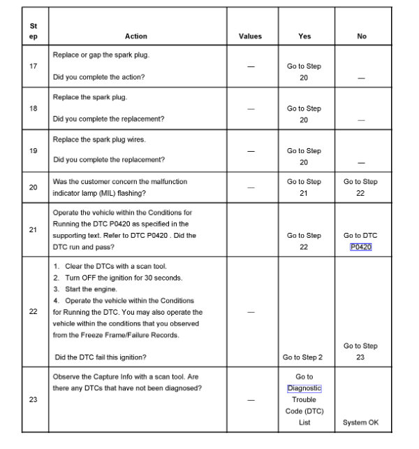

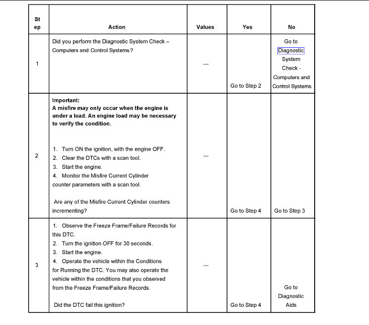

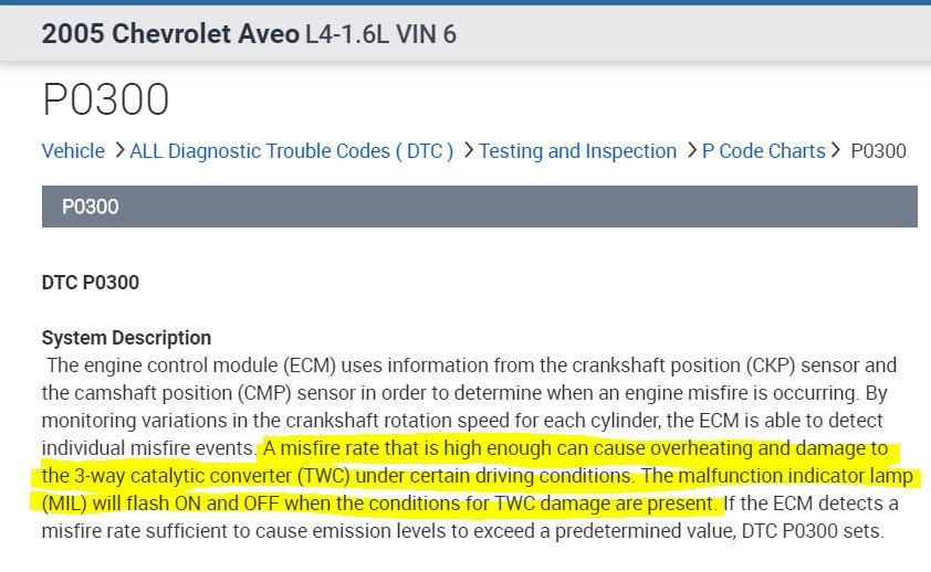

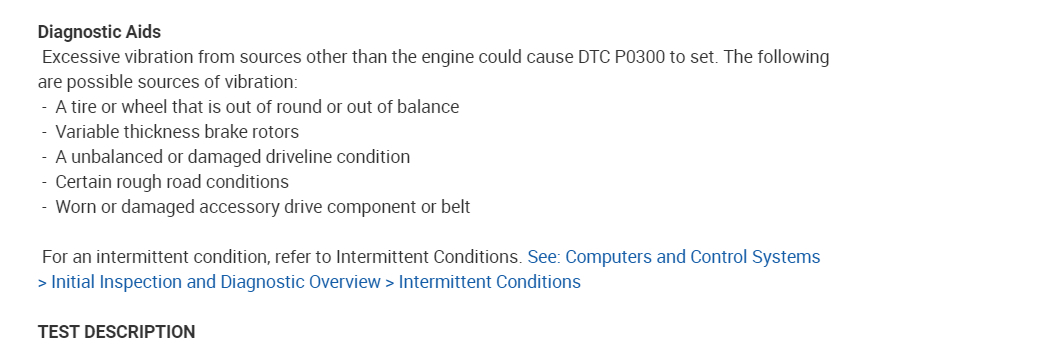

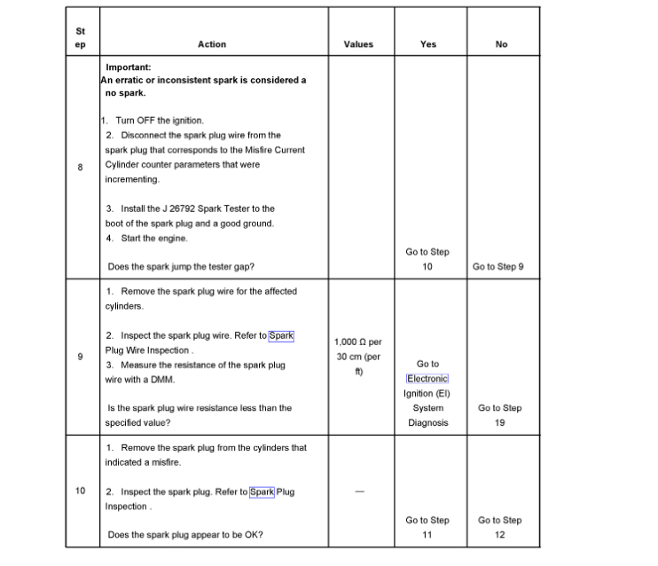

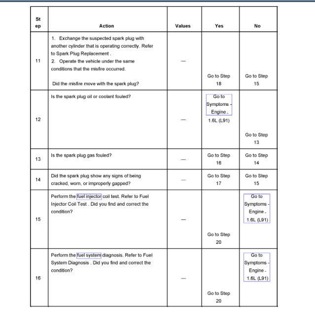

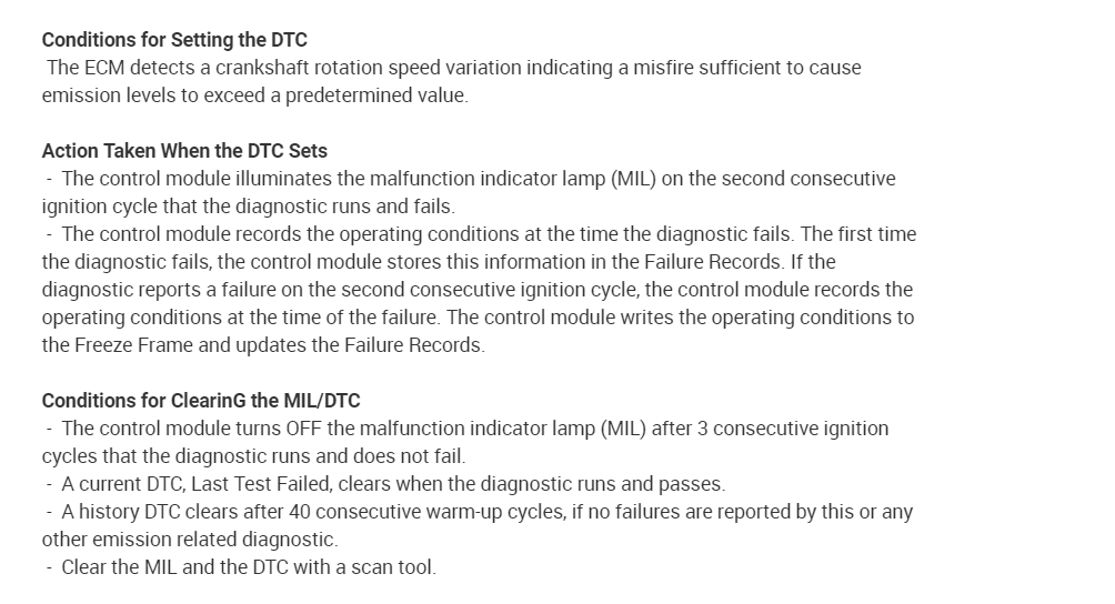

Direct Trouble Code (DTC) P0300 is the DTC for a Random/Multiple Misfire. In the diagrams down below I have included the factory diagnostic troubleshooting guide for DTC P0300. I have also included the fuel pressure so you can check that as well. Another thing to consider, believe it or not, is the Engine Coolant Temperature Sensor (ECT), as this will effect the engine ignition timing, retarding it as the temperature goes up to keep the engine away from detonation. Also inspect the intake air duct, vacuum and EVAP lines for leaks, and especially around the intake manifold for vacuum leaks. This will also make your vehicle run bad. Also double check that the correct fuel injectors were installed. Please go through the guide and get back to us with what you able to find out.
Thanks,
Alex
2CarPros
