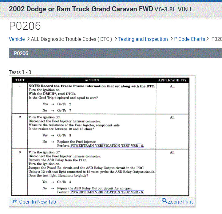

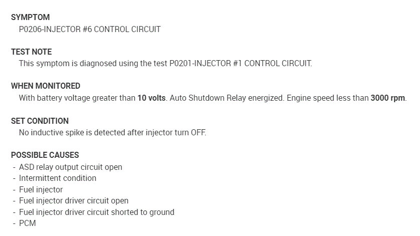

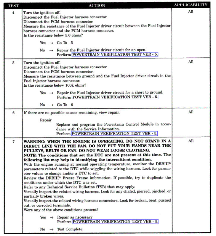

Now, I attached the diagnostics below for the P0206 code. Take a look through them and let me know if you are comfortable doing it.
Also, if you don't have a meter to test resistance, switch the number 6 injector with one from another cylinder and see if the code changes to the new cylinder.
Take a look at the diagnostics and let me know.
