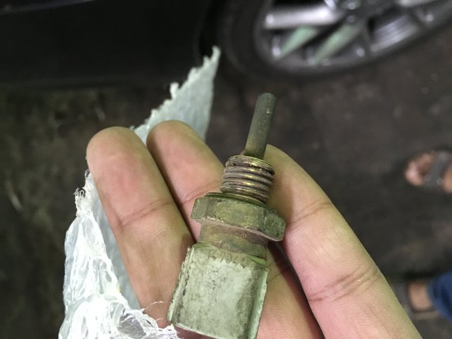

in my max 2010 check engine appear
code is P0197 engine oil temperature sensor circuit
I found the sensor on lower right near oil filter.
I cleaned the harness but nothing now
please need help ASAP

did you replace the sensor??? the issue is usually the sensor itself

i replaced the sensor
the EOT sensor i got from the dealer is the one installed on the upper thermostat
that is also coolant sensor ??

no the eot sensor is at the bottom by the filter.
the one at the thermostat is the ect or engine coolant sensor.

everyone here told me that is a pressure switch. same which is near the crank pulley.
Jan 4, 2016 at 4:05 AM
it is a sensor which does both jobs
