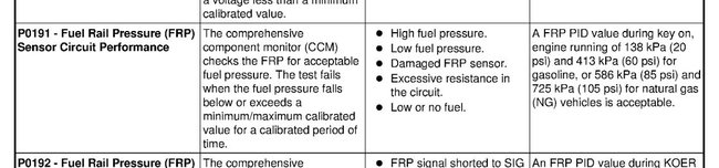

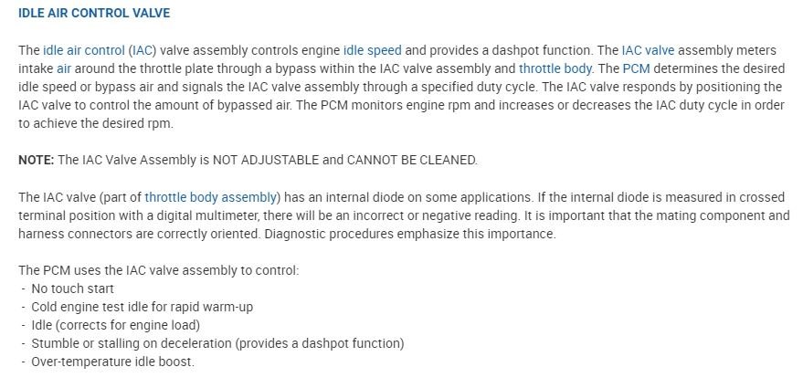

You may have 2 issues. The stalling could be the throttle body which contains the idle air control.

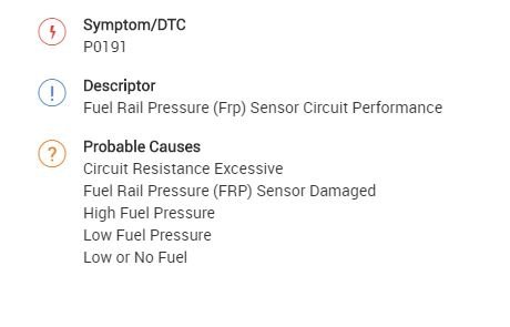

The 191 is for the fuel pressure sensor. Were the voltages checked from the sensor to the ECM? When they checked the pressure was it running?

Then they missed something.

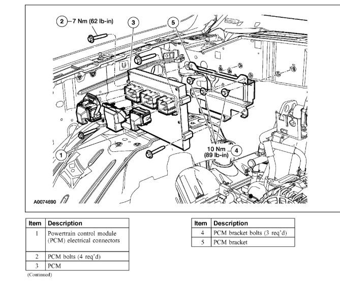

If it is not the pressure, and I asked about it when they checked it, and the sensor is new, it leaves wiring or ECM. The ECM is not common at all for this failure.

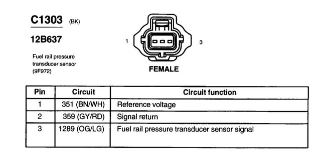

There should be a 5-volt reference voltage and a 5-volt signal. You only have 1 of 2.

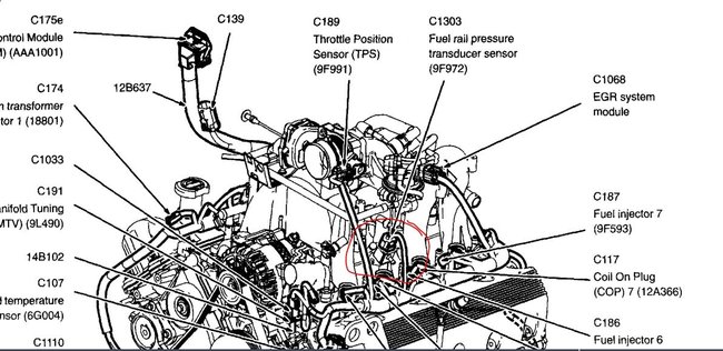

I attached the connector diagram.
The signal and reference need the 5 volts.

Good morning. i did the voltage checks and i am getting 5V Ref and 5V signal.
Mar 8, 2020 at 1:07 AM
Okay, then it points right at the sensor. You may either have a bad sensor or a bad ECM.
