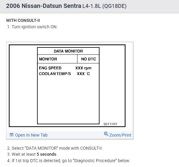

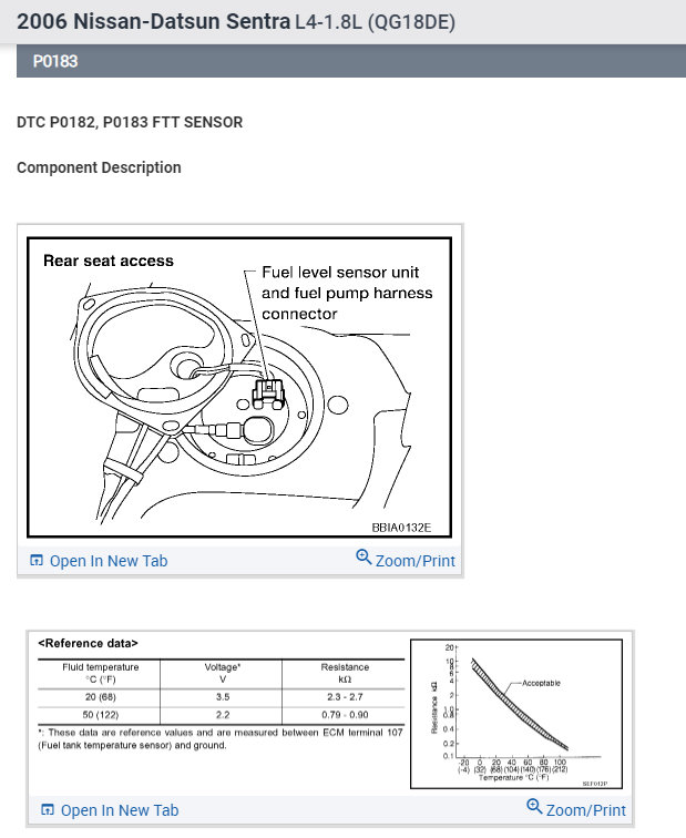

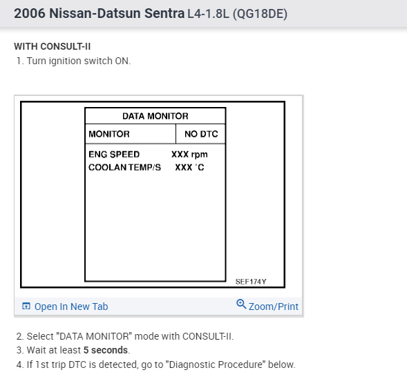

Hey guys, i got this code on the car listed above. The car runs fine for a while then starts to stall with almost no power. one other code is p0850
(park/neutral switch input circuit) is the only other code. anyhow, i was wondering what and where this sensor is located for the fuel sensor so maybe i can diagnose or replace it. i appreciate your assistance in advance.

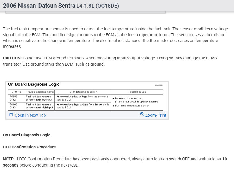

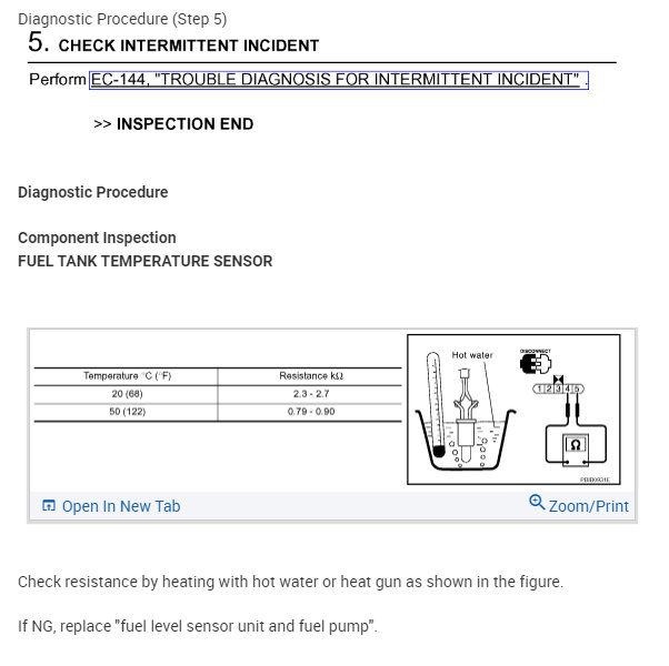

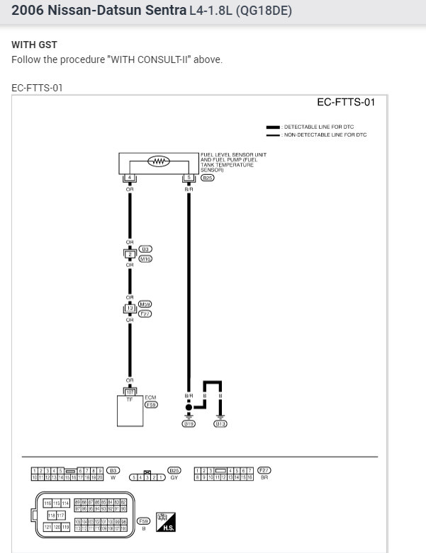

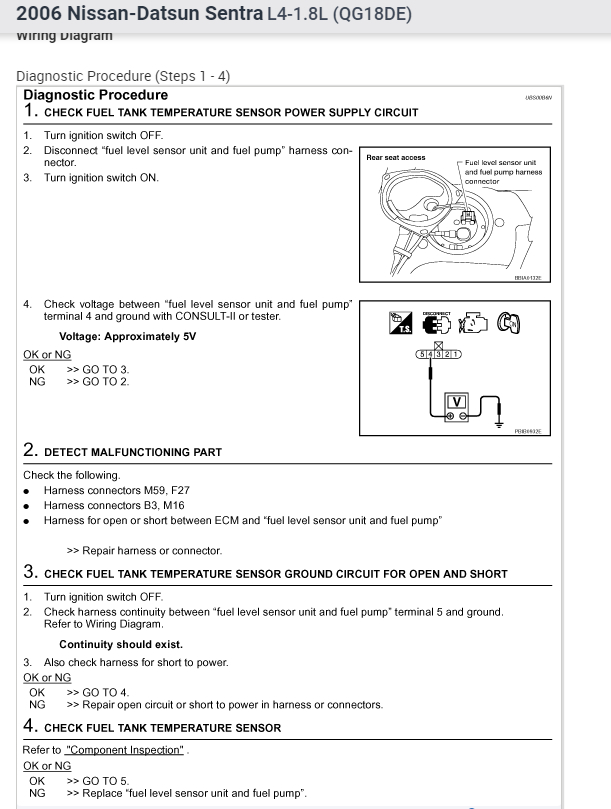

The fuel temperature sensor is a part of the fuel pump sending unit located in the fuel tank.
The code P0183 can get triggered due to wiring issue as well as a faulty sensor.
I have attached the troubleshooting guide for the code P0183 below for your reference. Follow these steps and it can help you determine the issue.
Let me know of any questions.

Thank you for this information. I will go through all this and will update as soon as I figure out the source.
